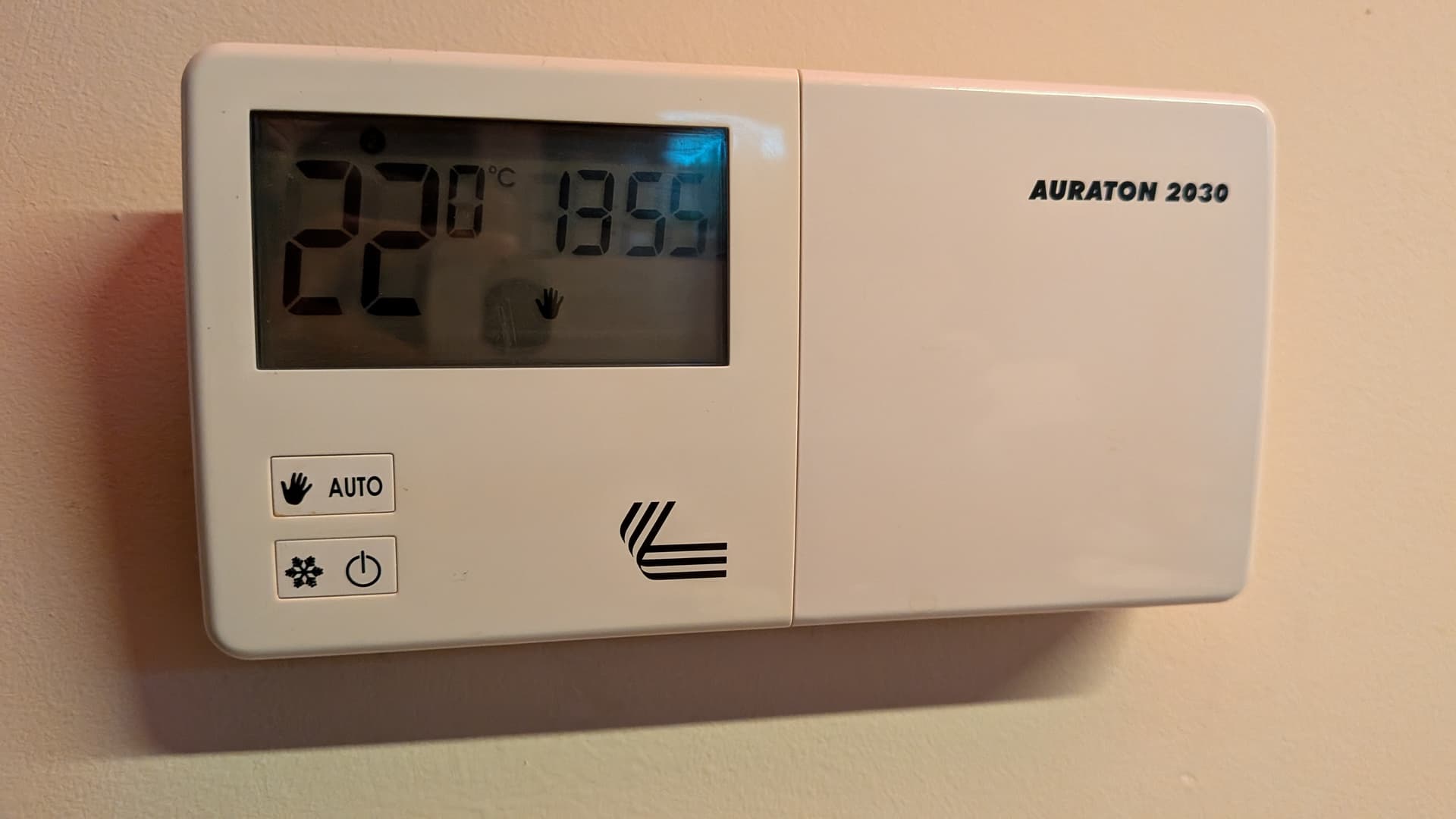

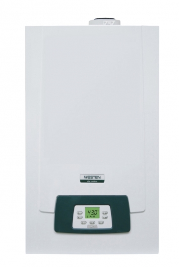

I have a gas boiler (Westen Star Condens) controlled by a thermostat (Auraton 2030). I would like to replace this thermostat with an Aqara W500 thermostat. Is this possible, has anyone done a similar development?

No, it cannot be replaced. The W500 does not have dry contacts.
Hello, I confirm that the W500 does not have dry contacts, unless you take an additional intermediate relay for 220 volts.
