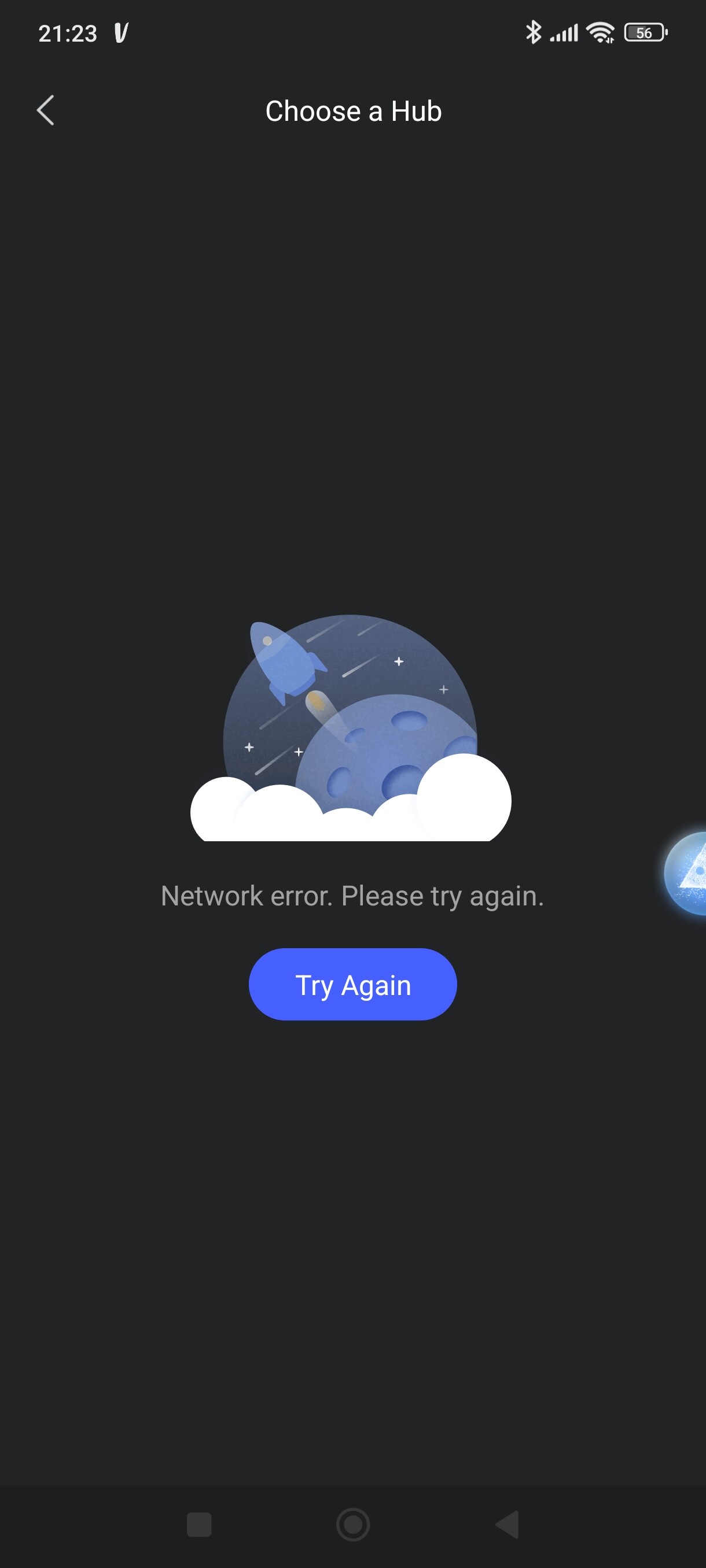

I am the happy owner of a W600. Since I received it, I have been unable to connect via Zigbee. Can you give me some advice?
Hello, what gateway do you have?
Aqara M3, android telephone.
Remove W600 from the app. Reinstall and select Zigbee on the first splash screen. The transition will take some time, then everything is standard.
