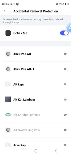

Hello, enable the “delete prevention” function, this option is in the gateway settings.
I also recommend contacting support, they will do a detailed analysis.

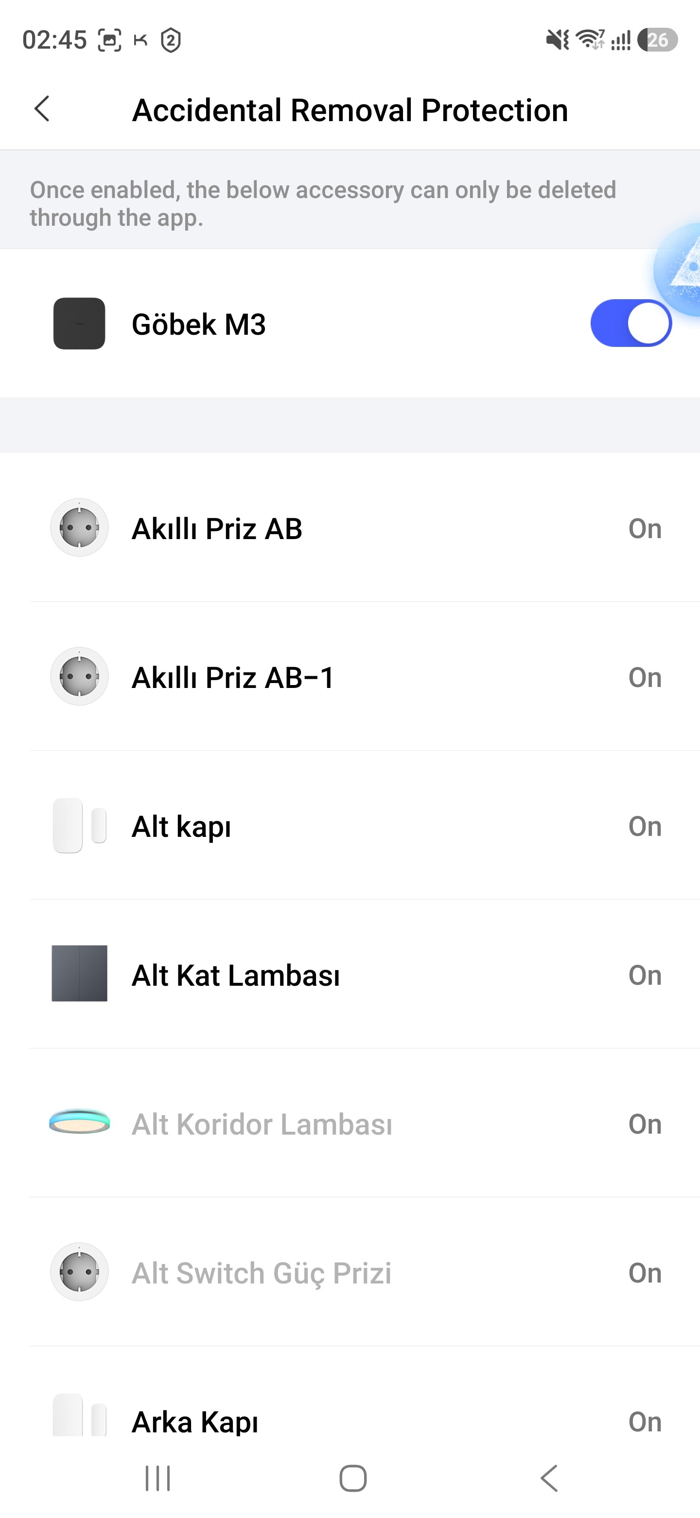

Thank you for your interest. I believe the menu you mentioned is the one shown in the attached image. Although I had already enabled this option before, I still experienced the issue.
Regards
Then only support can help you.
