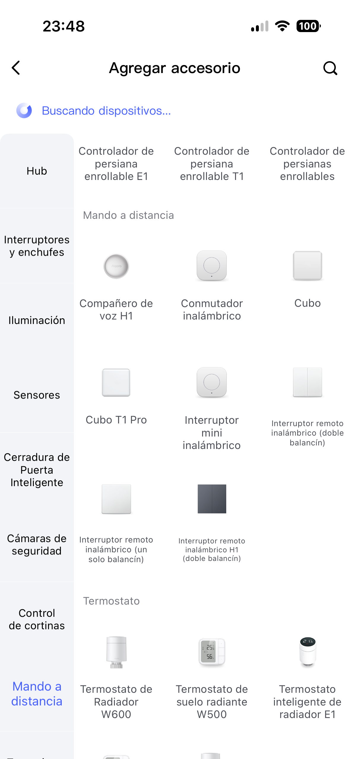

Hi there.welcome to the forum.normally this wireless buttons works on any server so that can’t be the issue.my question is what exactly shows when you pair the button with your hub?my be you didn’t chose the right one as on aqara app there are 2 type make sure you chose the right one also check if the LED is blinking too as the steeps ask when you pair it

Aqara app doesn’t discover the child devices by its own you need to manually select the button from the list I show you and follow the steps that aqara app shows there.
This buttons they are not locked to an specific server as I have 1 from AliExpress and works perfectly on Spain server.something he doesn’t do well when pairing the button if he said that the light is blinking my be he expects that aqara app detect it automatically but child devices doesn’t work like that.
