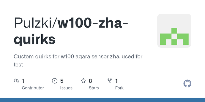

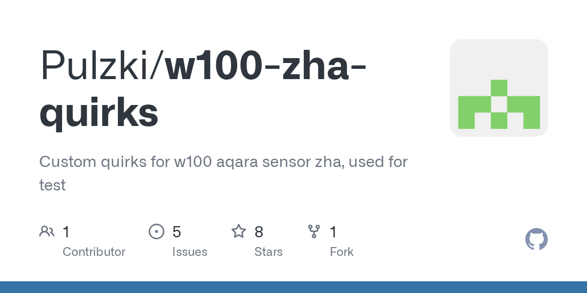

Thanks for help. It is switched now and i have found this quirk for ZHA in HA. Testing it.
