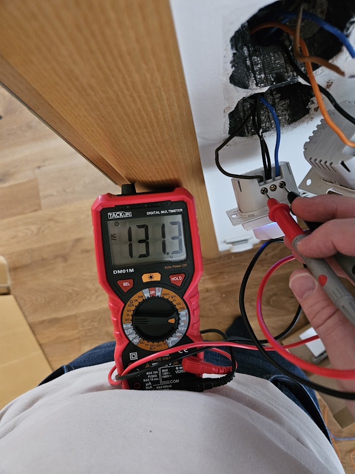

I have installed 3 Aquara Dimmer Switch H2 EU and have issues with all of them:
  1. First one just provides 131 V~ on the output even on 100% setting. Just not working at all…

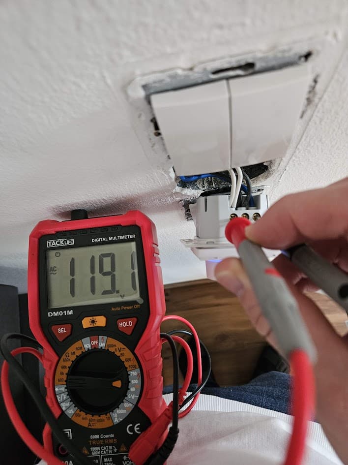

  2. one starts flickering after some time on any percentage level. I measured it with 100% while flickering and the voltage dropped to 119V~. When i turn it off an on it has again for some time correct full voltage of around 228V~. Same for any other percentage level. First working fine after some time flickering starts

Not surprised by your readings. Aqara dimmer switch is not a voltage dimmer, it’s a MOSFET dimmer, which means it just cuts the wave with a frequency depending on the dimming. Your meter probably shows garbage, because it expects a sine (if you measure your 230V anywhere else, it will actually have occasional jumps even to 240V, which will show on an oscilloscope, but your meter averages the sine and shows 230V).

I know it is a phase cut dimmer that’s why I measured at 100% where no cutting should happen and it should reach around 230V~.
For second one the Flickering happens at any % after random times. I see clearly that at the time of flickering that the voltage dropped for some reason and is back correct when I switch it on and off to 100% again.

For second one: The flickering starts for example after 45 Minutes. The Voltage was fine for this 45 Minutes when ever I measured it but then suddenly dropped ( still at 100% setting) and then stays there and the LEDs flicker until I turn the dimmer off and then on.

I have also measured the voltage between L and L’ at 100% and when there is no flickering it reports around 0-5V~ as somehow expected. But when I see it flickering then there is a voltage of 124V~ measured. So the drop is caused by the Aquara Dimmer between L and L’.
The voltage drop on the dimmer looks ok, it needs to draw power because there’s an electronic circuit running continuously. For the same reason, a dimmer without neutral will still let some current through while OFF, and more sensitive lights will be dimly lit.
But the flickering and dimmer malfunction (with N) is still quite suspicious, my only guess is that something in the electrical installation (on the same breaker) is messing with the N, which makes the dimmer malfunction.
