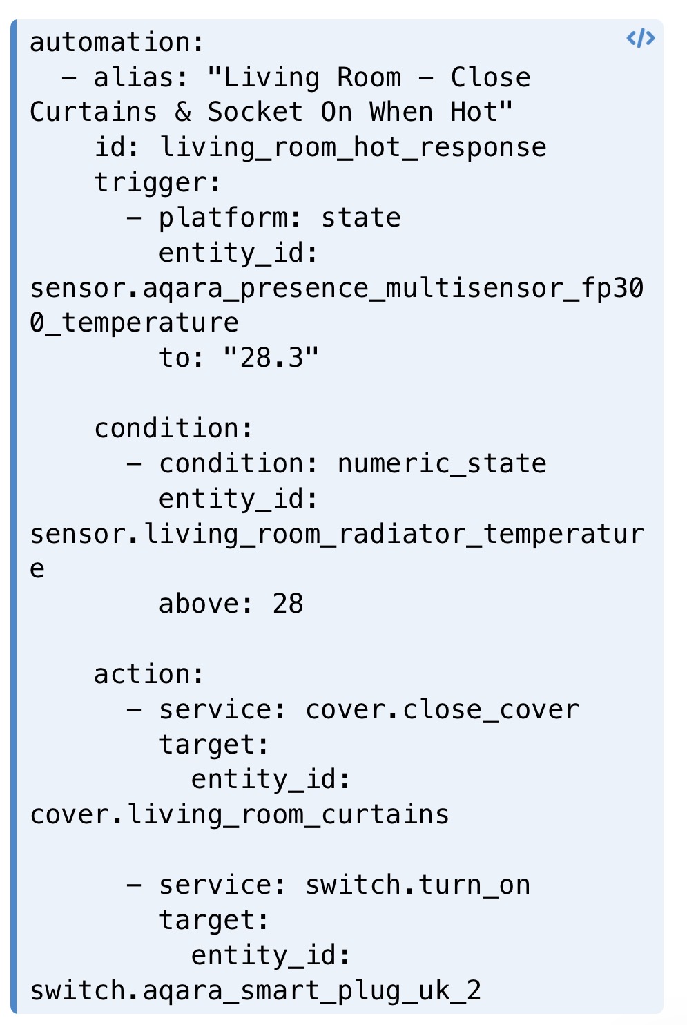

It all starts with the FP300. Not just a presence sensor, but a light and temperature one as well. If the room gets too bright, or the temperature gets too warm, it knows about it. Perfect for what we need.
In Home Assistant, I take the data from the FP300 as a trigger, and have it validate the room temperature against other sensors in the room (you never know, I might be using a hairdryer stood in the corner of the room for some reason). In this case, we’re using the Aqara E1 TRV.
Great, it’s definitely warm in here if both are reading above the set temperature. Now the house jumps into action. First, we have the Aqara E1 curtain drivers close the curtains to block out the heat and keep the room from getting any warmer. Next, the H2 Wall Socket flicks on the connected fan, to get the room circulating! Hopefully things cool down before the Panama match on Saturday!
Here’s the code I use to trigger this automation in Home Assistant, you just need to update the names to your devices.
