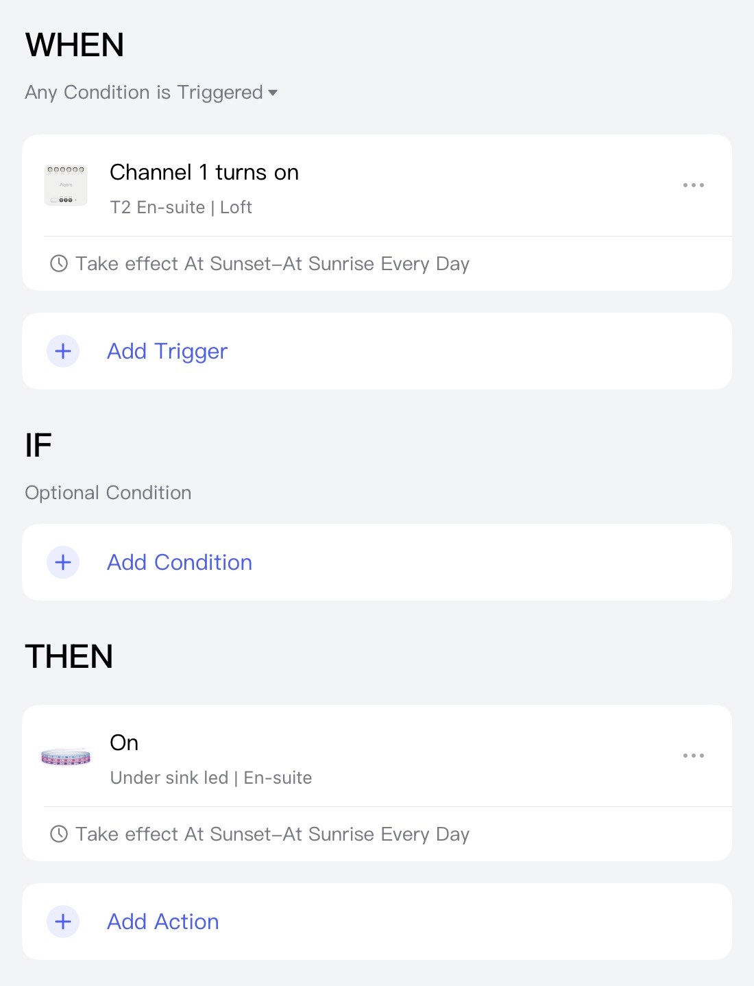

When old style PIR senses movement it puts power to an Aqara T2 Relay. Automation then says When T2 Turns On, Then AQARA T1 LED Strip = On.
When old style PIR no longer senses movement it stops power to Aqara T2 Relay. Automation then says When T2 Turns Off, Then AQARA T1 LED Strip = Off.
Currently I have 4 (yes 4!) automations to run this as I only want it activated between Sunset and Sunrise. 1 to turn on the PIR On automation at Sunset, 1 for PIR to turn on the T1 LED, 1 to turn off the T1 LED and 1 to turn off the PIR On automation at Sunset. The PIR Off automation can run all the time as it makes no difference.
I believe in Automation 2.0, I can reduce this down to 2 Automations?
New 2.0 Setup / Questions

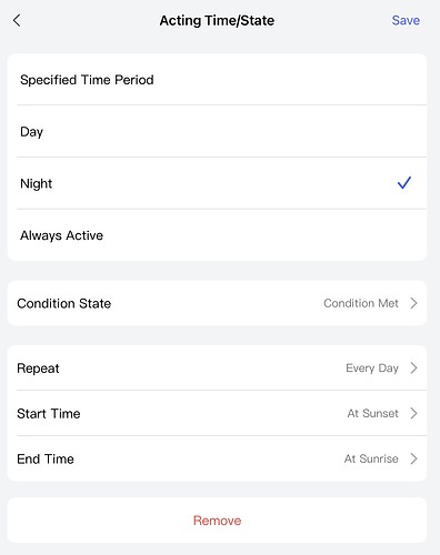

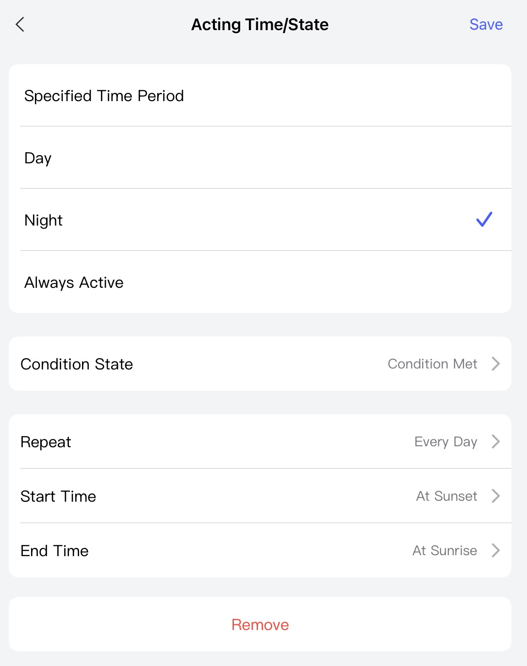

So, I’ve added the screenshots of the converted Automation to 2.0, but should the Acting Time be setup in the When or Then?
Currently I’ve set this up in both as an example.
Thanks

If you want your automation to only trigger during a certain time (e.g., between sunset and sunrise), you should set the Acting Time in the WHEN block.
That way, the automation will only fire during that time window.
Outside of it, it won’t trigger at all.
When to use Acting Time in THEN
Only useful if you want different actions depending on the time.
For example:
If motion detected → if day, set LED white; if night, set LED warm white.
