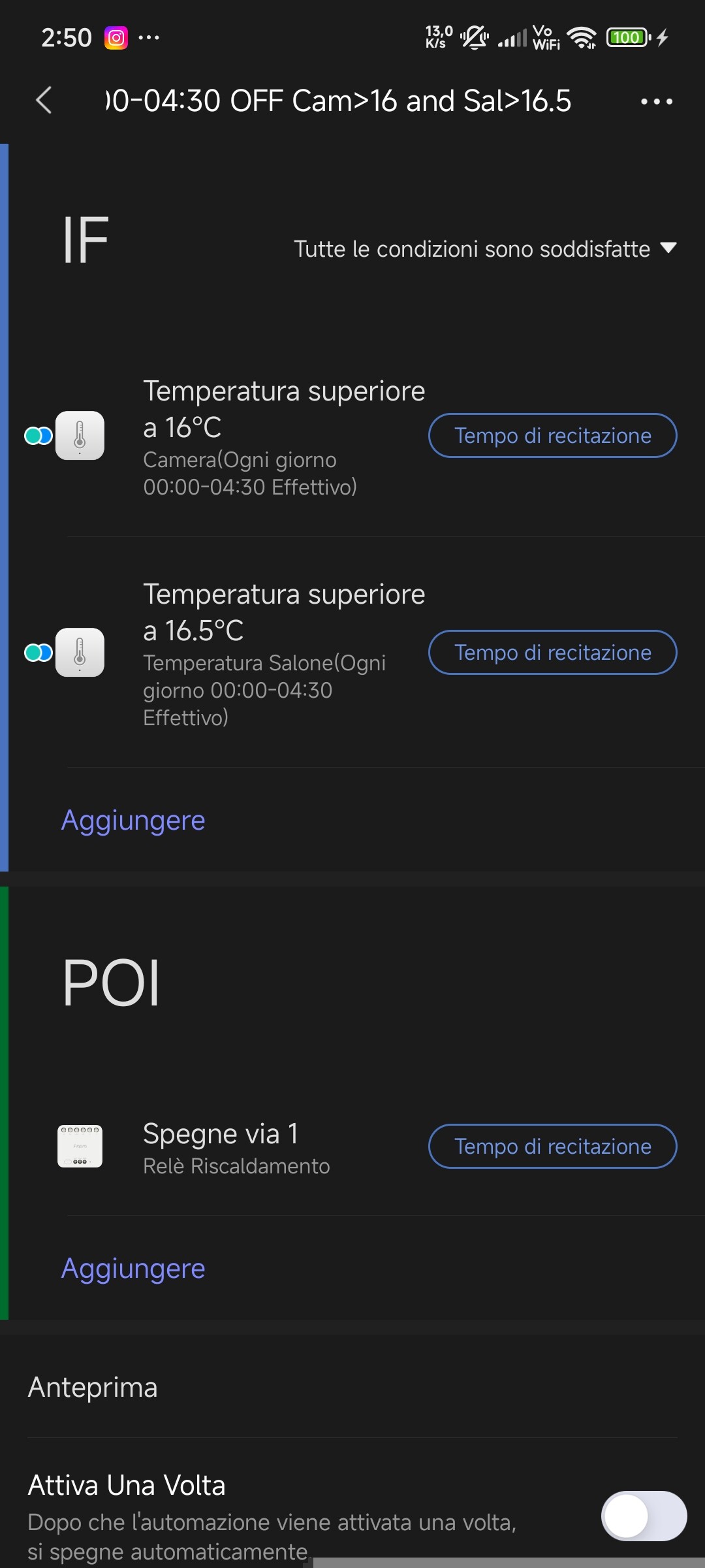

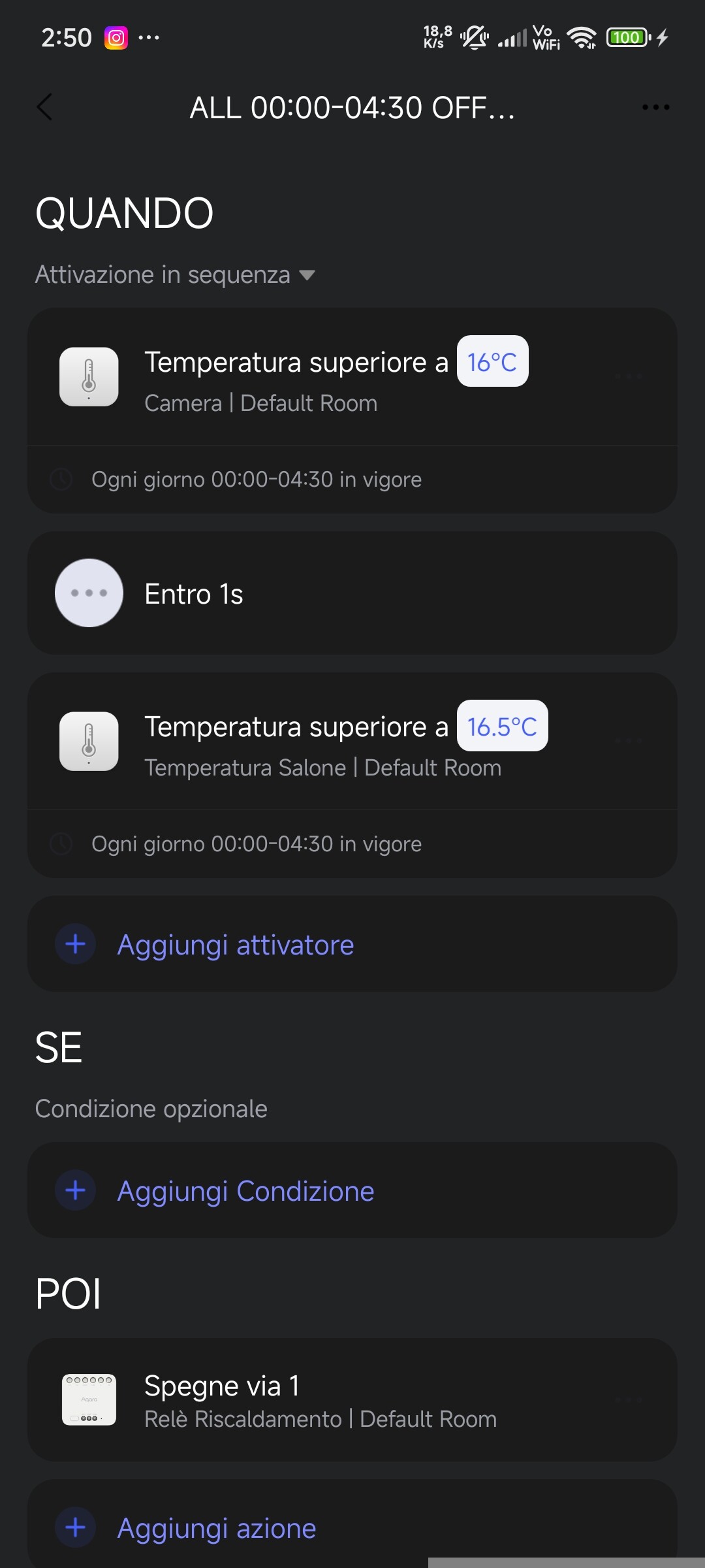

Good morning, I’m having a problem with my automation system for turning off the relay I use for heating.

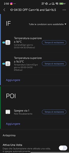

When switching to Automation 2.0, I had to set the automation you see in the photo to have the two values ​​from the two temperature sensors as the IF (I had to set a 1-second delay), but Automation 2.0 doesn’t work. I created a 1.0 automation as shown in the photo, and it works fine. I’ve opened several support tickets. They always tell me to enable access to the system logs (which I can’t find anymore), and they reply that I can’t find the option. I haven’t received a response from support. Can you help me resolve the automation issue, including the logs? Thanks.

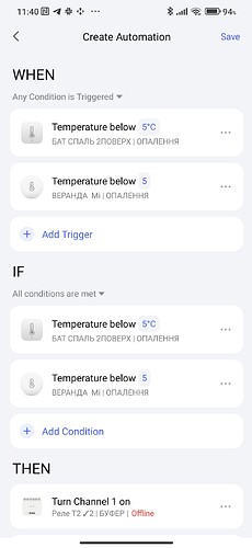

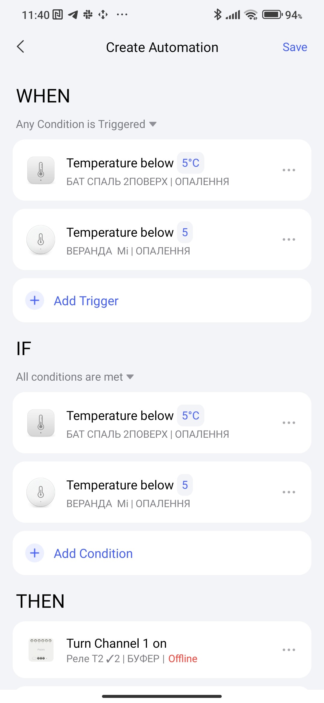

Hi, unfortunately 2.0 currently has some issues with the WHEN section. Your automation needs to duplicate conditions to be executed. It looks something like this.

Let’s revisit the example: we want to turn on a climate-control device when Sensor 1 is above 16°C and Sensor 2 is above 16.5°C. In Automation 2.0, the configuration logic is:
Step 1:
Use a transient condition as the trigger under WHEN.
For example, “Sensor 1 rises to 16°C” or “Sensor 2 rises to 16.5°C.”
When either transient occurs, the system proceeds to evaluate IF (and will execute immediately if IF is empty).
Step 2:
Use stateful conditions under IF:
“Sensor 1 is above 16°C” and “Sensor 2 is above 16.5°C.”
As you can see, if two conditions must be satisfied simultaneously, they are configured inside IF.
Step 3:
Configure the execution actions.
This completes the full “Trigger → Evaluate → Execute” automation chain.
How IF-THEN (Automation 1.0) Works
Once you understand Automation 2.0, Automation 1.0 becomes easy to interpret.
In fact, behind the scenes, Automation 1.0 also follows the same WHEN-IF-THEN model.
The difference is that WHEN and IF are bundled together and simplified into a single IF during configuration.
During execution, the system internally expands IF back into the step 1 and step 2 logic described above.

For clarity, you can use “…” in any section, it’s just that in the THEN section you can write it once, but in the WHET section you have to write it twice, for each parameter.
