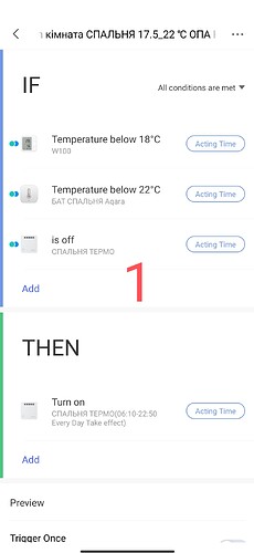

Fig. 1 (1.0)

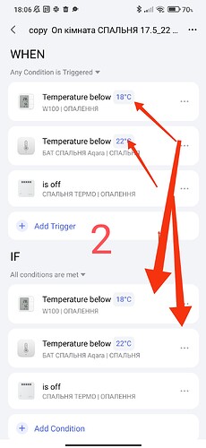

If we transfer to automation 2.0, we get a variant in which all conditions in WHEN and IF are duplicated. To set the control temperature, you need to change the parameters in WHEN and IF, which is very inconvenient for the user (decreases efficiency, random error when replacing one parameter).
Fig. 2.

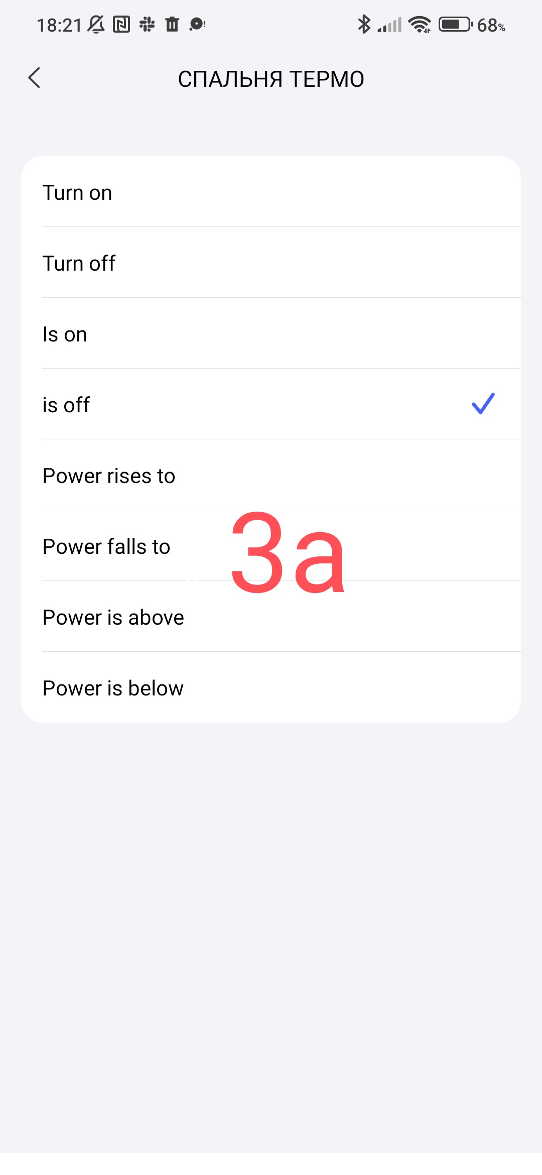

I draw your attention to the fact that the relay state in the WHEN parameters is selected in the mode ( (°°) constant control mode, Fig. 3a).

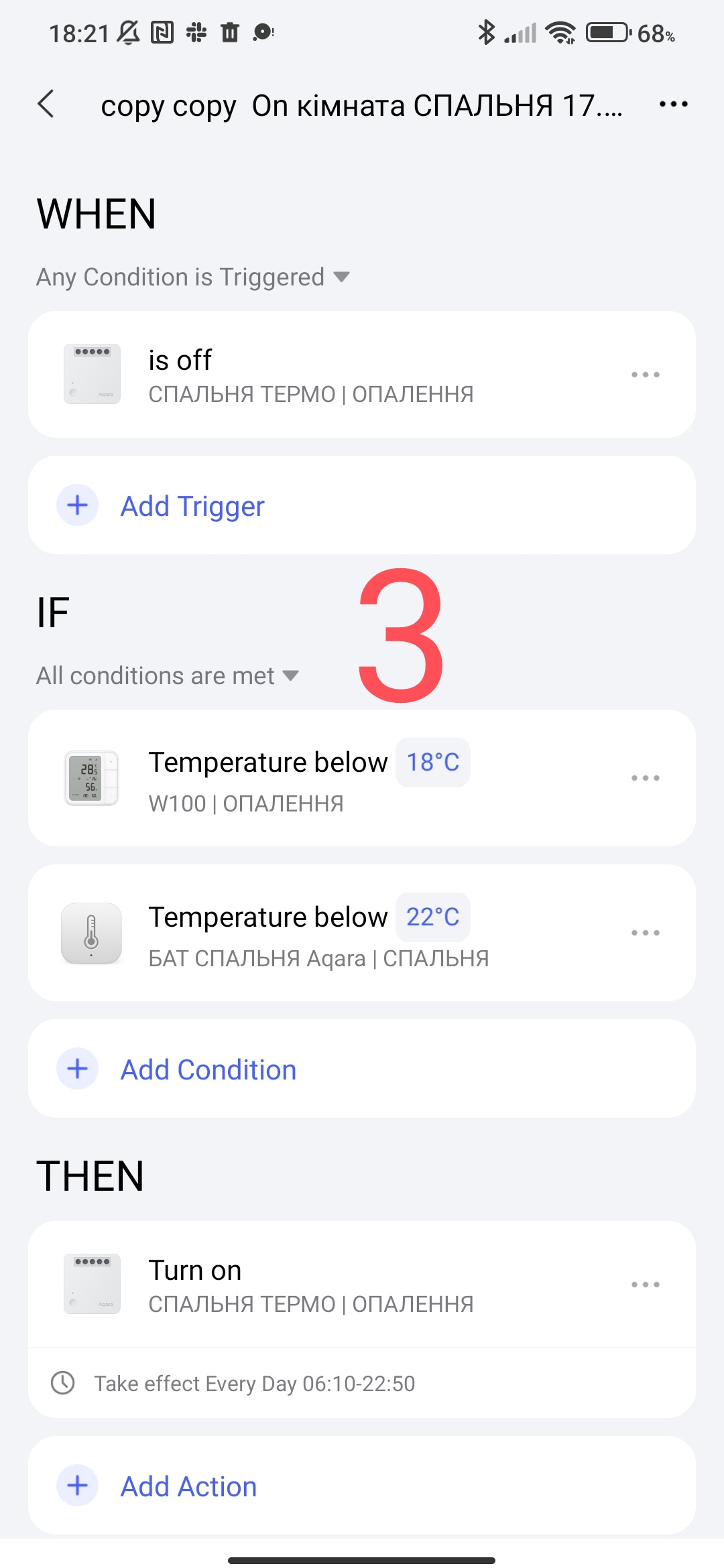

If I rework the automation in this form
Fig. 3
I get a simplified automation with a temperature variable in one sector, IF. The disadvantage of this version of automation (Fig. 3) is that it does not work in constant mode. If the relay is off and the parameters in the IF part at some point in time will satisfy the automation conditions, the automation in Fig. 3 WILL NOT WORK (will not turn on the relay).
The automation will turn on only when I make the On->Off relay manually, although in the relay parameters WHEN (°°) Fig. 3a.
My proposal for improvement 2.0.
When any change of state occurs in IF conditions, it is necessary for the automation algorithm to trigger a polling signal with the following sequence:
1- polling signal in the WHEN part for correspondence of ready triggers with (°°) (all triggers with (°) are ignored);
2- in the case of a ready trigger with (°°) in WHEN, polling continues in the IF area.
3- if all conditions are met, we start the automation.

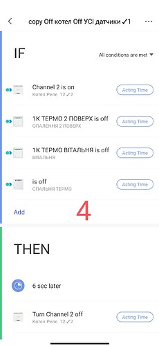

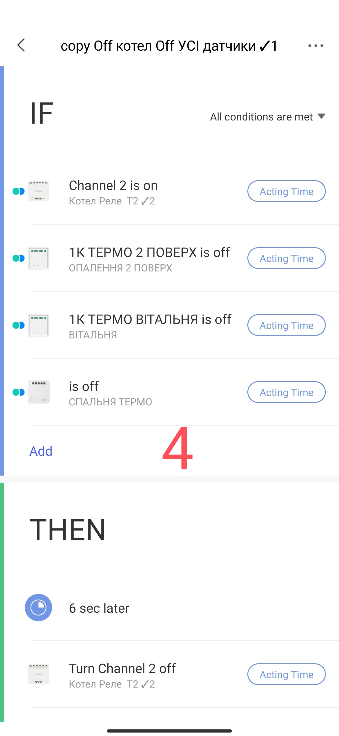

I give another example with control of a relay group (heating control). The same automation. The boiler relay will not operate when all auxiliary relays change state to off.
Automation 1.0
Fig. 4.

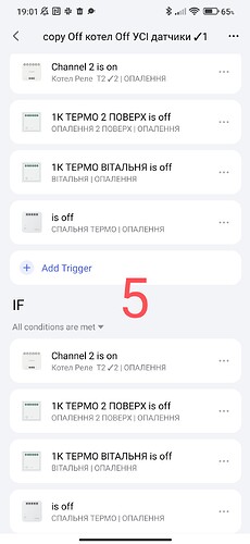

Automation 2.0 is automatically translated, very large and loaded with duplicated conditions.
Fig. 5

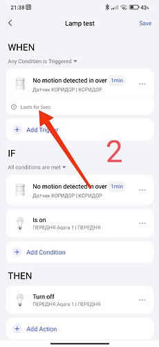

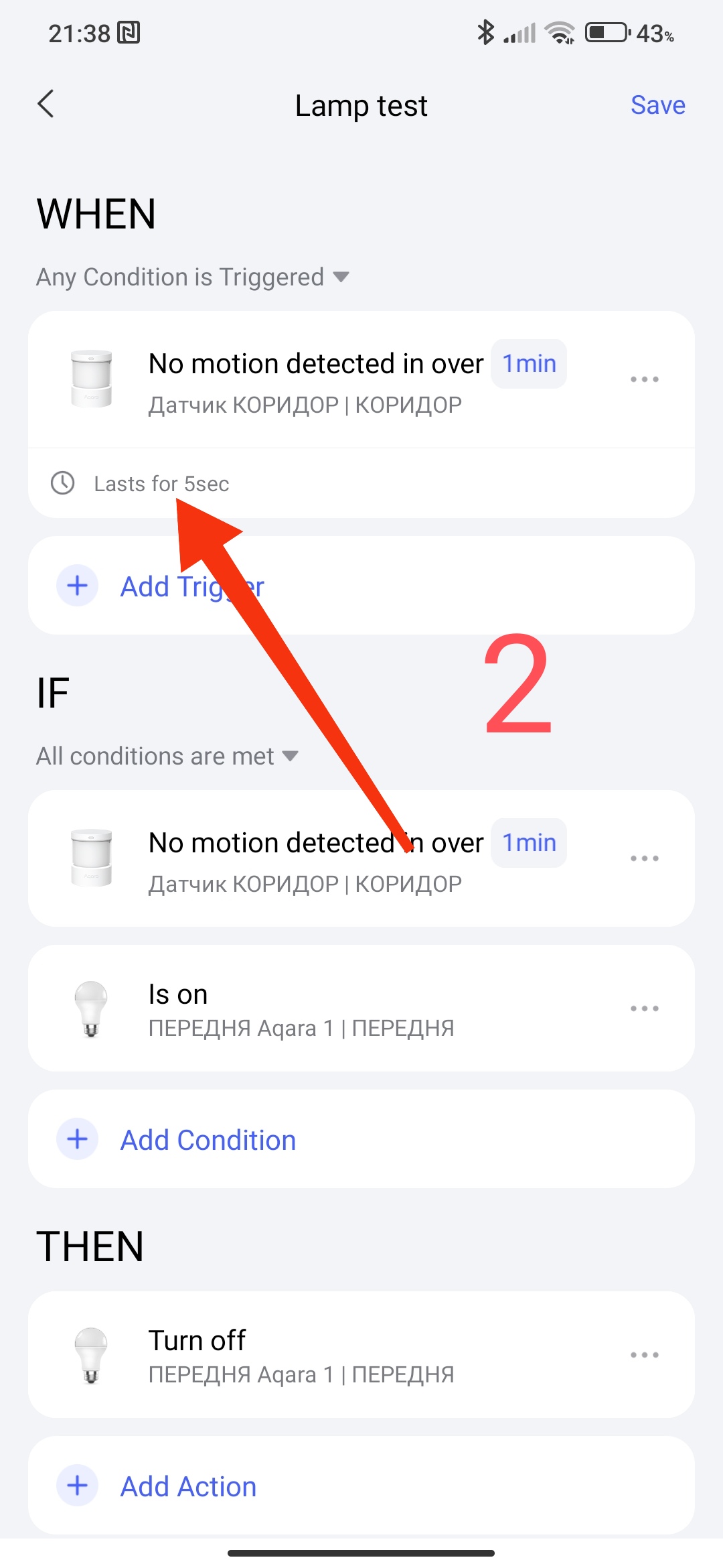

A banal automation in which I want to control the absence of movement in a pair with the lamp on also does not work.
Fig 1
It will work if I set a delay of 5 seconds in WHEN and then everything is ok.
Fig 2.
You fixed this problem with relay control (On, Off) when the same states in WHEN and IF in motion sensors did not do this. I personally checked this problem.

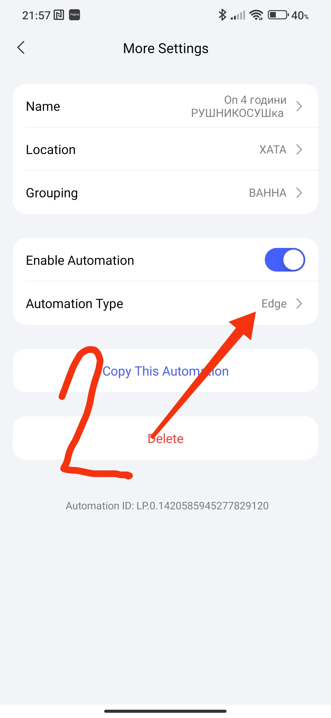

The problem with automation, which theoretically should be cloud-based (using weather servers), in the settings it says that it is local automation. Automation 2.0. Request for explanation of weather conditions

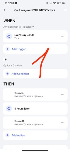

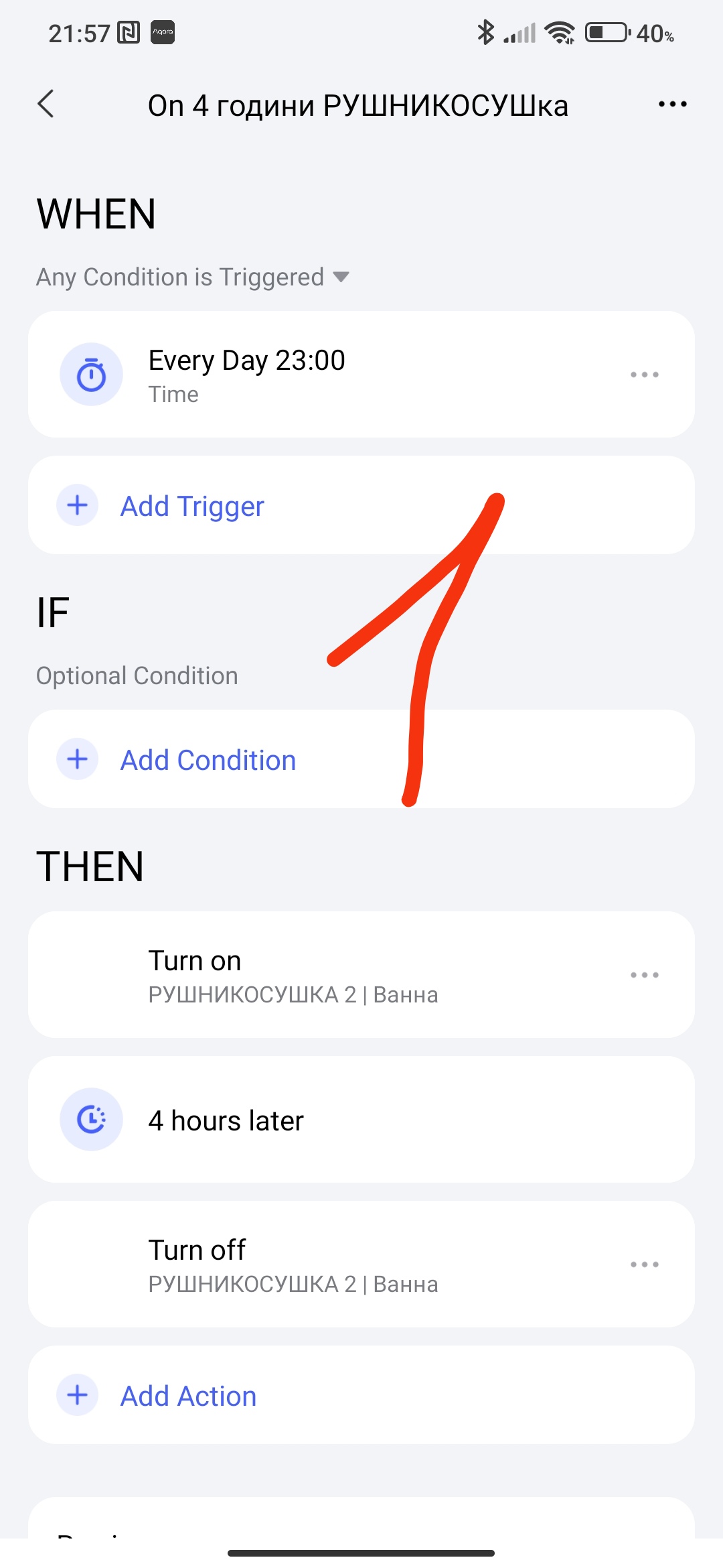

Simple automation using time for one socket, now not local, socket is connected to gateway M2 (there is also gateway M3 in the house). Is this a bug or a new problem of 2.0?
Fig1,2.
