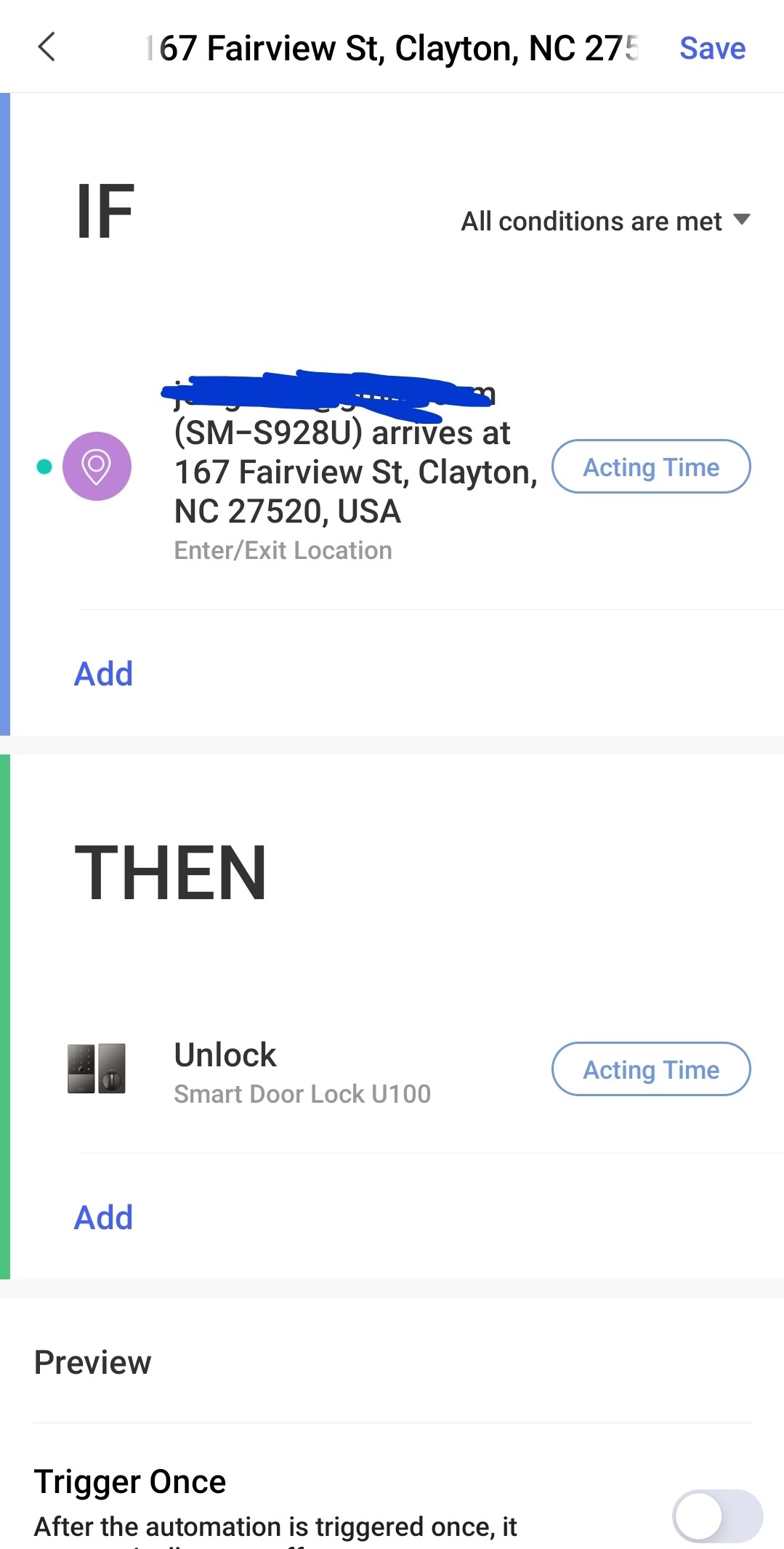

Hello, have you set up door opening using automation? If so, please provide a screenshot of this automation.
Here you go!

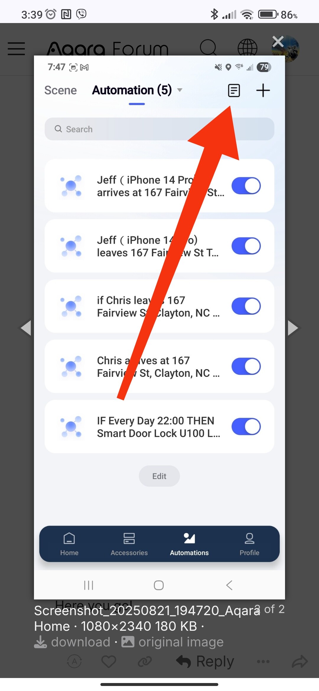

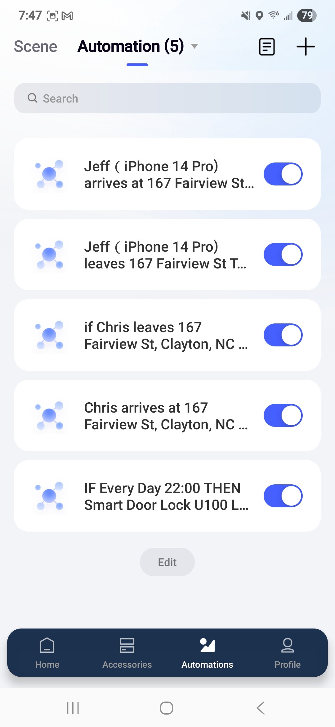

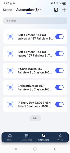

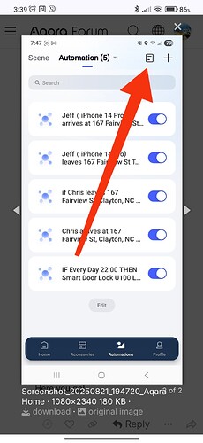

Look here, this is the automation event log. I think the lock is locked due to the activation of another user of yours. You are at home and the other is not, so the lock is locked. See how you can bypass this problem at the moment at my link. Automation for geolocation of two users
ohhhhhhh that makes so much sense, I forgot there were logs. I will take a gander at your guide thanks!
