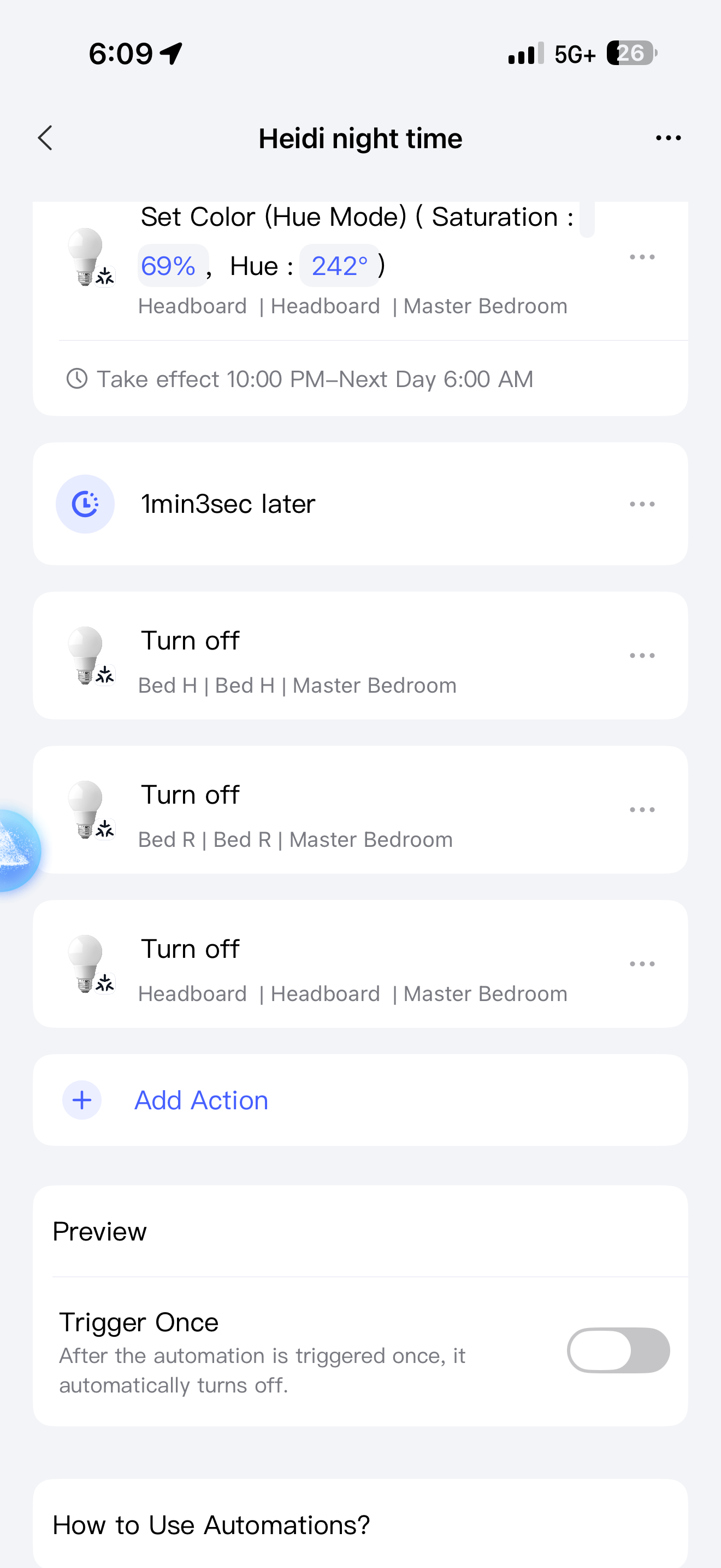

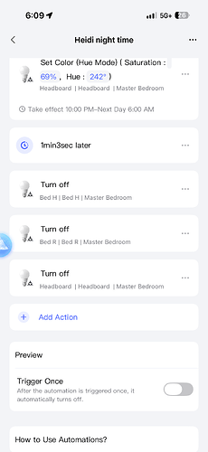

I deleted the original automation but created a new one and now it does work but after the timer they won’t turn off. Very easy set up it was working fine all my other 64 automations work perfectly

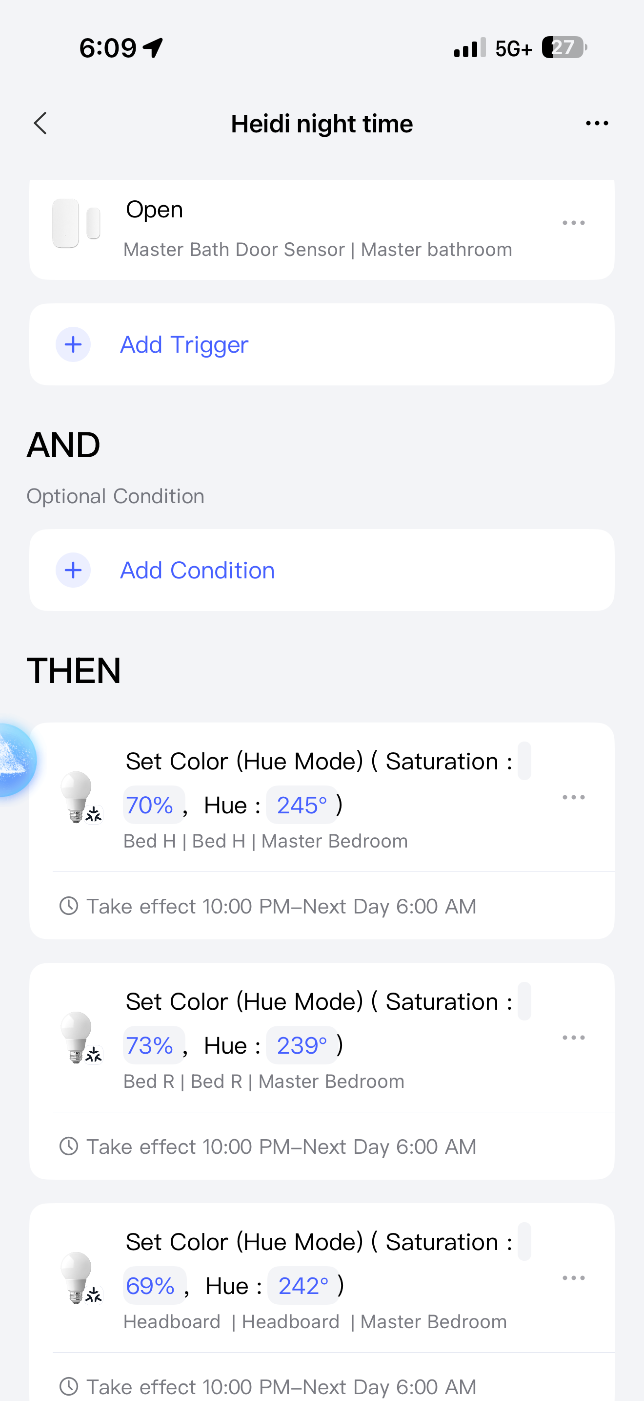

Also check here how the automation will work. Be sure to check between 22.00-06.00

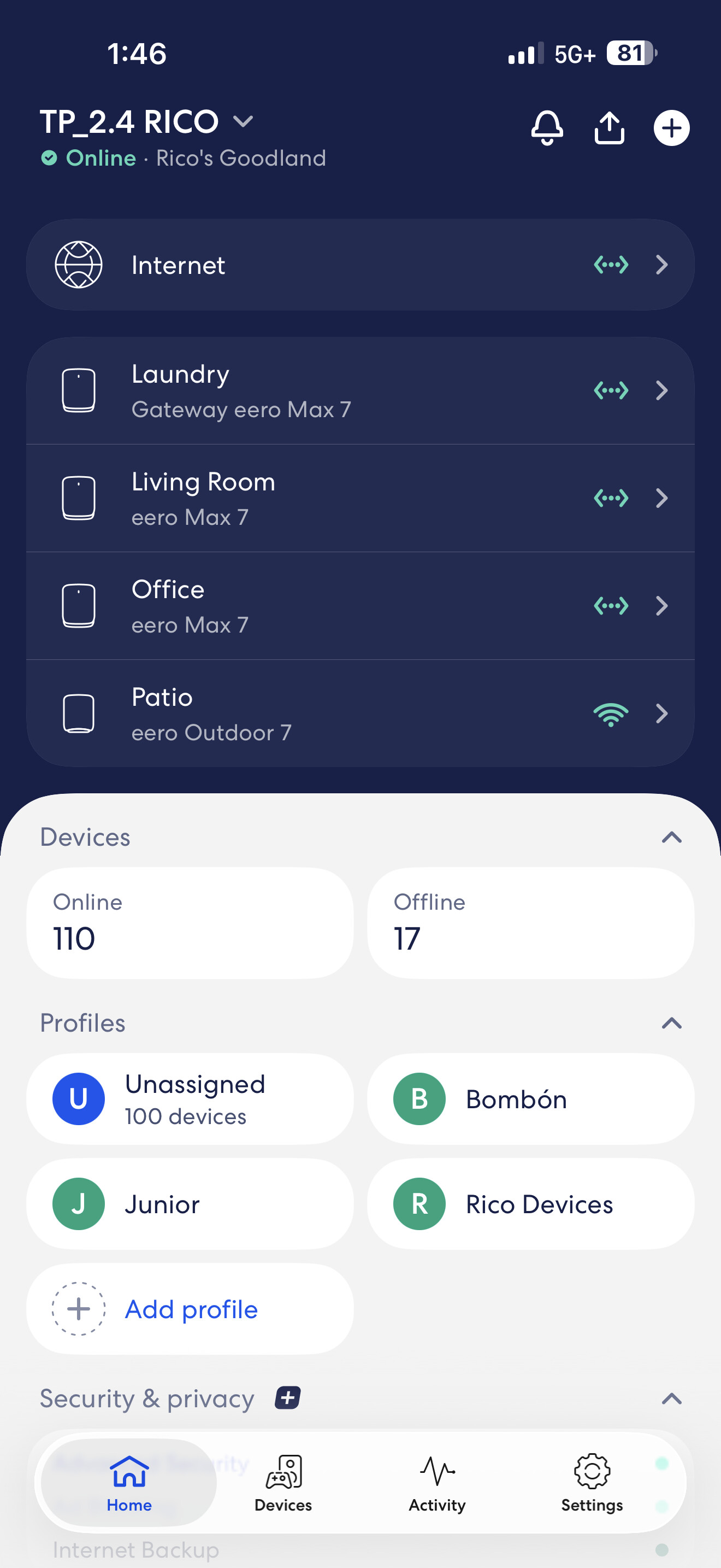

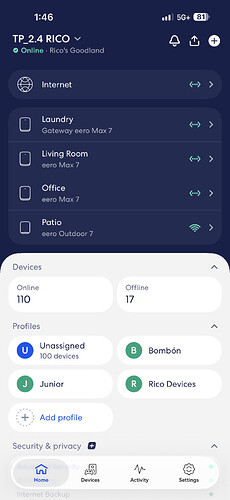

I added more router mesh to my original gateway router which is Eero max 7 I added 2 more so can everything run smoothly and not be congested since I have a lot of devices
I agree and that’s why is weird because all of them worked just this one is acting up it won’t turn off. I also hub multiple hubs through the house 1 M3 and the rest are 4 G3 and outside 2G5 and the door bell hub so I really can’t figure it out why it wouldn’t work
I suspect that you have broken the structure of the connections in the house by adding new networks. You wanted to do it better, but it turned out as usual☺️.

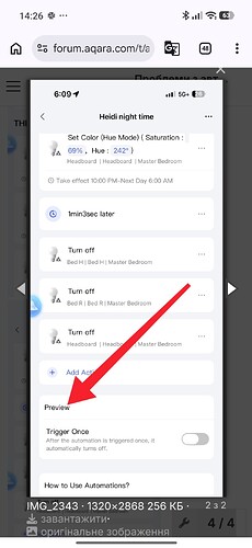

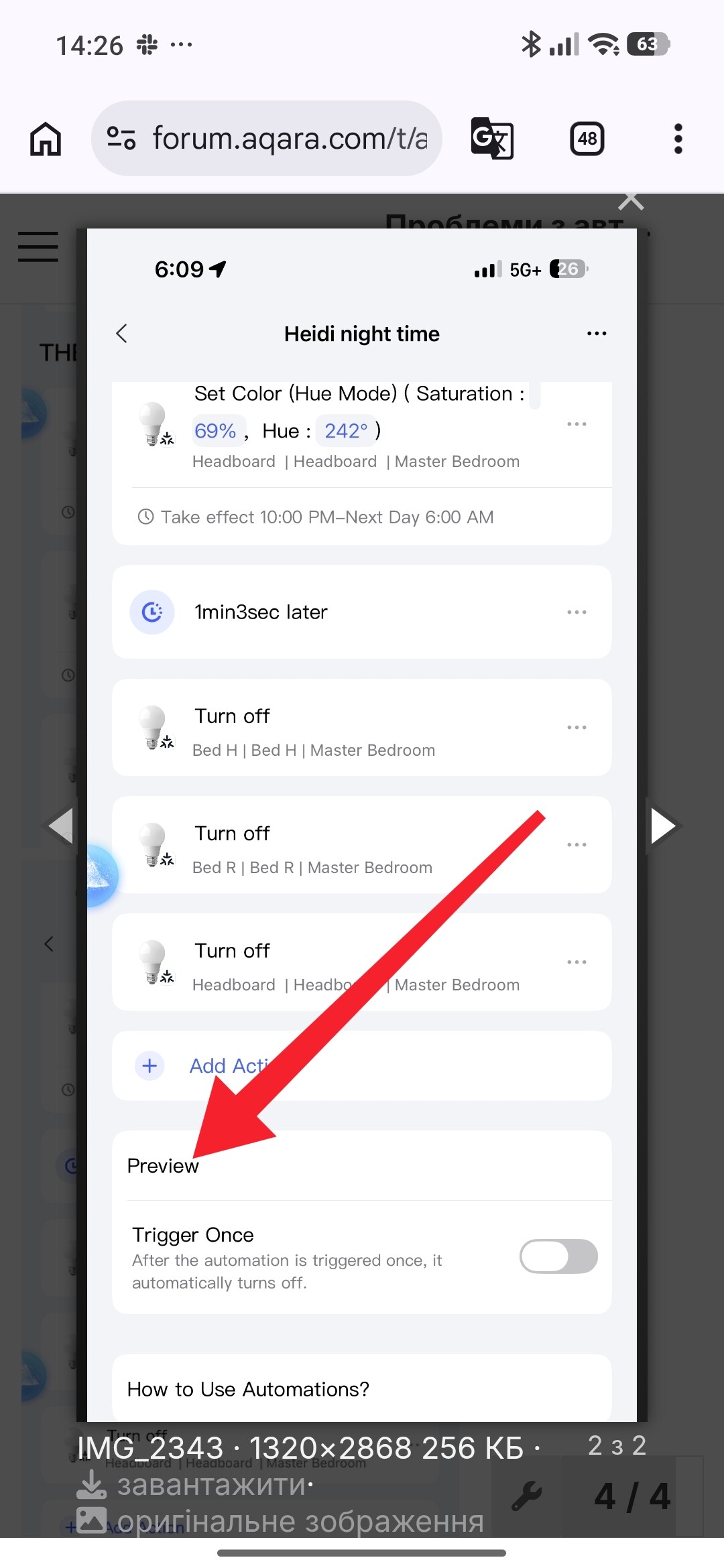

Did you press “Prewev”?

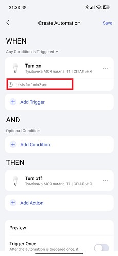

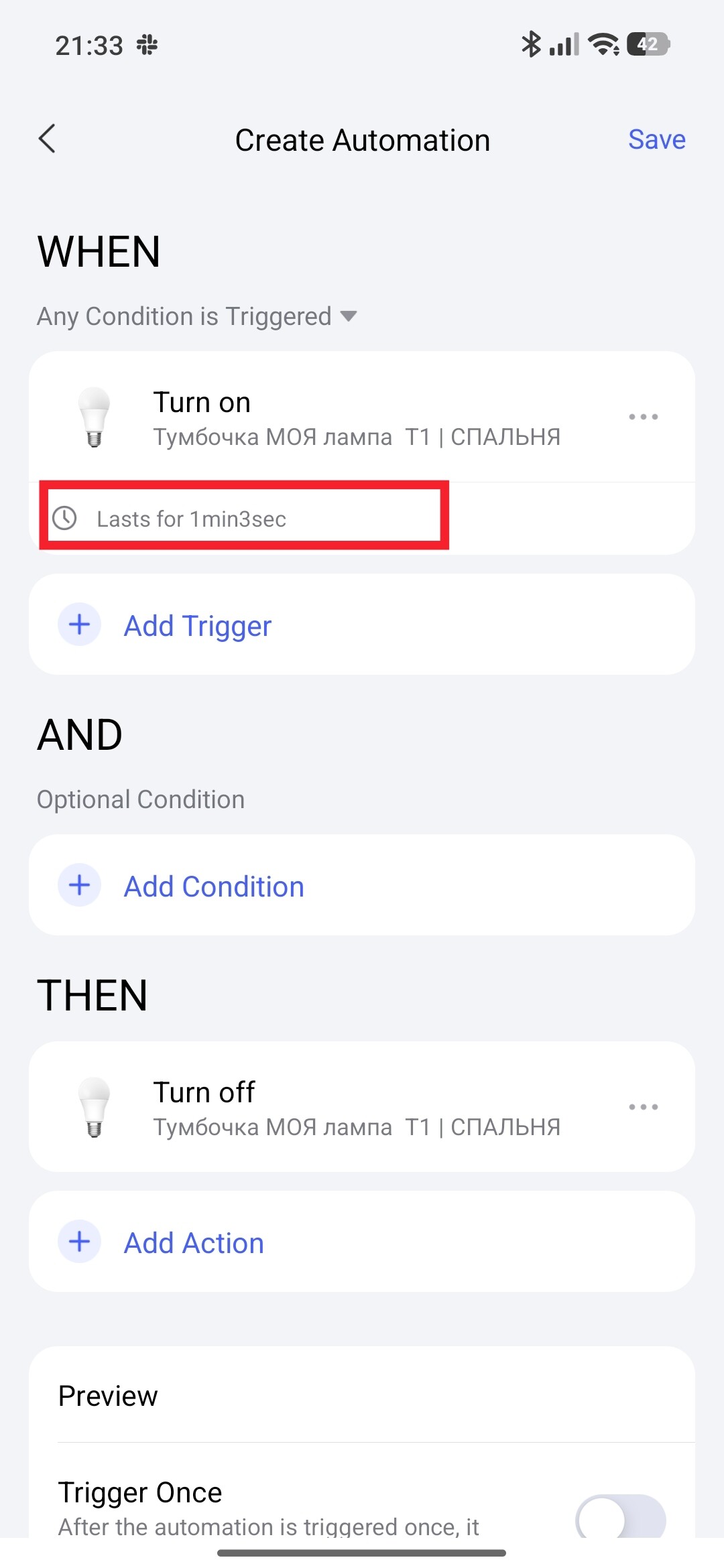

For a temporary solution, I recommend making additional automation for all lamps (I made a sample for one).
I did press the preview and it works but after the 1 min and seconds it won’t turn off. On this new automation but on the previous everything was working fine and the mesh that I added I don’t think is the issue because they blend in. Look
Try moving the delay time in the automation and click “Preview”.
Maybe something was written incorrectly?
By the way, does automation show “local” in the conditions?
Now it shows local but before it was cloud
