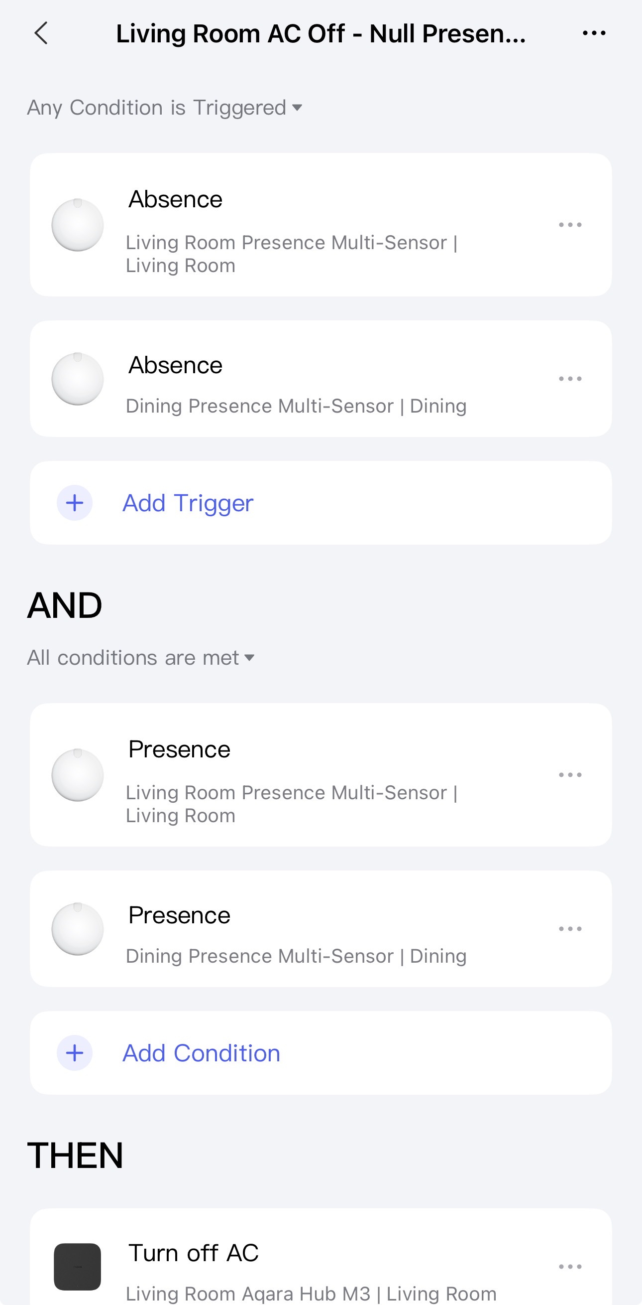

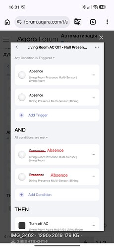

So. The picture attached shows (2) FP-300. One in the living room, one in the dining room when absent…I want to turn off the ac unit. In the when statement it shows any condition…. I want it to be an OR statement. Ex. If the living room sensor. OR the dining room sensor is absent. Then turn off the AC unit. I modified the AND. And put both as present. The sequence won’t work. Because I could be at one and not the other. I hope this makes sense. Your thoughts??

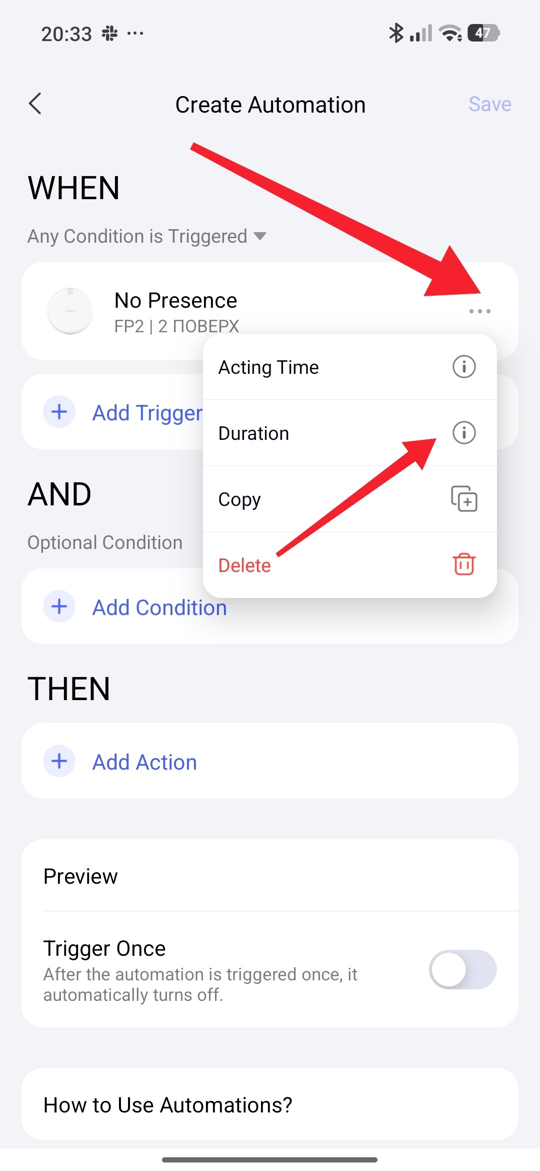

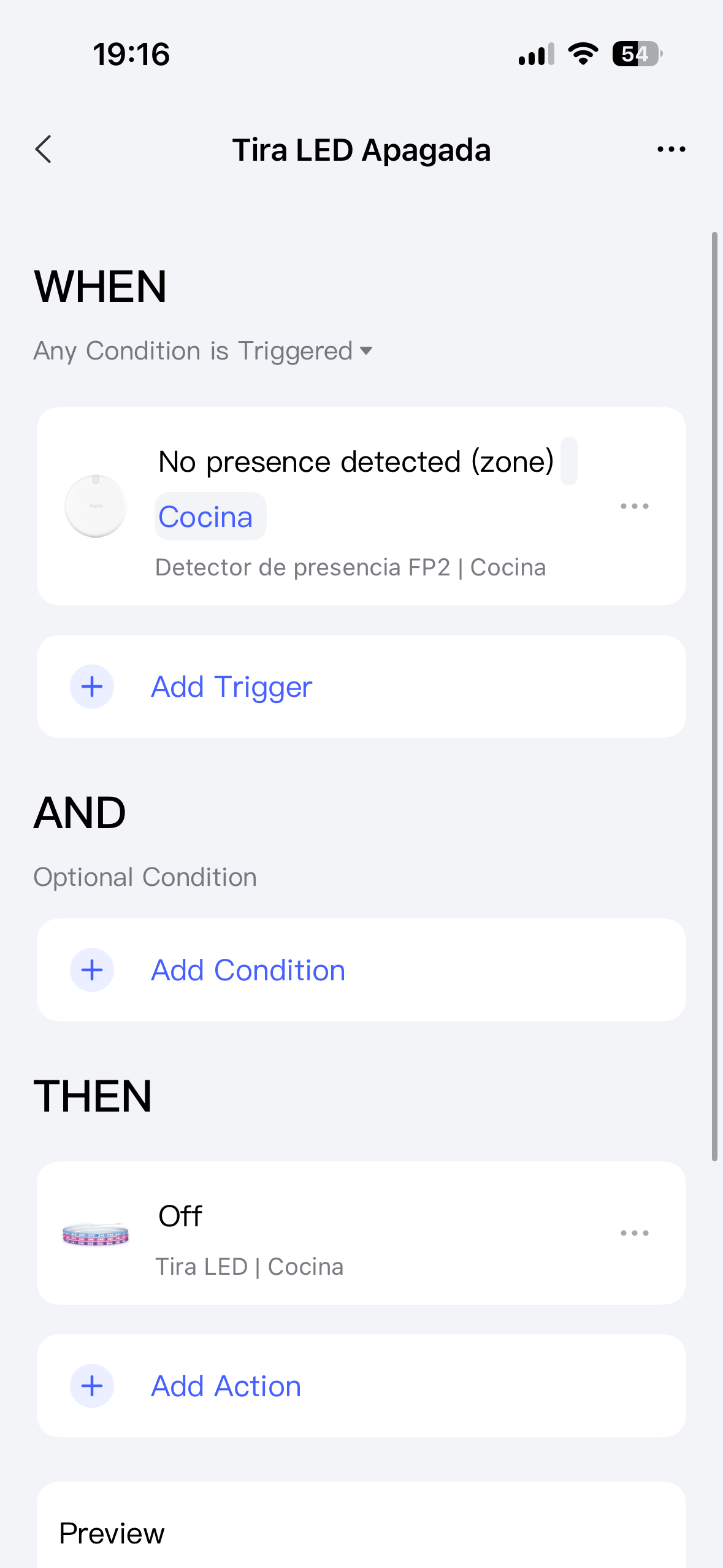

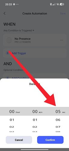

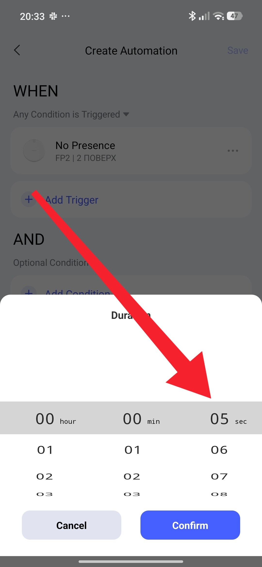

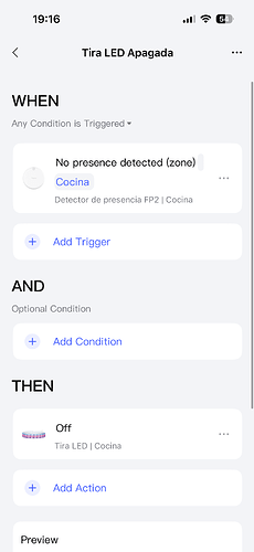

Well then try this way only that I am using an FP2 witch have zone detection you just chose “No presence” and ignore the and as I did here to turn off my LED strip and do an second one for the dining room my be this way will work
In automations such as option 2, I recommend using this parameter for reliable automation operation.
Sorry guys. I’ll try to be more direct.
If there is presence in the living room and not in the dining room - keep ac On
If there is presence in the dining room and not in the living room room - keep ac On
If there isn’t presence in the living room AND/OR the dining room. Turn the AC OFF
Both sensors at FP300
The first two automations I have working. It’s the last one I’m trying to get to work
If basically if both rooms don’t setext presence then turn off the AC
Oh, that simplifies things
IF (any)
Absence in living room
Absence in dining room
AND (all)
No presence in living room
No presence in dining room
THEN
Turn AC off
IF section is a trigger. It’s an event that activates this automation. That’s why it must be “any”, because it must be a single event that wakes the automation up (in this case: one of those two events). You may think of it as a “wakeup call” to the automation - this event happens when the smart sensor sends an update on the state.
Then AND sections evaluates additional conditions when the automation was “woken up”/activated. That’s why you can use “all conditions are met” - at this point, the automation is already running and you can check any conditions/state you want.
In this case, we want “all conditions are met”, because we want to check if there is absence in both rooms.
You must assume those conditions are checked with either IF event. That’s why you must provide “no presence” in both rooms, because this automation may be triggered by absence in either room (and you want the automations to be sure it only runs if there is complete absence).

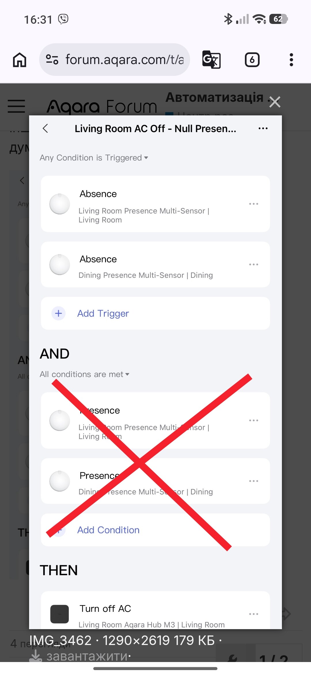

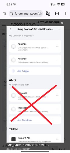

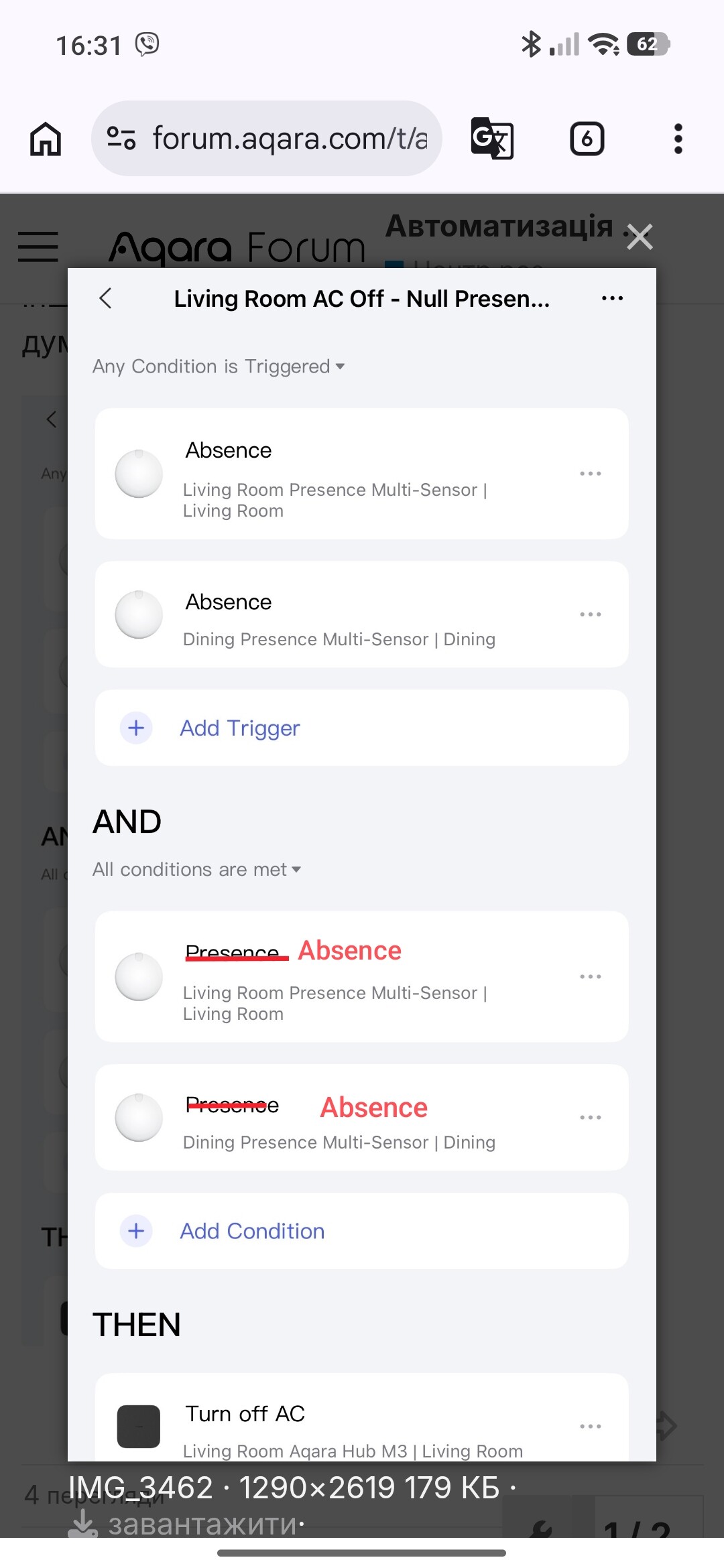

That’s what I had in the original screenshot at the beginning. But it’s not working. Or did I miss something
Ahh. I see it now. That makes sense. There isn’t a selection for no presence. Just absence in the and area.
In the first post you had “presence” in the AND condition instead of “no presence”
Yes, I should have written “absence” :smiley: Sorry, FP2 uses “No presence in (area)” and FP300 uses “absence” and I mixed up the wording
Nah man. It’s cool. I get it now. Thinking thru it. I just had the wrong selected for the AND. silly me. An OR statement would be nice. But I digress again. lol.
