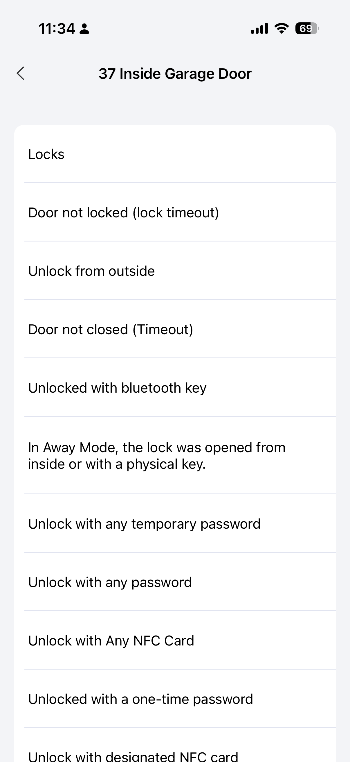

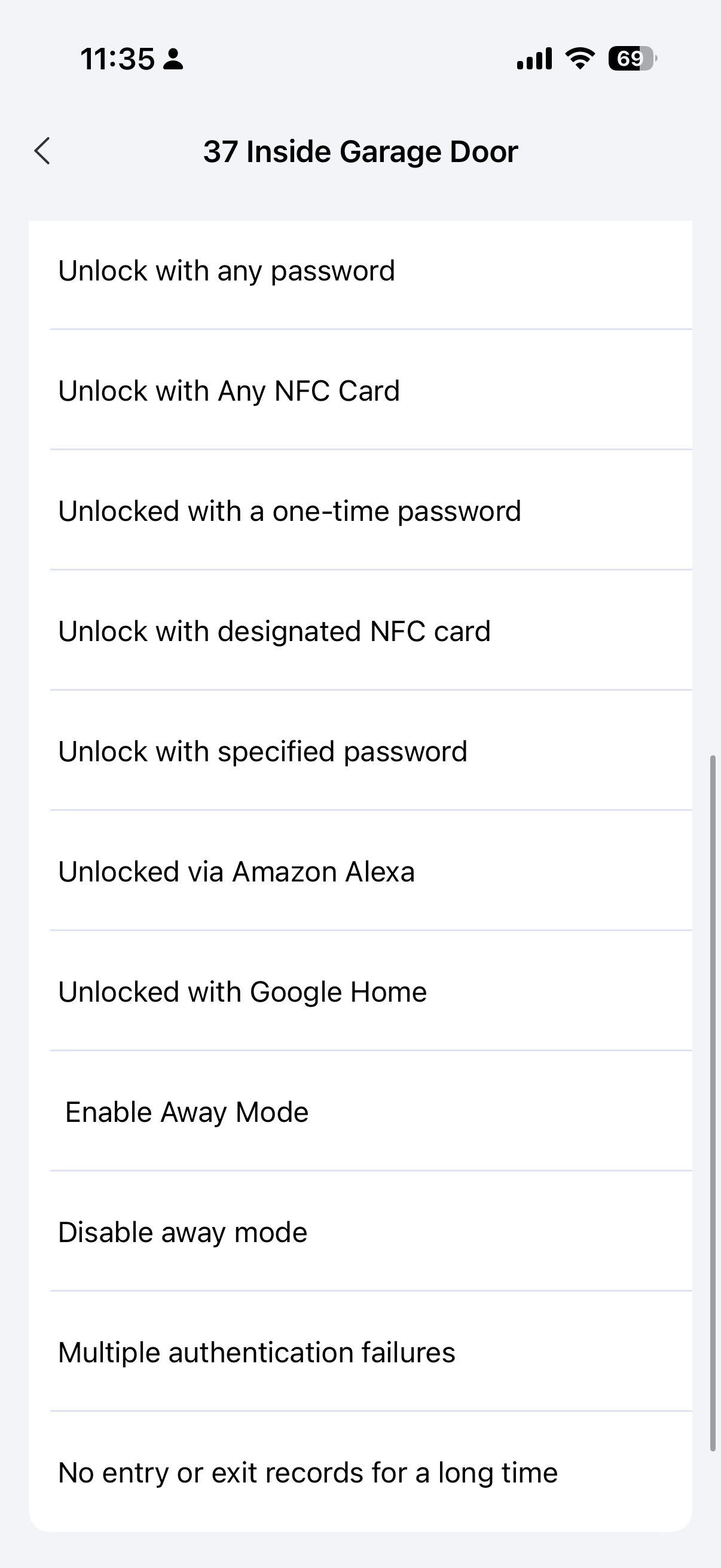

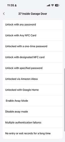

Give a screenshot of the WHEN section that the app offers you on the U50.
I don’t know what automation 2.0 is. When I set up the automation, I just click on the automation on the bottom of the screen. I think it’s in the middle and then go about it from there.

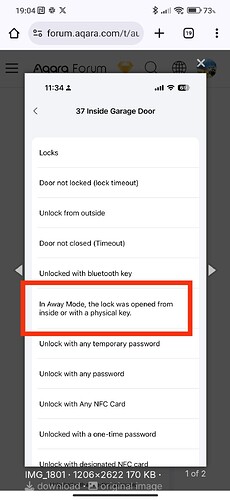

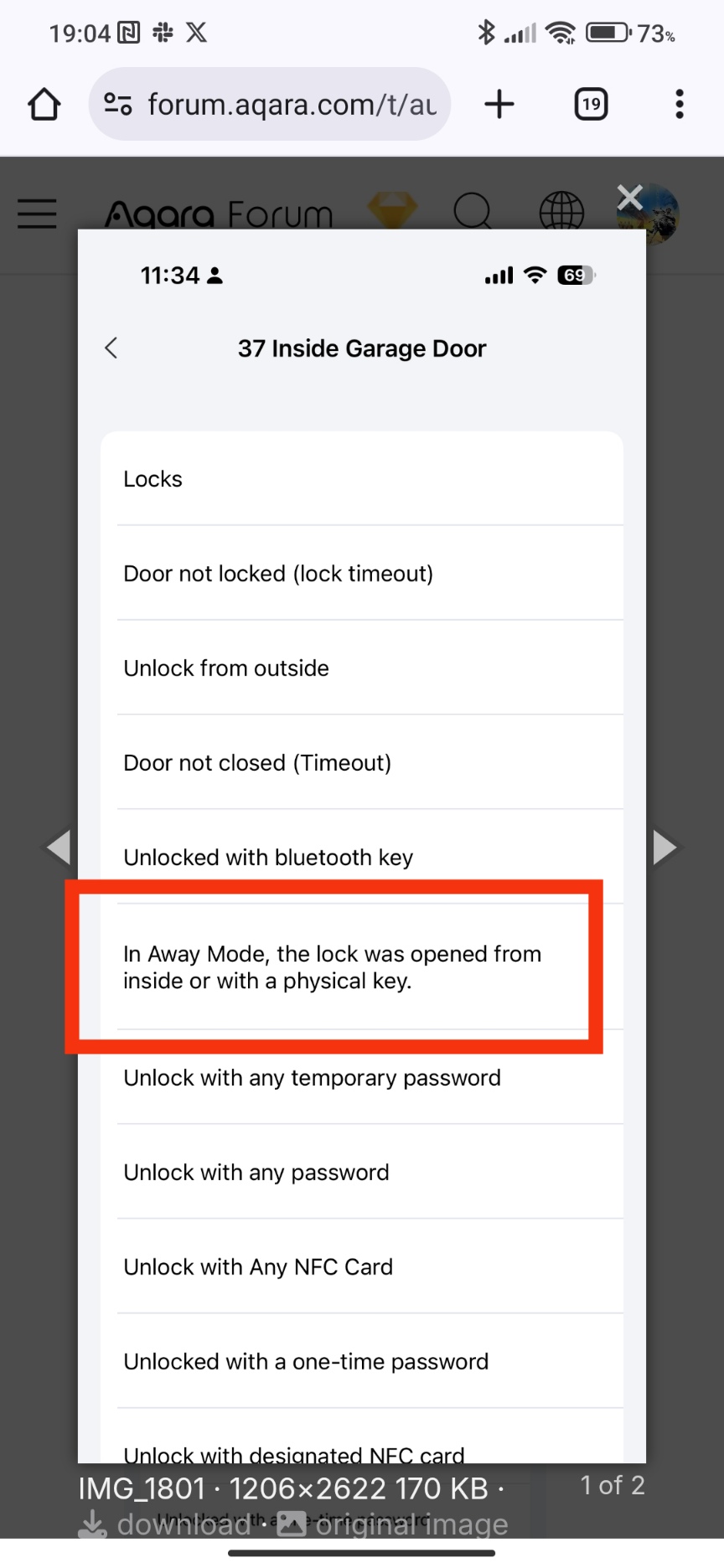

And this option should help you, have you used it?
Yeah, I tried to use that, but it didn’t do anything
Give a screenshot of the automation.
