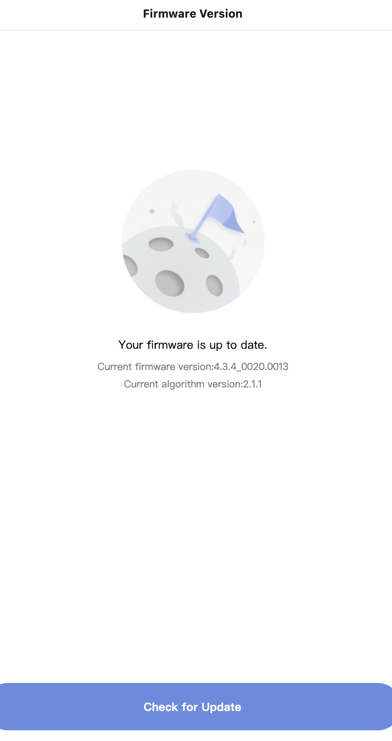

I have confirmed that I have the latest firmware but i still cant create the automation locally.

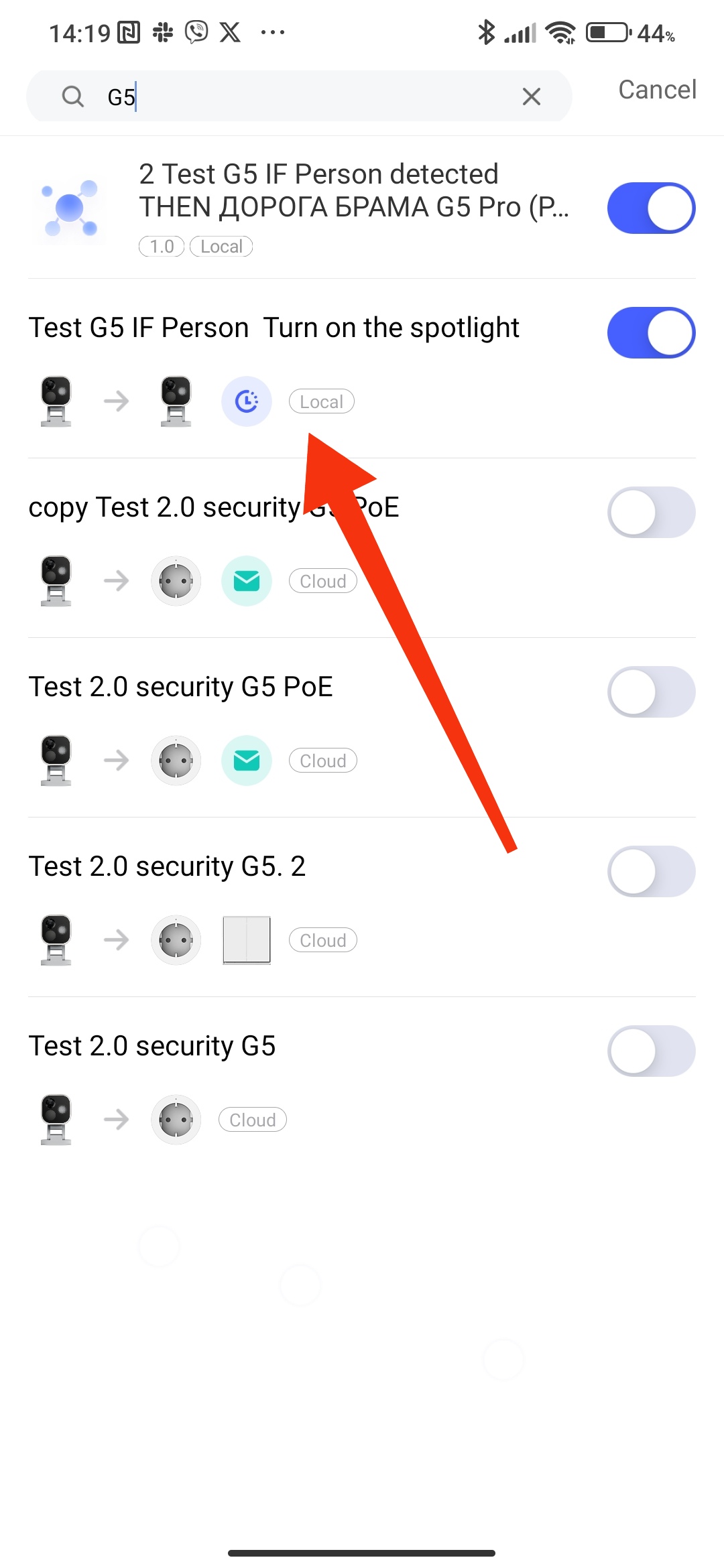

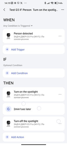

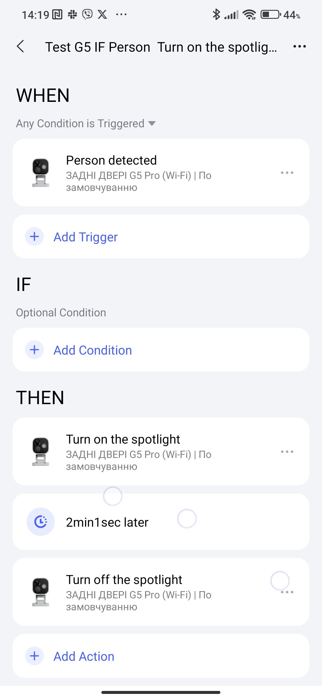

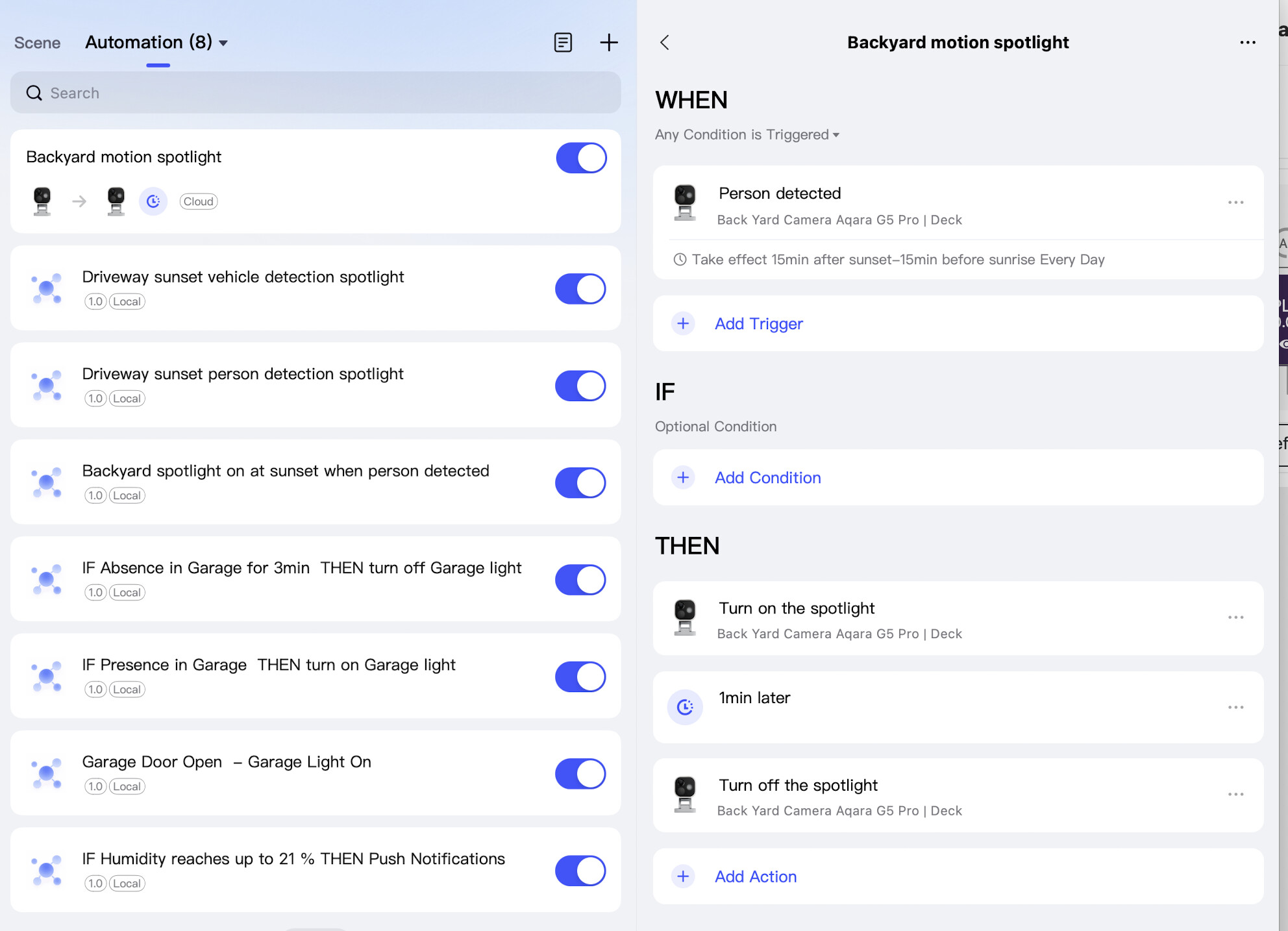

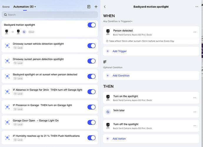

Hello, please show me screenshots of cloud automation.
this is using automations 2.0

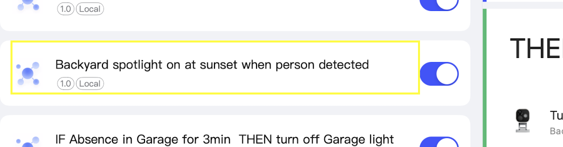

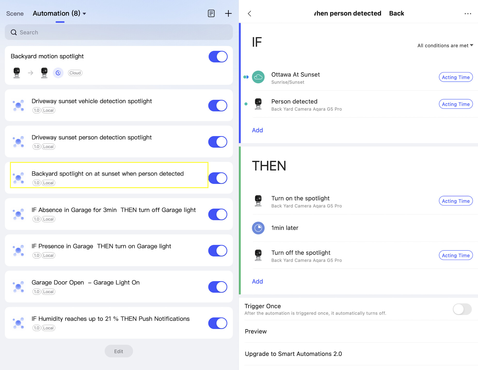

this is the same automation using automation 1.0
Hello, the second automation is 100% cloud-based, weather conditions are used there. All automations with weather conditions take data from the Internet.
The first automation should be local, I will repeat it in my smart home and write back. It is not exclusive that AI is involved in automation there, so it can also be cloud-based.
thank you for your help with this, you stated the second automation is cloud based but why is the second automation marked as local on left hand side menu?
Sunrise/sunset do not count as weather because they can be calculated based on date/time and location - so at least in theory they can always be computed locally.

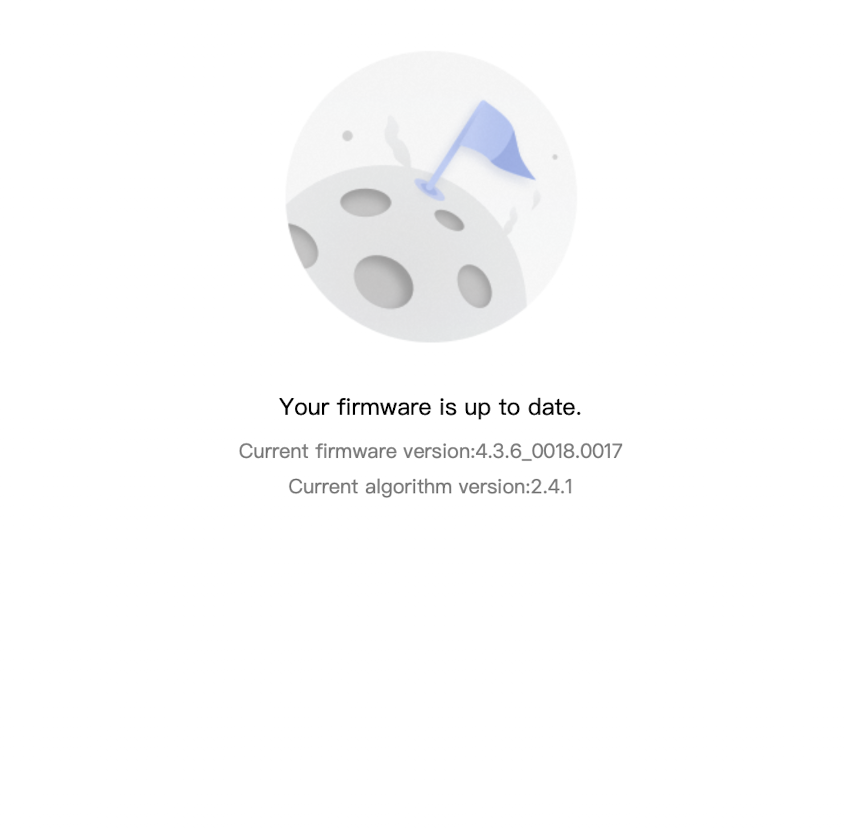

I have your local duplicate. What firmware do you have on your G5? I have version 4.3.8. It may depend on the firmware.
On older versions of the G5 firmware, automation 1.0 is local, on 2.0 it is cloud-based.
I have version 4.3.6 and it states its current , thats strange.
Wait for the new firmware to arrive, but for now use 1.0.
ok thank you again for the help, any ETA on the new firmware?
