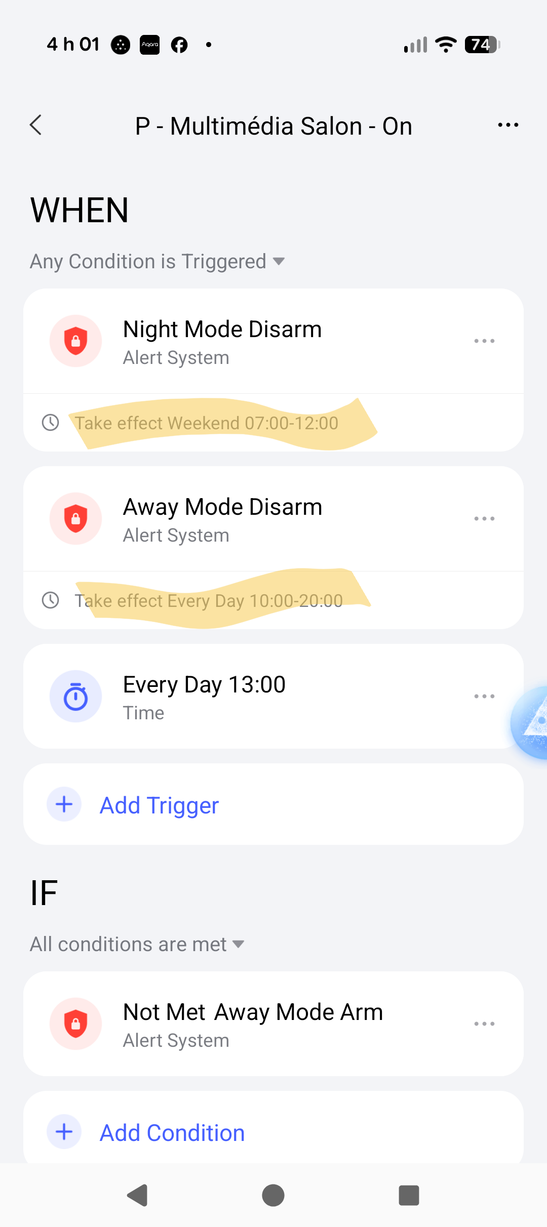

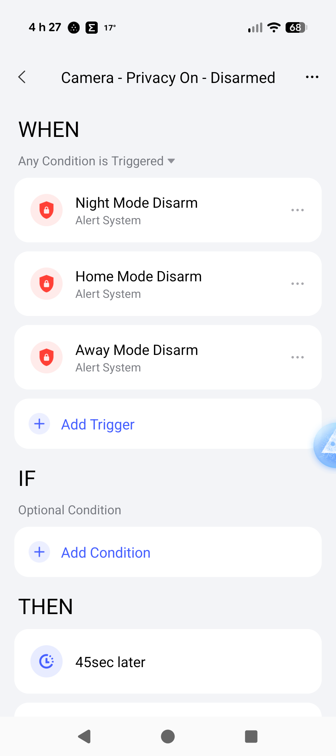

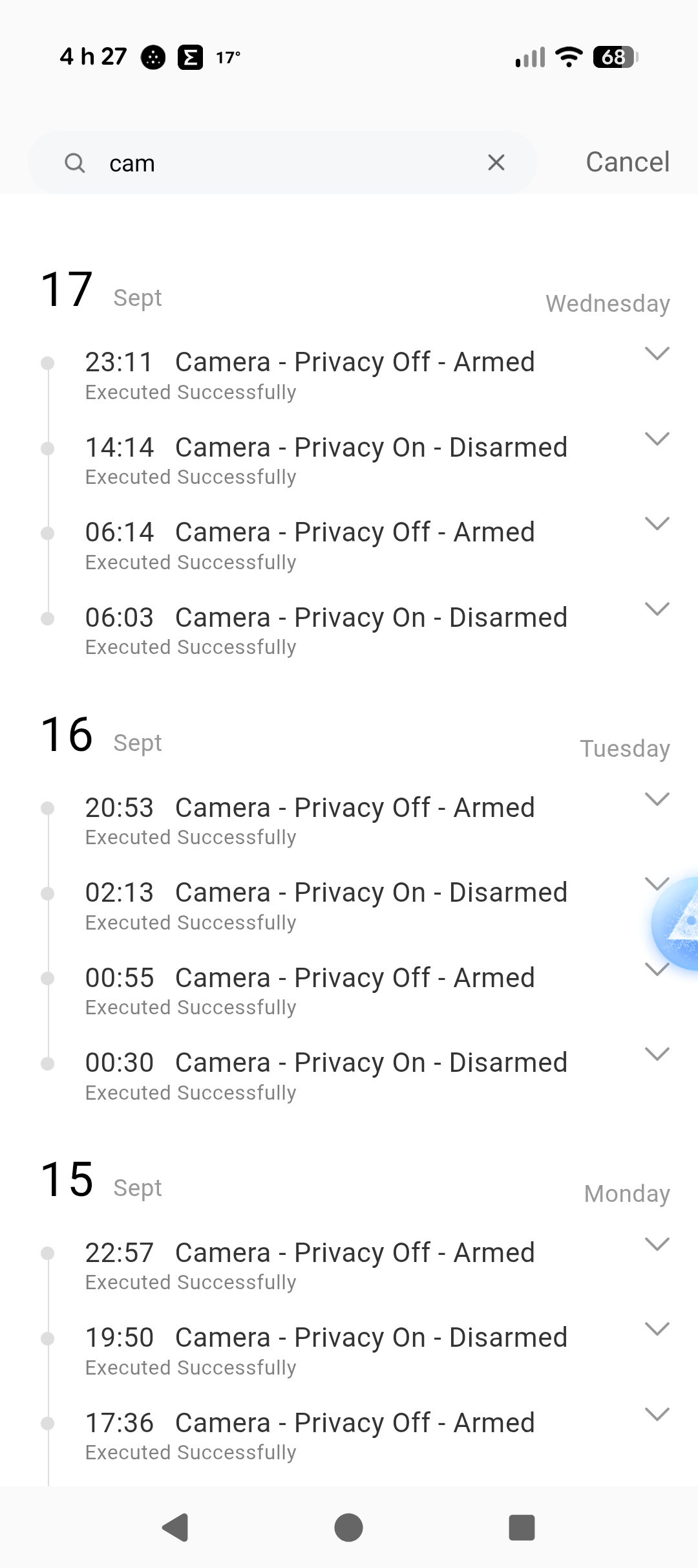

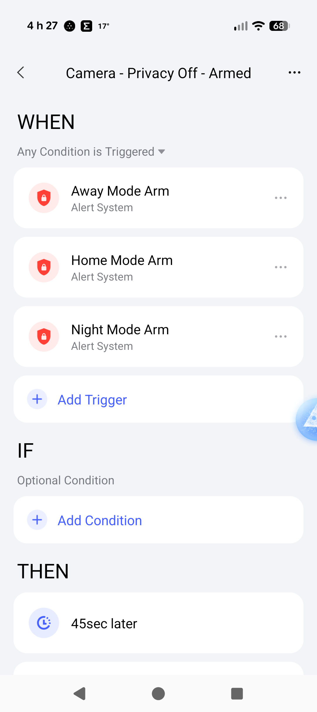

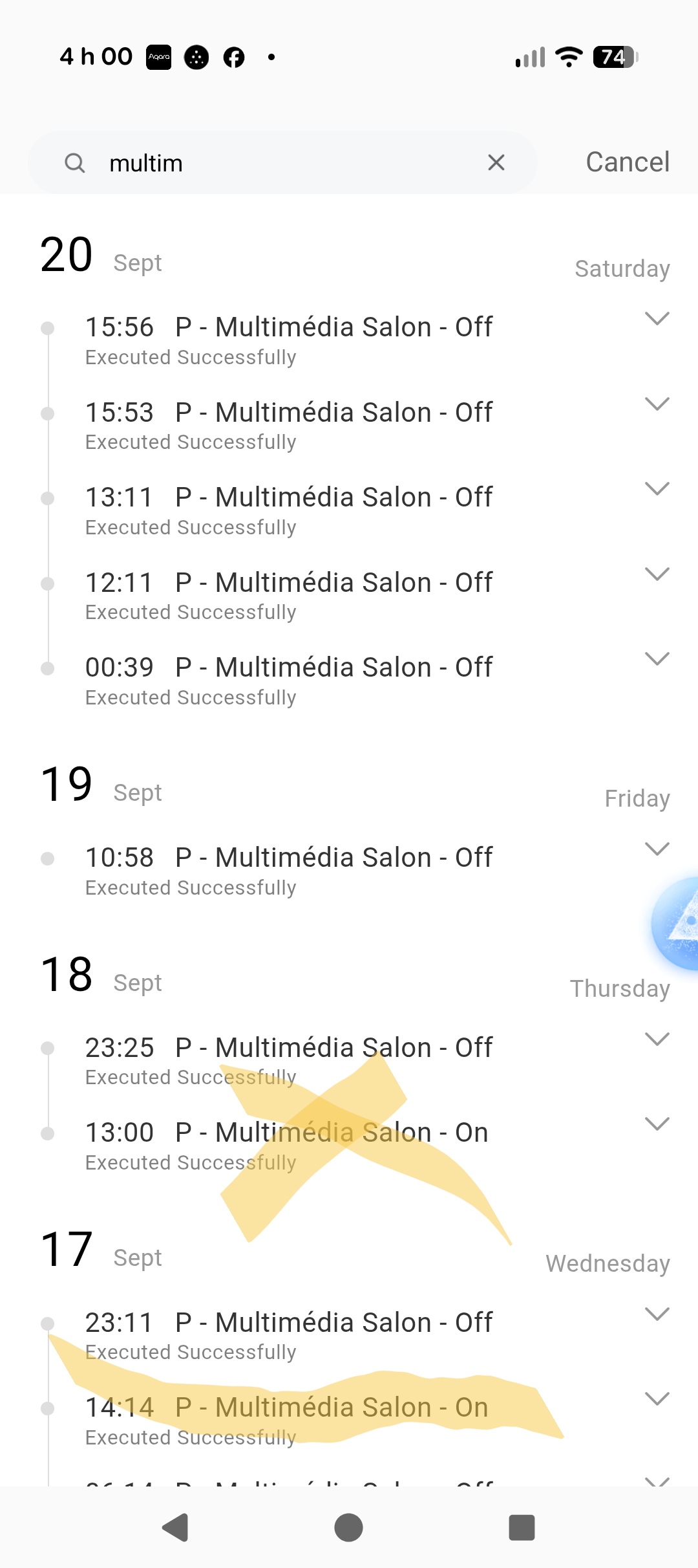

Since Wednesday, September 17th, my automations that are triggered by the alarm system state combined with a time period have completely stopped working.

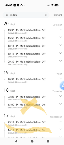

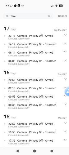

The last successful execution was on September 17th at 14:14.
For example, I have an automation where the trigger is Night Mode Disarm or Away Mode Disarm with specific time ranges, but these no longer activate.

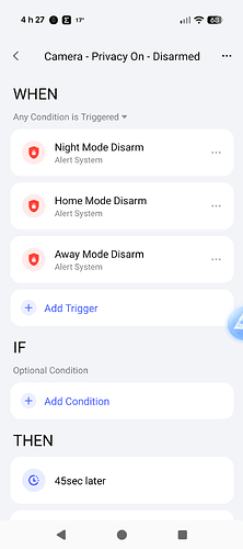

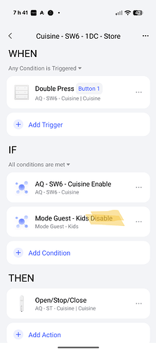

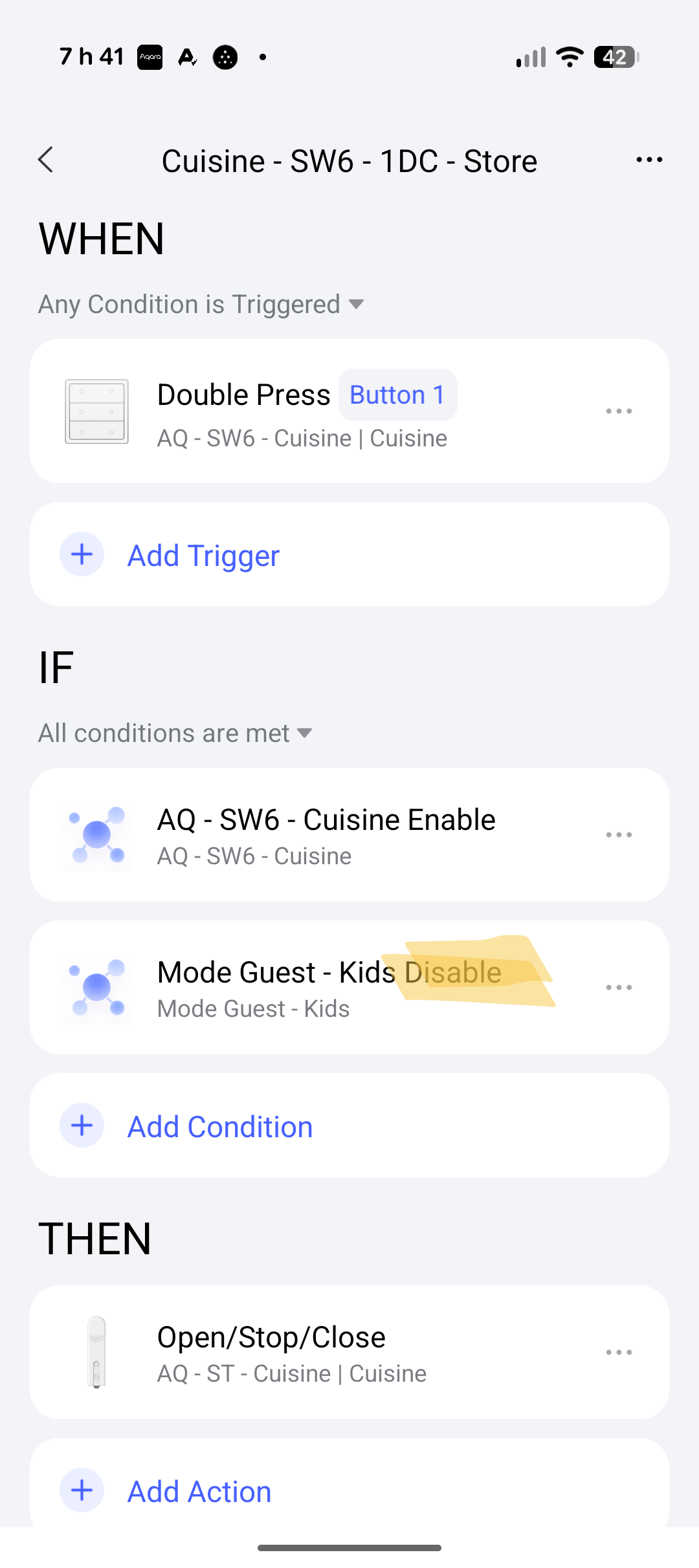

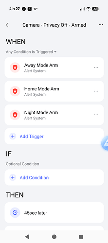

Oops, my mistake. I also have other automations related to the alarm system that stopped working, even without a time period.
Automations with an if automatisation is NOT enable condition stop working! . But they do work when the if automation is enabled.
Hi Marc, has this issue been solved now?
Now working for me.
Thanks!

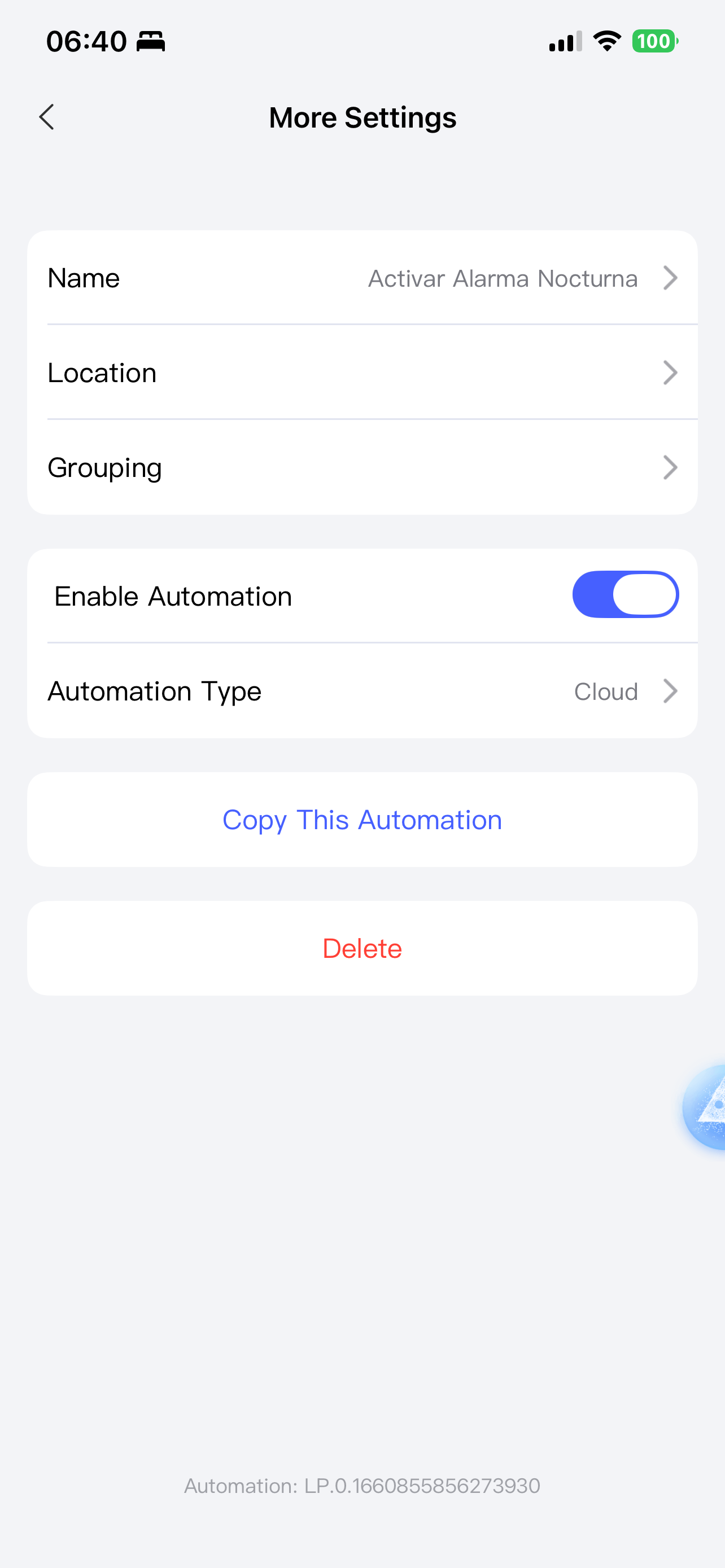

Hi, I’m experiencing the same issue, and it only gets temporarily fixed by editing the automation time and then changing it back to the desired schedule, but after a few days the problem comes back. I don’t know if the issue is in the cloud (since unfortunately the alarm system automations are still not local, though I know you’re working on making them so) or if it’s something related to the app or the Hubs.
It just stop working for me again.
