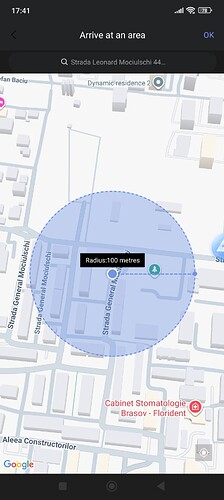

I think you can use location-based automation. When it’s 100 meters from the house, the gate opens.
