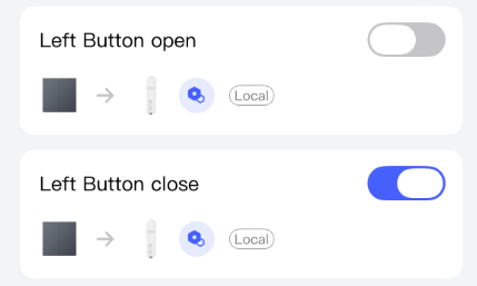

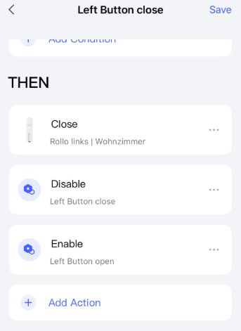

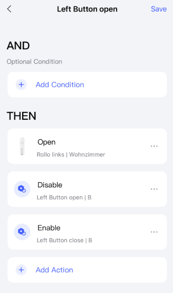

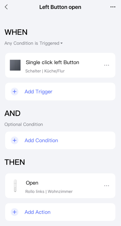

I haven’t tested this myself yet, but give this a try in Aqara Home under Automations:
First, create these two automations:
Then, edit them so that after running, they disable themselves and enable the other automation.
This way, you can always toggle back and forth between opening and closing with a single click.
You just need to disable one of the two beforehand, depending on whether the blinds are currently open or closed.

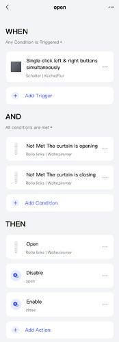

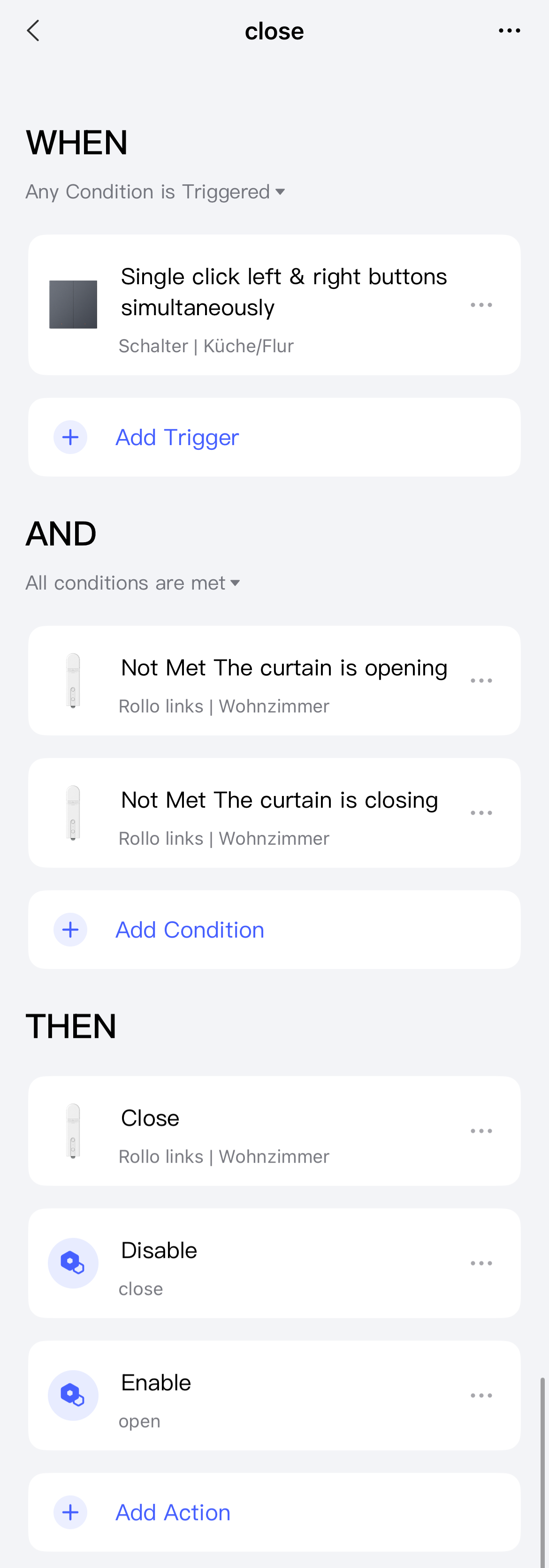

@ott_silver I just had another idea.

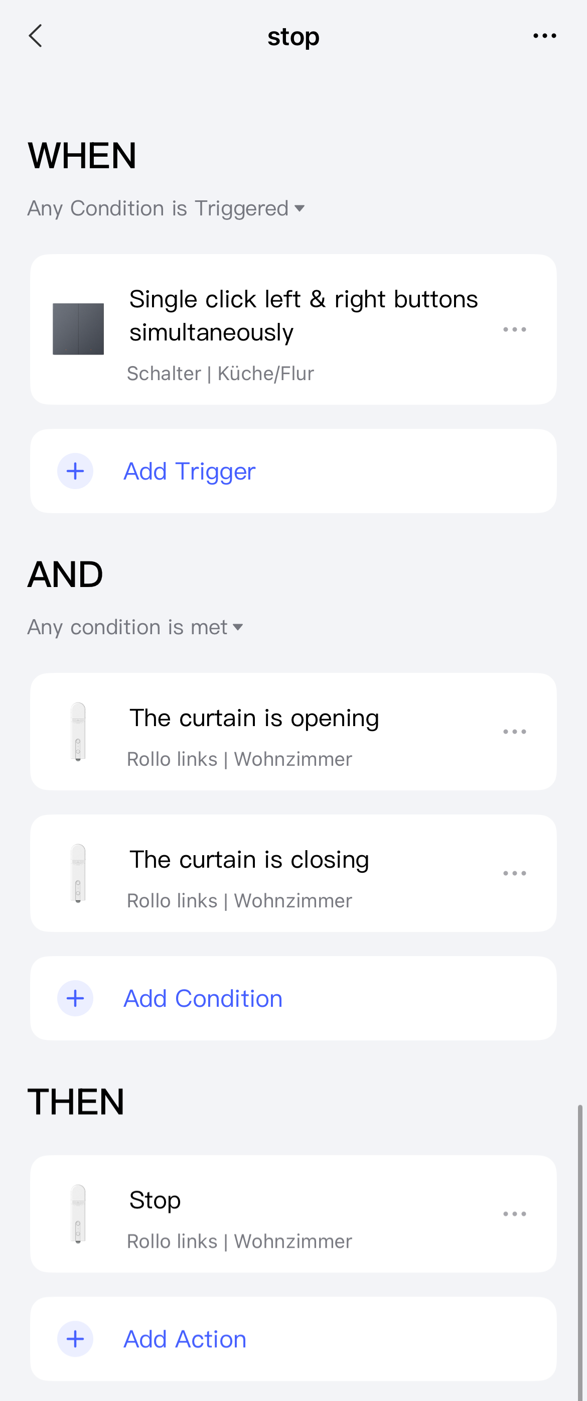

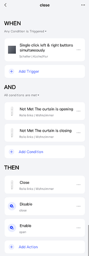

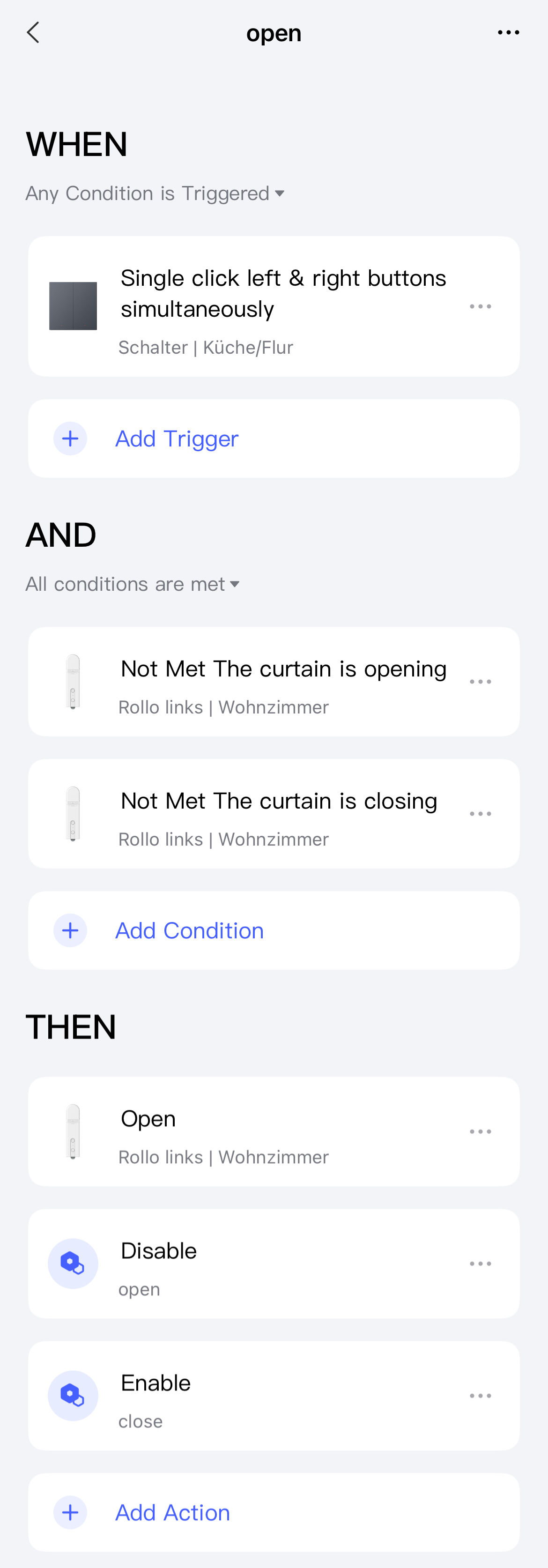

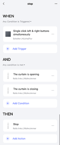

As I mentioned, “hold-to-run” unfortunately doesn’t work. But I remembered that with my Aqara Shutter Switch H2, you can press a button once to move the blinds up or down, and press it again to stop them right there. You can easily recreate this behavior in the Aqara Home app.
Just set up the two automations for opening and closing like before. Then, add two conditions: “The curtain is opening” and “The curtain is closing”. Select “Not met” for both (it’s hidden behind the 3 dots next to the condition) and make sure “All conditions are met” is selected.
Finally, create a third automation for stopping. Use the exact same trigger under WHEN (like pressing the left button, pressing both, or whatever you use). Under AND, add those two conditions again (“The curtain is opening” and “The curtain is closing”) and make sure to select “Any condition is met”. Then under THEN, set the blinds to “Stop”.
Here are screenshots of all 3 automations:
Now you can roll them up, down, and stop them wherever you want with just one single trigger!
