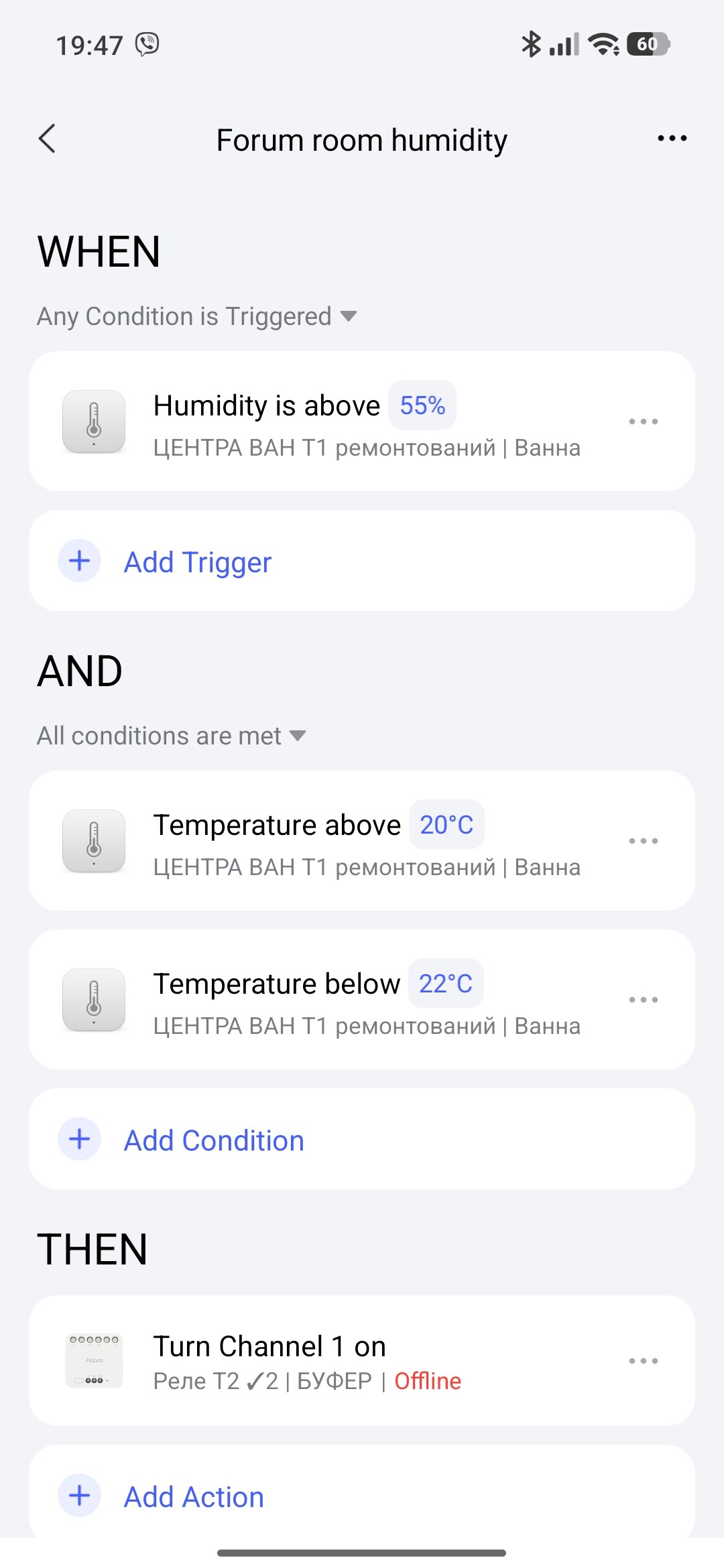

This version of simplified dew point control can be done with the following automation. Launch for the room (+20…22 °C)
WHEN: The humidity on the sensor becomes greater than or equal to 55%.
IF: additional condition: The temperature on the sensor is in the range from 20 °C to 22 °C.
THEN: Turn on the ventilation relay.
Fig.1.
