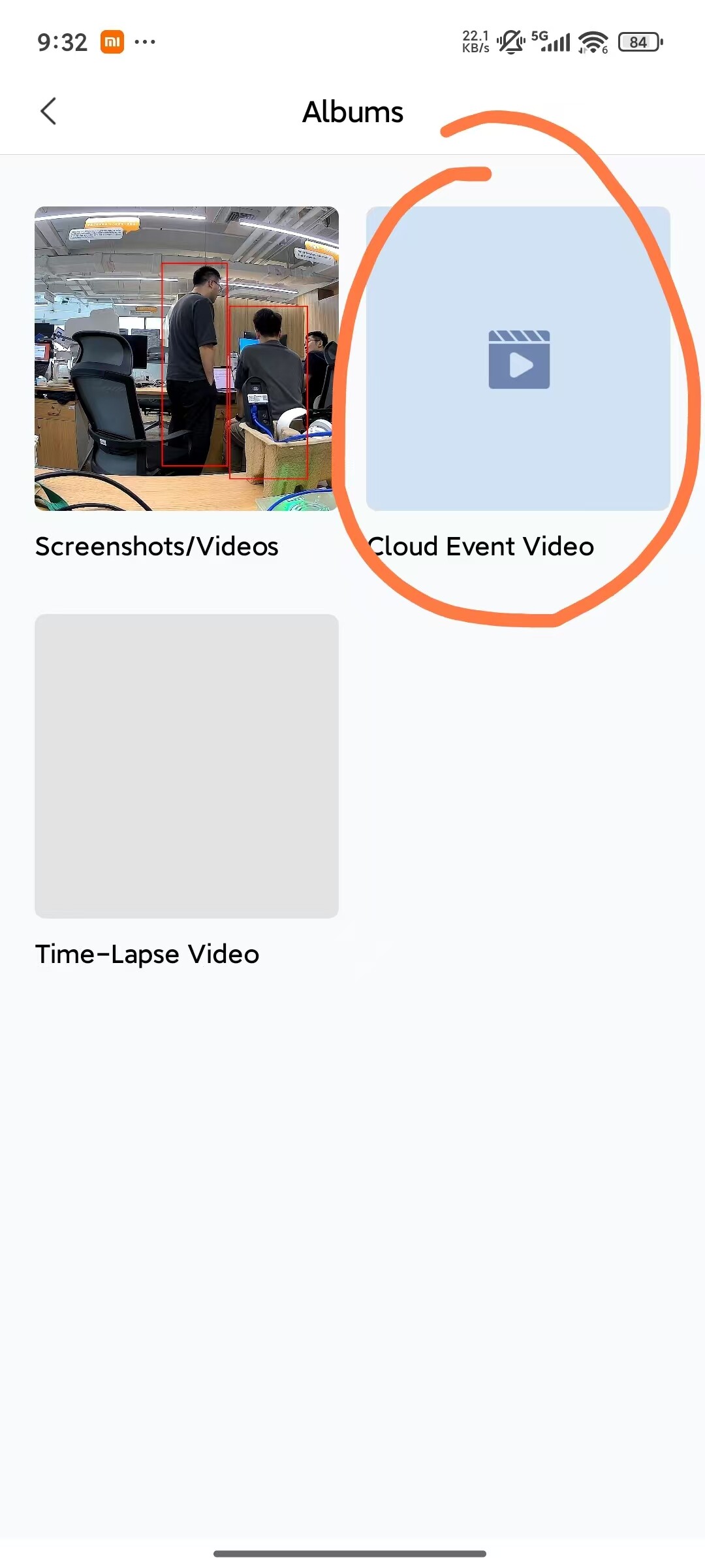

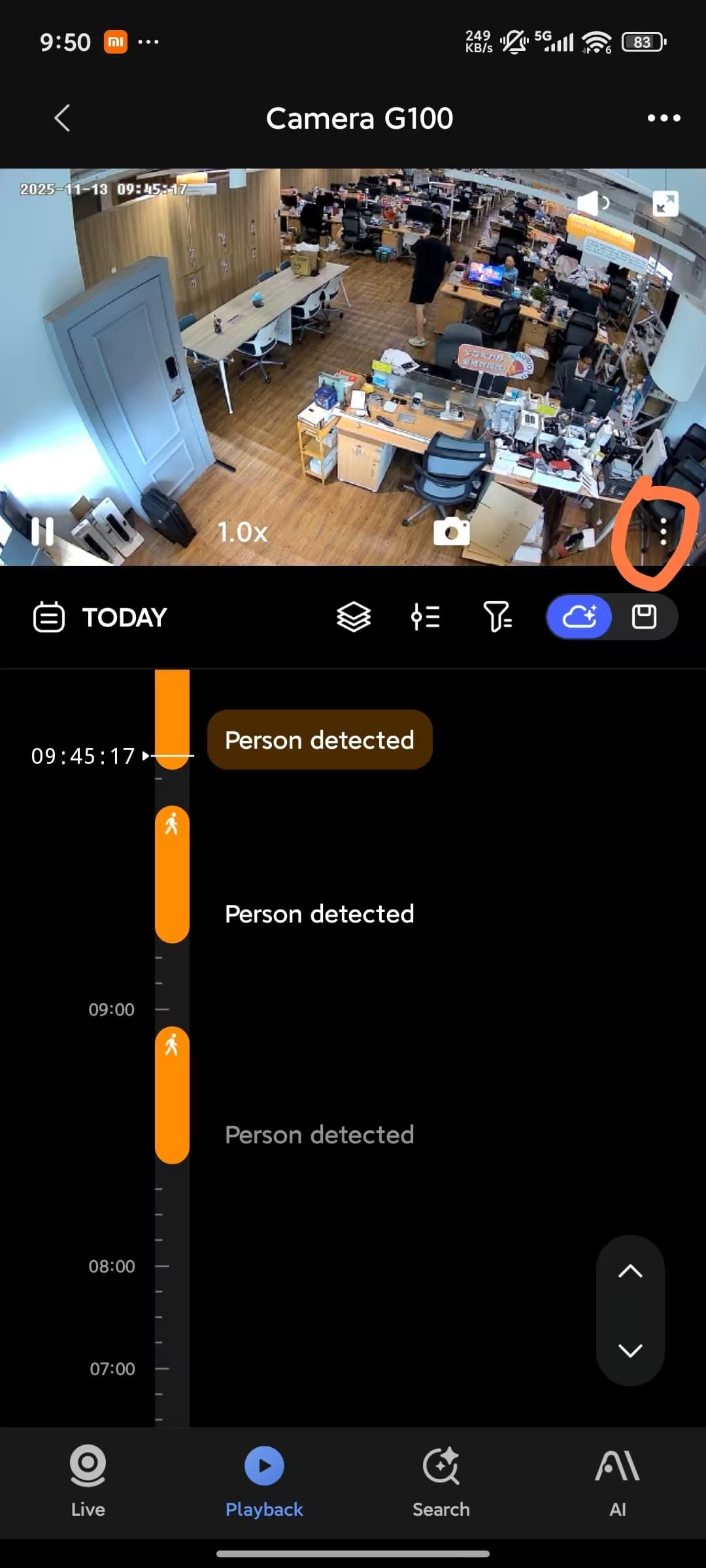

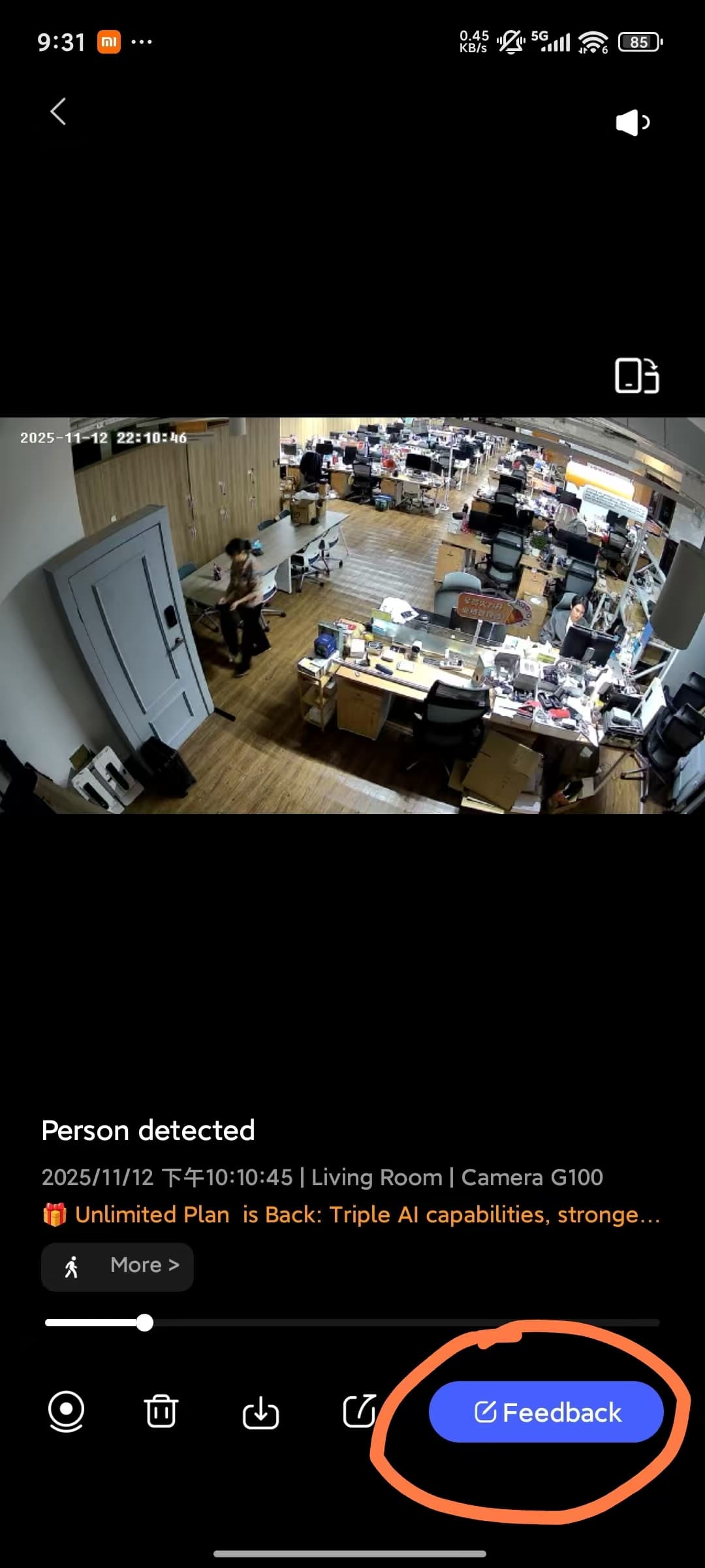

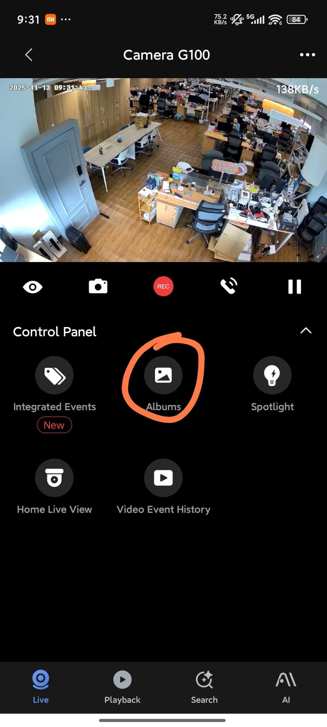

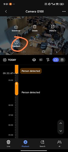

  4. I think the problem you are facing is the low accuracy of human detection, which is something we need to improve. You can mark the misidentification videos through the feedback channel on the app, or you can share them with me directly here (if you think it is possible). I will arrange for my colleagues to optimize the performance of the AI model. Based on my experience, when the camera’s overhead angle is adjusted too much (close to parallel to the ground), the misidentification of pets as humans will increase because quadrupeds lose some of their external features at this angle, causing the AI model to judge them as bipedal animals (humans). We are working hard to optimize the detection effect at this angle, but we still need some time, here is how to provide feedback on the app
or feedback from here

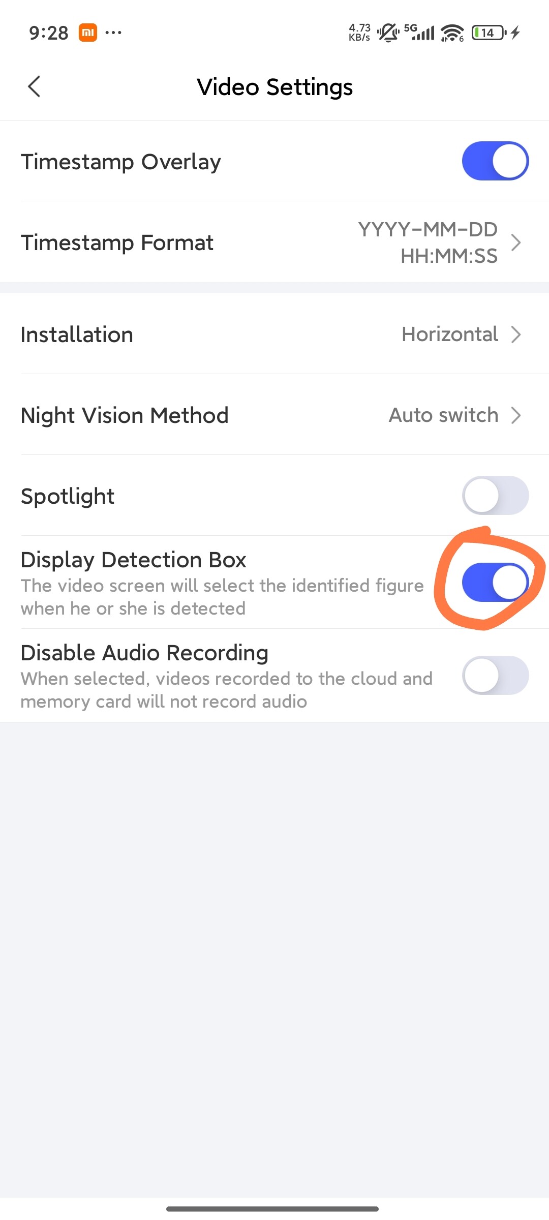

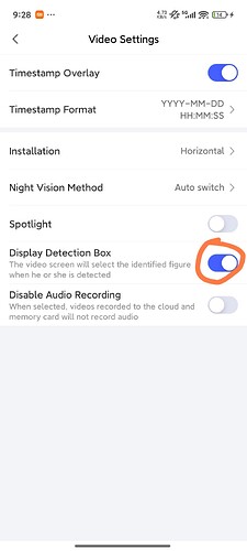

Additionally, I would like to add a method to confirm the detected target, as shown in the screenshot below. When you enable this feature, the target will be surrounded by a box, with different colors representing the detection of different objects. For example:
Red - Detected Person
Green - Package detected
Blue (light blue) - vehicle recognized
Blue - Pet detected
Yellow - Recognizing a face can confirm which target triggered the detection

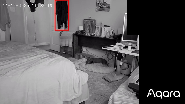

My colleague analyzed the video you provided and confirmed that the clothing on the door was mistakenly identified as a human.
Removed the clothing on the door, set up Detection Box. Still, camera thinks my dog is a person. Or camera thinks the blanket on the floor is a person?
