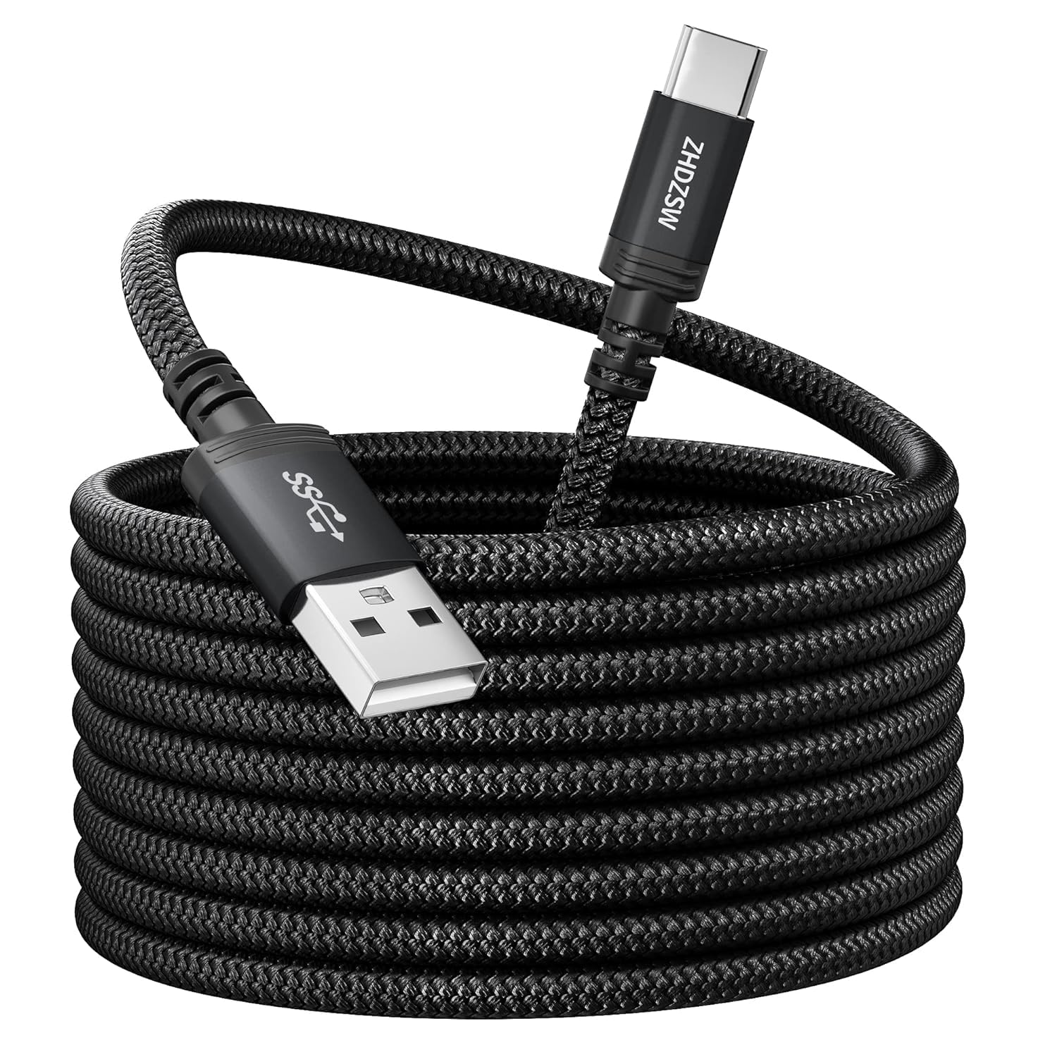

I checked the usb-c cable and it seems my 5m long cable makes the problem. I tried a three meter long cable and it works better. The problem is I need a five meter long cable. So could it be it has something to do with the length of the cable? Any suggestions from you all here in the forum?
Yes, it very well could be. 15’ is the maximum length cable and when I tested out longer cables my WiFi would cut in and out and the G5 camera would reboot randomly every few minutes. I tested out several USB-C cables longer than 15’ and the same thing occurred. When I used a cable 15 feet or shorter the problems went away and the cameras worked perfect.
Here is a link to the thread where I posted about it. USB-C cable length
I must insist that I’m very disappointed about the issue with the cable length. I owned a camera from Reolink before with a 10 meter long cable without any issues. I only switched to Aqara behause of the Apple HomeKit Support.
Okay guys, I bought a new cable and probably a better one…it is even 7 meter long (the one before was 5m). It seems to work better even it is longer. So my new insight in this issue seems to be not the length of a cable is relevant. It seems to be the quality of a cable.
And here is my recommendation …
