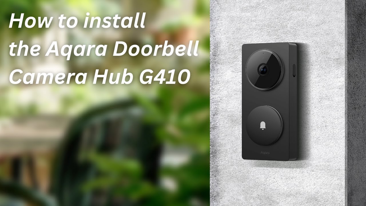

Hello @kaylaquackers
Please make sure that you are doing everything correctly by watching this video guide on installing and connecting the G410.
Please tell me what is the distance between your doorbell modules, as well as the distance to the router, make sure that it does not exceed the manufacturer’s recommendation!
