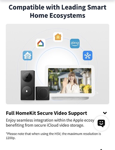

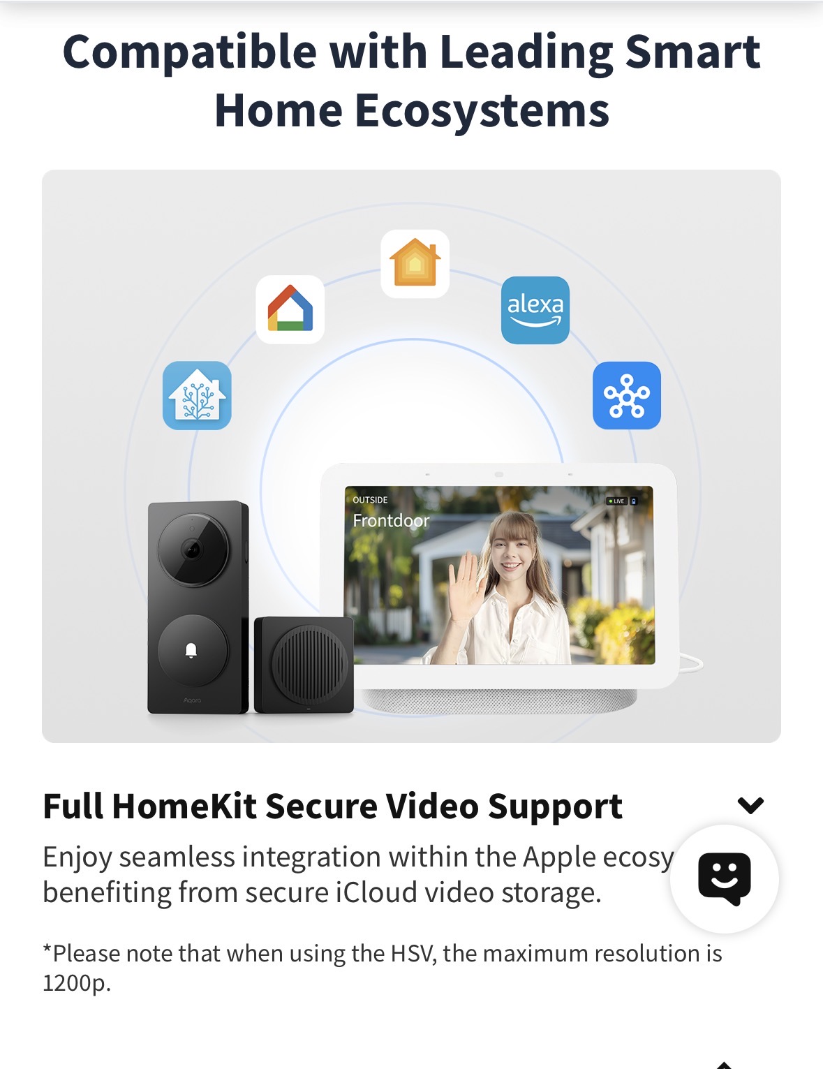

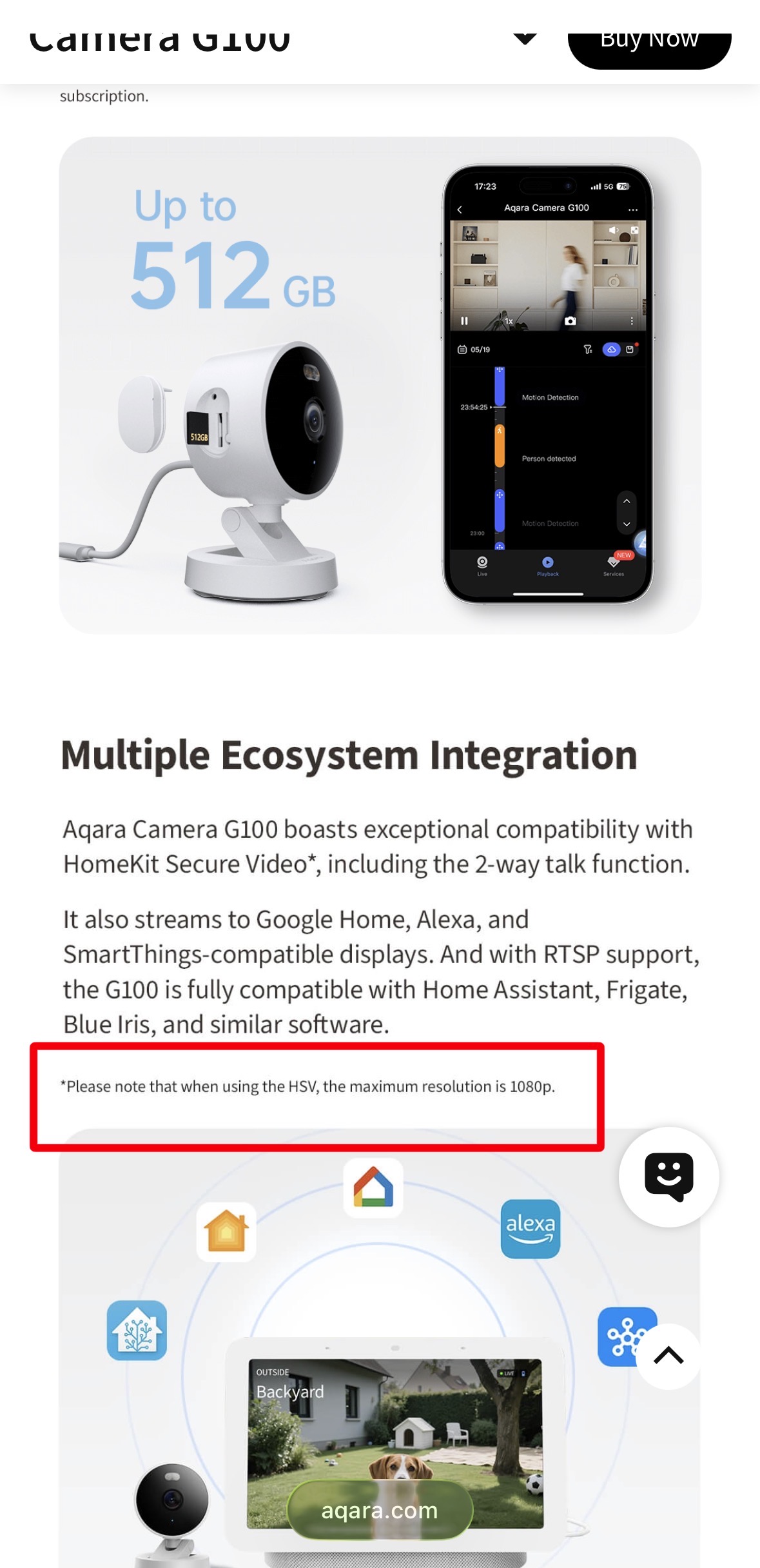

Hello @johnsond28
Did I understand correctly that this happens on your G100 camera?
Please note that when using the camera in AQARA Home and in Apple Home (HSV), the resolution on the G100 will be a maximum of 1080p, and on the G410 -1200p
