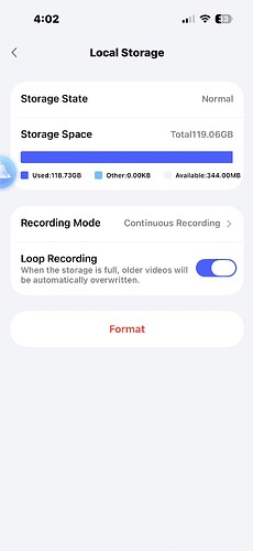

Camera’s Not Locally Recording
The Camera’s appear to have recorded footage but I can’t review it.

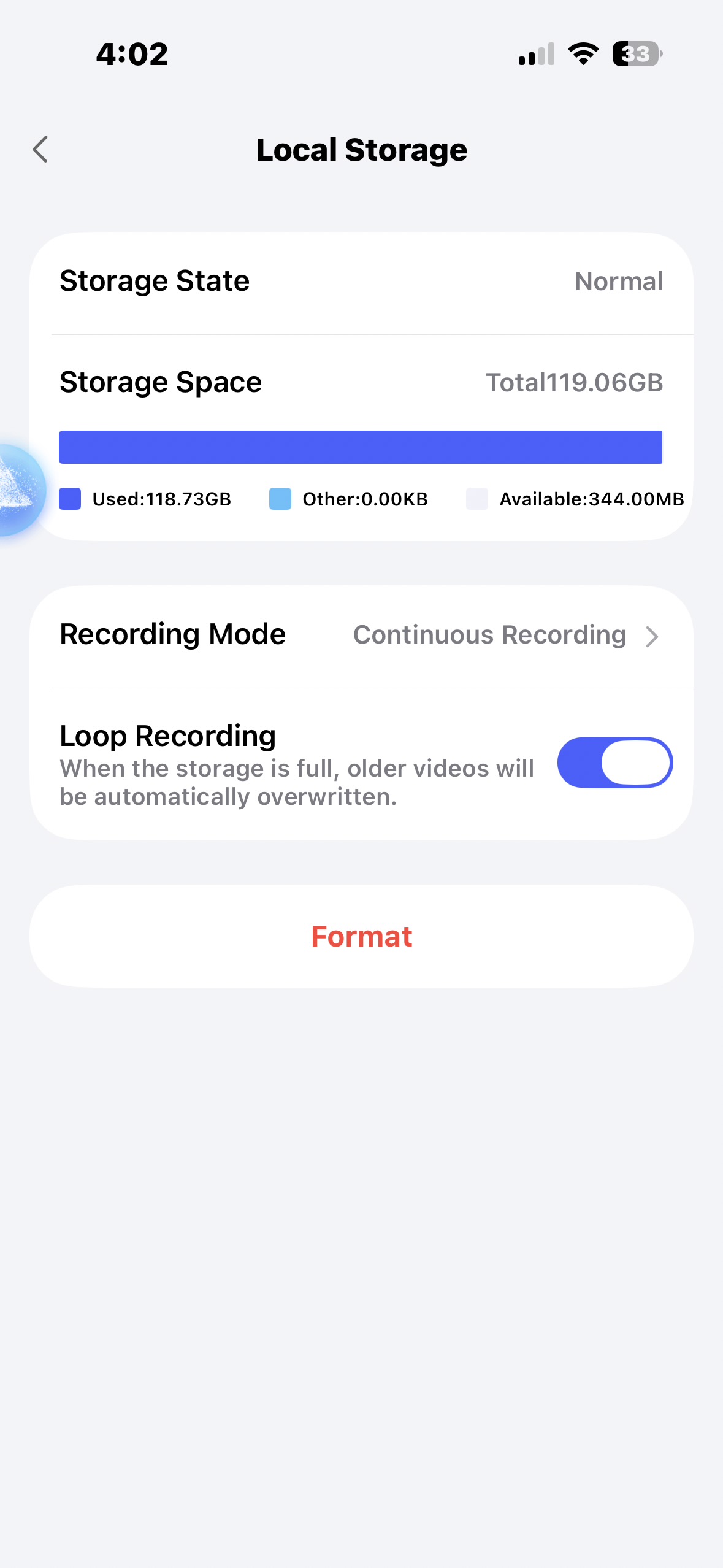

I had this problem once with the G3. Formatting the SD card helped and it’s working now.
If you want to try and recover recordings, you can put this SD card into your computer before formatting and see if there are any recordings.
The question is : did you format the SD from the camera menu before using it to record?

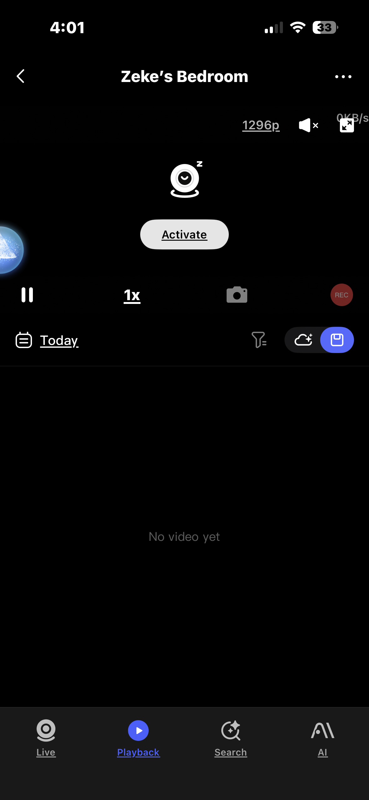

Yeah it turns out formatting does help, though the other part is it won’t show the local footage when it is in privacy mode for some reason.
On privacy mode the camera stays like in resting mode and doesn’t work at all or record nothing that is why you can’t see the recorded video
