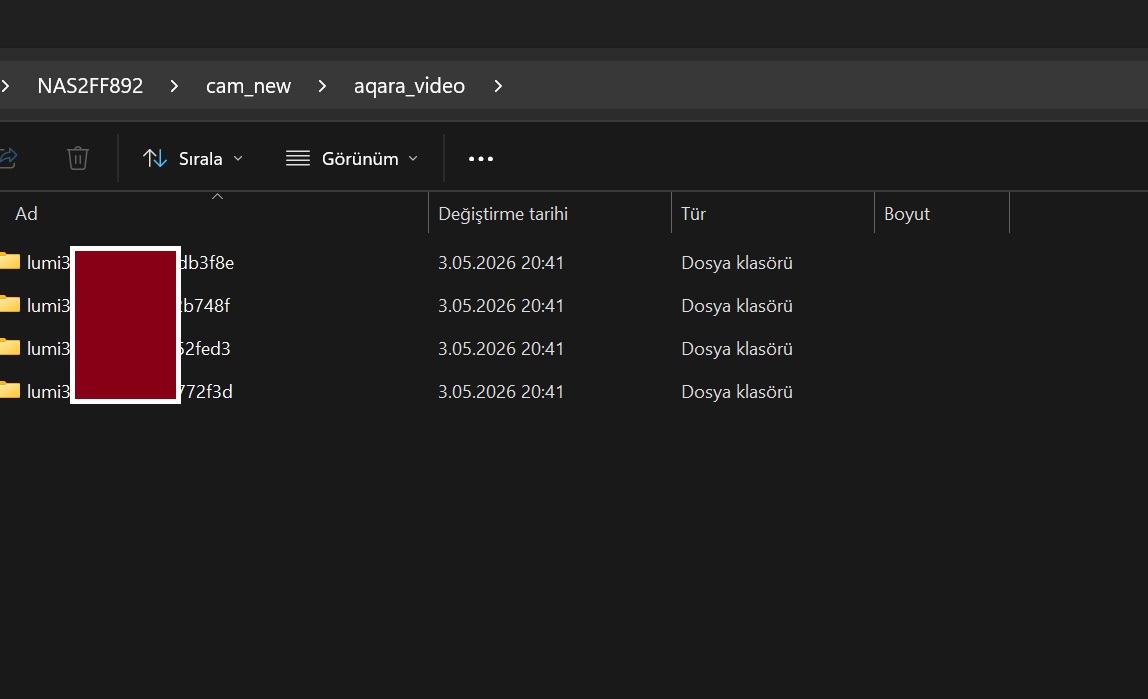

I currently have four Aqara G5 Pro PoE cameras installed in my home, and I am recording the footage to my NAS.
However, I am unable to rename the folders created for each camera. The recordings are automatically saved into folders named after the device IDs.

You could also create another folder, for example “videos”, alongside the “aqara_video” folder. In this folder, you can create symbolic links with “friendly” names that point to the cryptic folder names (Device IDs).
If you have a Linux-based NAS, you will need to log in via SSH. You can then create the symbolic link for a camera like this, for example:
ln -s "/volume1/video/aqara_video/lumi3.123dee987654e4a6" "/volume1/video/videos/Doorbell"
