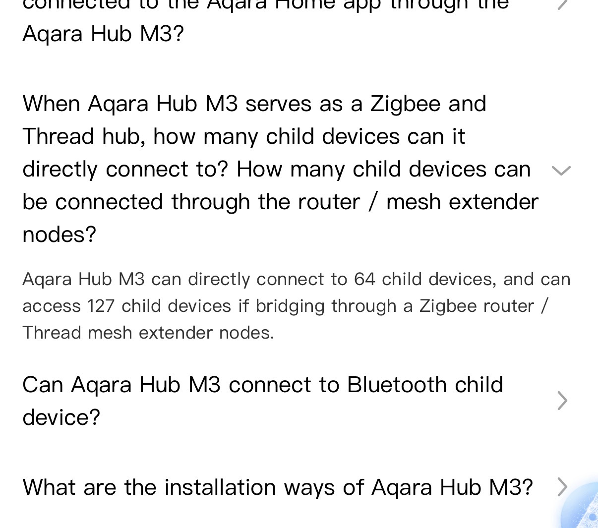

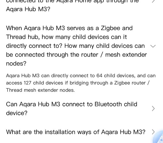

At least that’s how I understand “child devices if bridging through”, but maybe this feature is limited only to the M3 being a leader

Oh, then I’m sorry for spreading false info, I pair everything with the M3 (even the farthest devices, because my Zigbee network has strong signal in my whole home) and I just assumed this information from the M3’s FAQ. And actually I was sure it would work like this, because I thought I’ll just buy another M3 and it’ll “just work” when I hit the device limit.

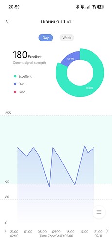

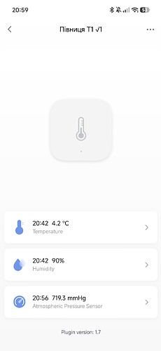

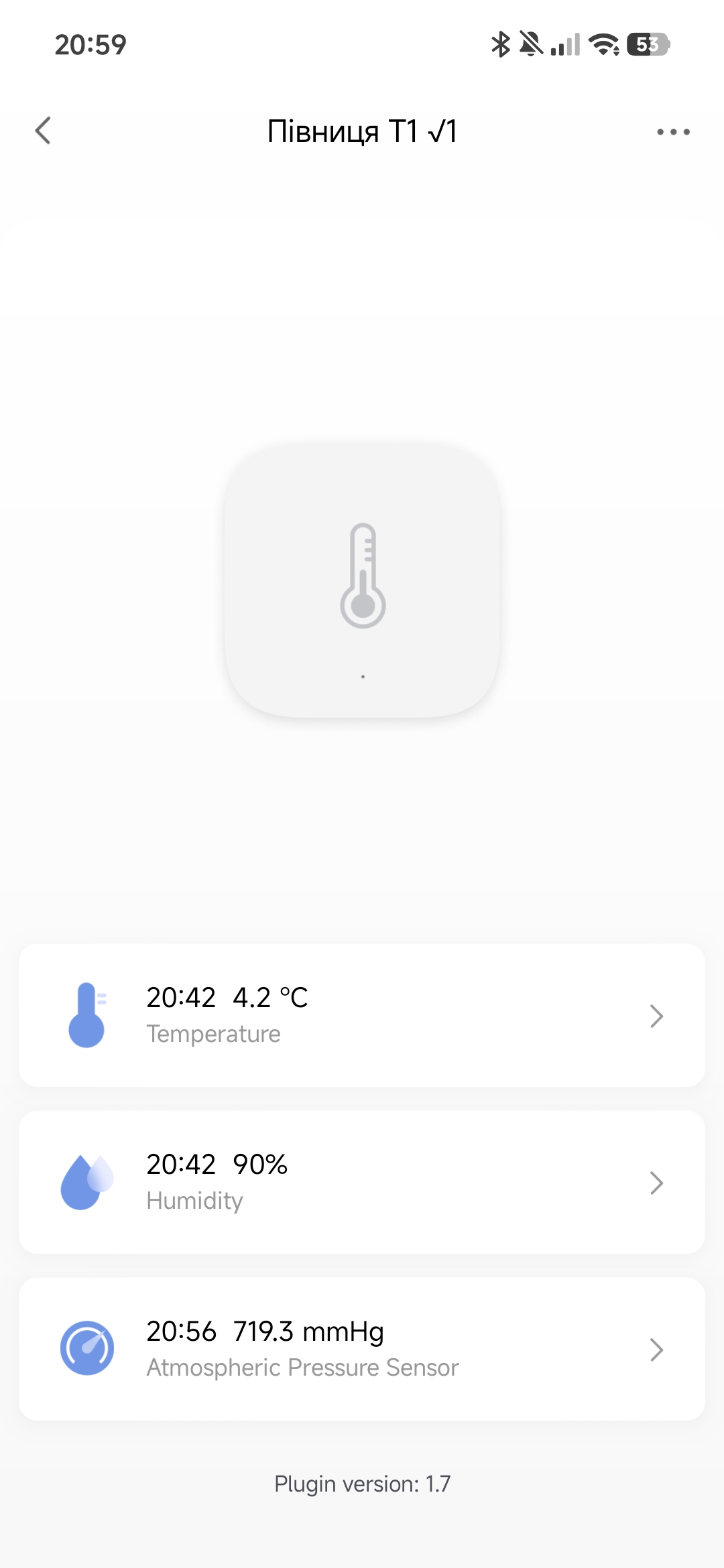

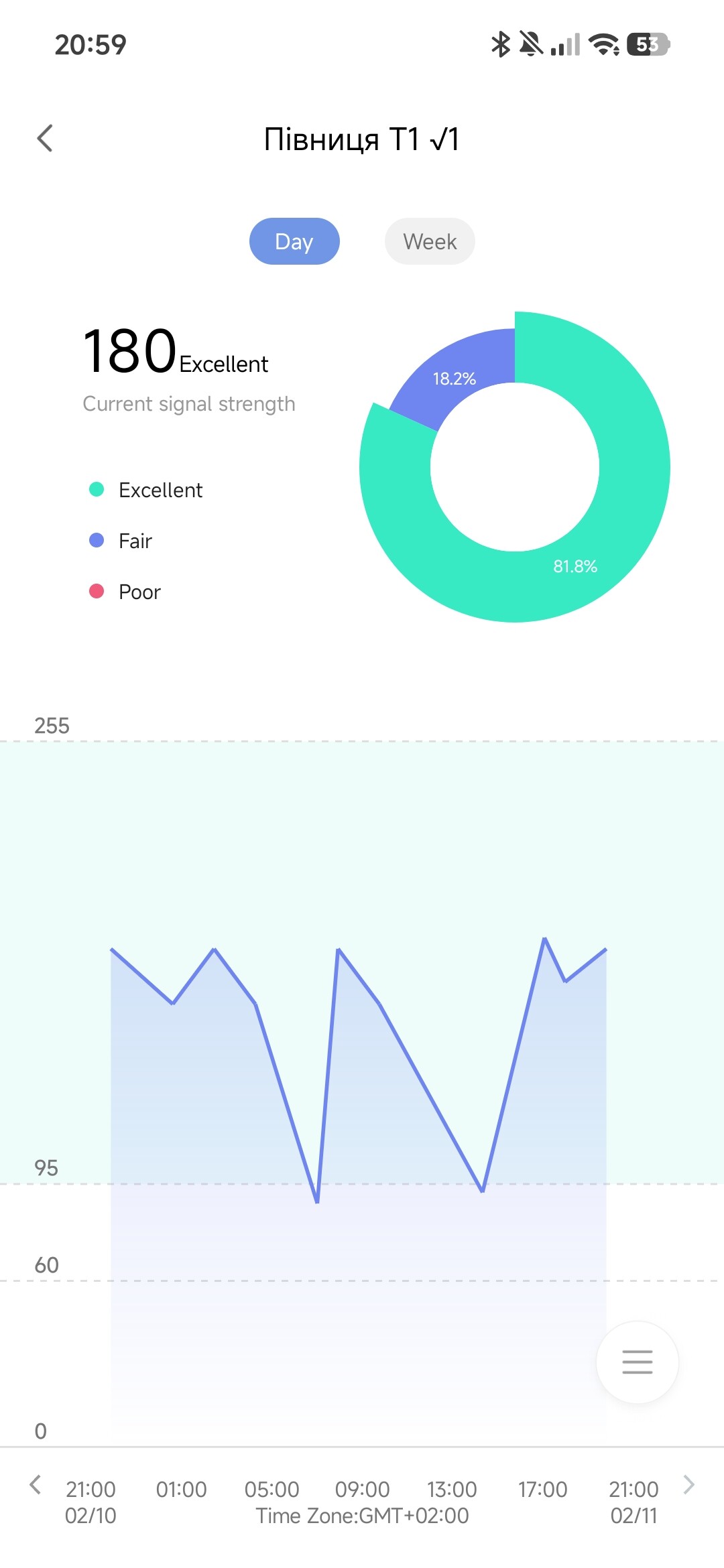

Hello, I recommend not choosing a place for the gateway, but installing an additional repeater to expand the network (Aqara devices that have phase, zero power). For example, I have temperature sensors placed in the backyard basement for storing vegetables, preservation. The distance from the M3 gateway to the T1 thermometer is 15 meters (triple wall of the backyard basement, two walls of the house) and the communication quality is excellent. I am specifically showing a screenshot of the signal from this thermometer. The relay is a socket or a T1 relay, I can’t say for sure because I don’t have a Zigbee card. I have repeatedly asked Aqara to provide us with this card.
