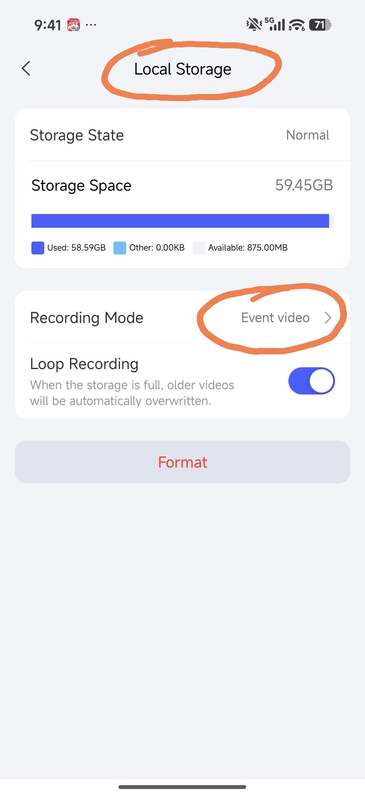

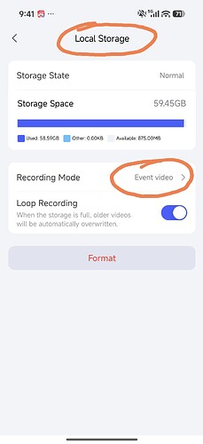

Among Aqara cameras, only the G5 Pro bypasses the SD card and directly performs NAS storage. Other cameras that support NAS functionality need to insert an SD card for file transfer, which means what the recorded content of the SD card is, and what data will be saved in the NAS. You can switch the recording mode to event recording as shown in the following figure, and the files saved in the NAS will be the same as those in the SD card.
NAS storage servers are third-party devices that we cannot directly manage. All we can do is control the types of record data before writing input into it.
