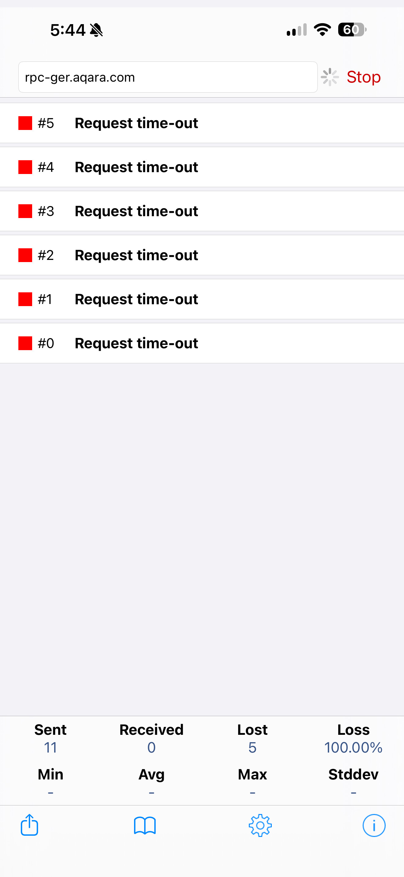

Can you try pinging the Aqara server at rpc-ger.aqara.com?
Here’s an app you can use:
I tried it. Connected to Starlink I can’t ping the server. Connected to an other wifi I can ping the server. So is it just an Aqara software problem at the
