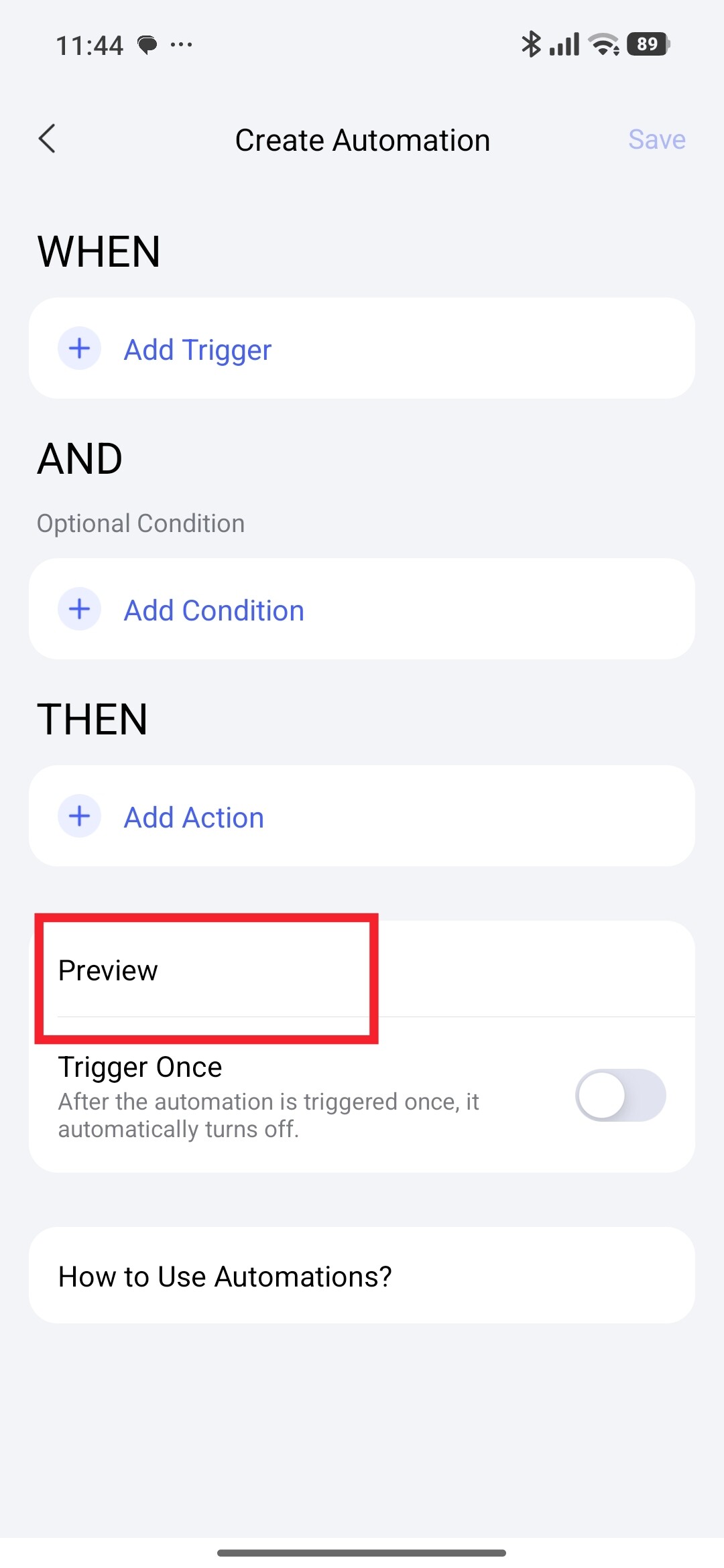

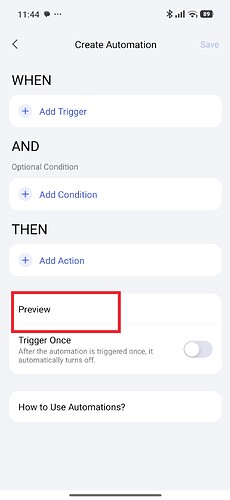

Hi, the best way is to make an automation (alarm alarm in the THEN section) and press the “preview” button. Then the sound will appear.
