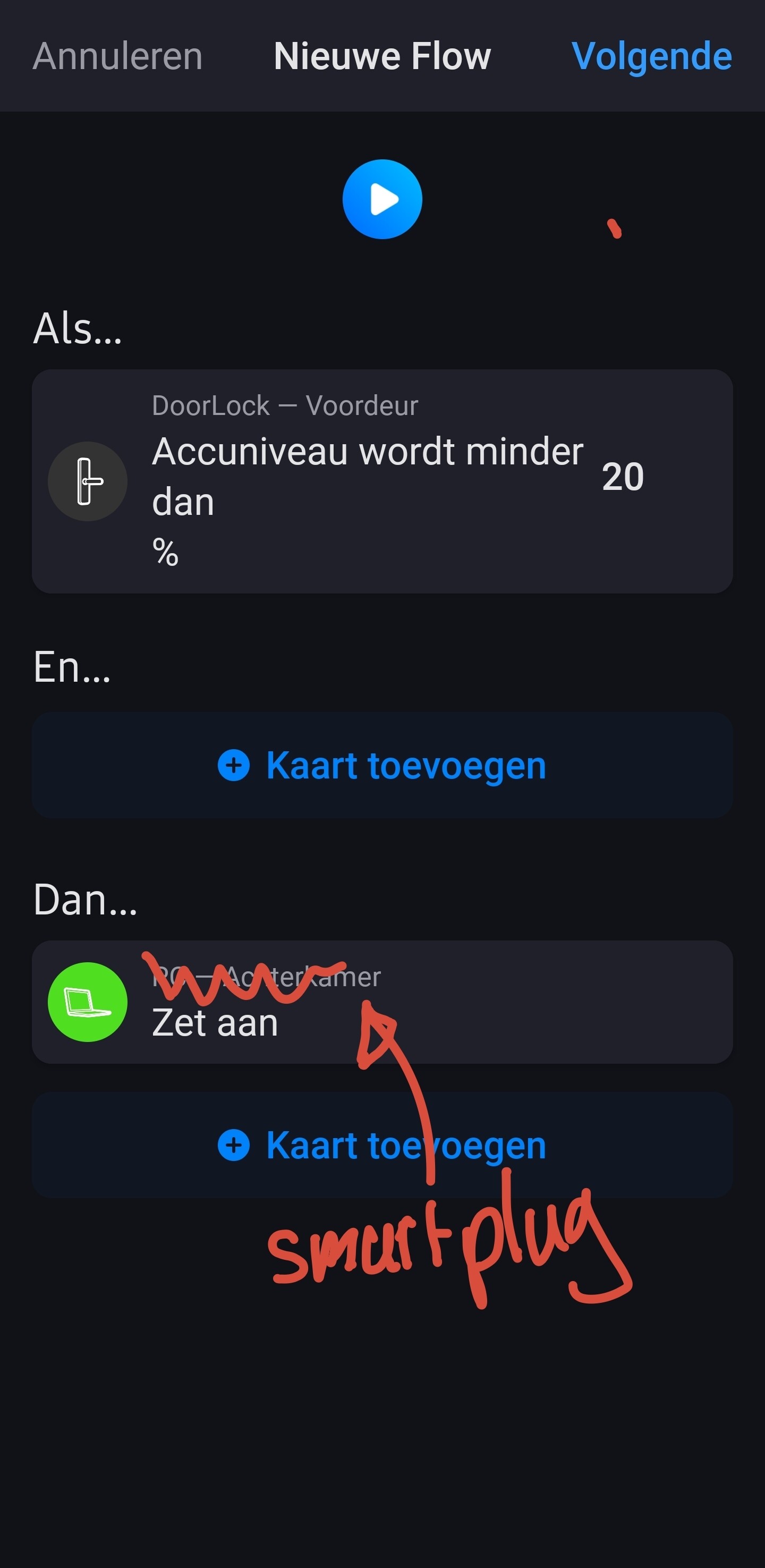

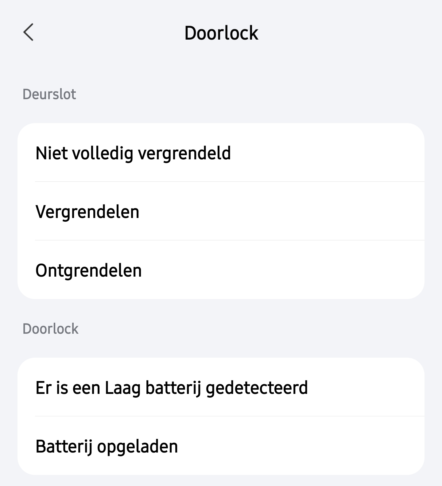

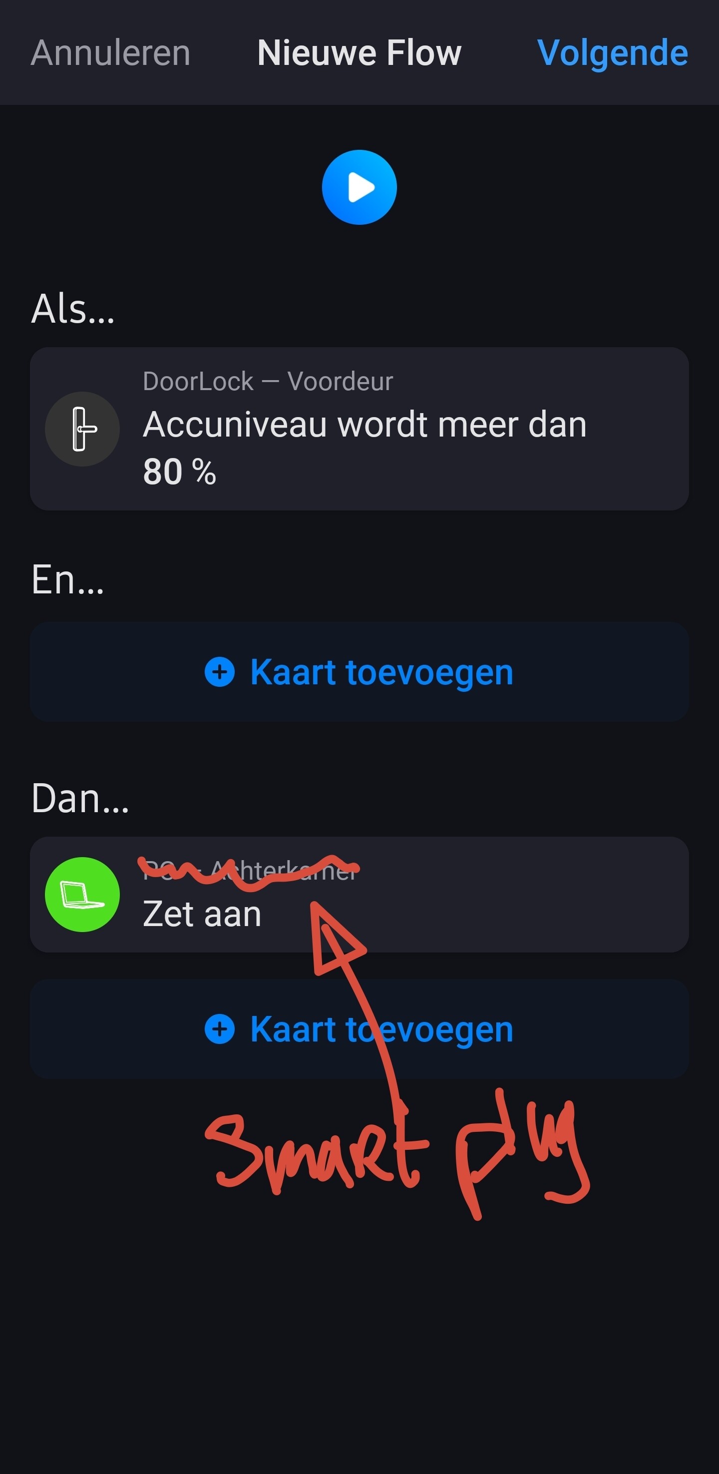

Ok, now going a bit more technical, if I make sure my USB cable is only charging when the battery is low, then it would be fine right? Like putting an Aqara smart power plug on the end of the USB and turning it on/off based on battery level
Seems a smart idea, however Aqara app doesn’t let you manage you battery percentage in %.
In my Homey Pro it does. So you can put a smartplug on when it’s down 20% èn out when reached 80%. This way the batterylife would improve while not fully drained or fully charged! :ok_hand:
