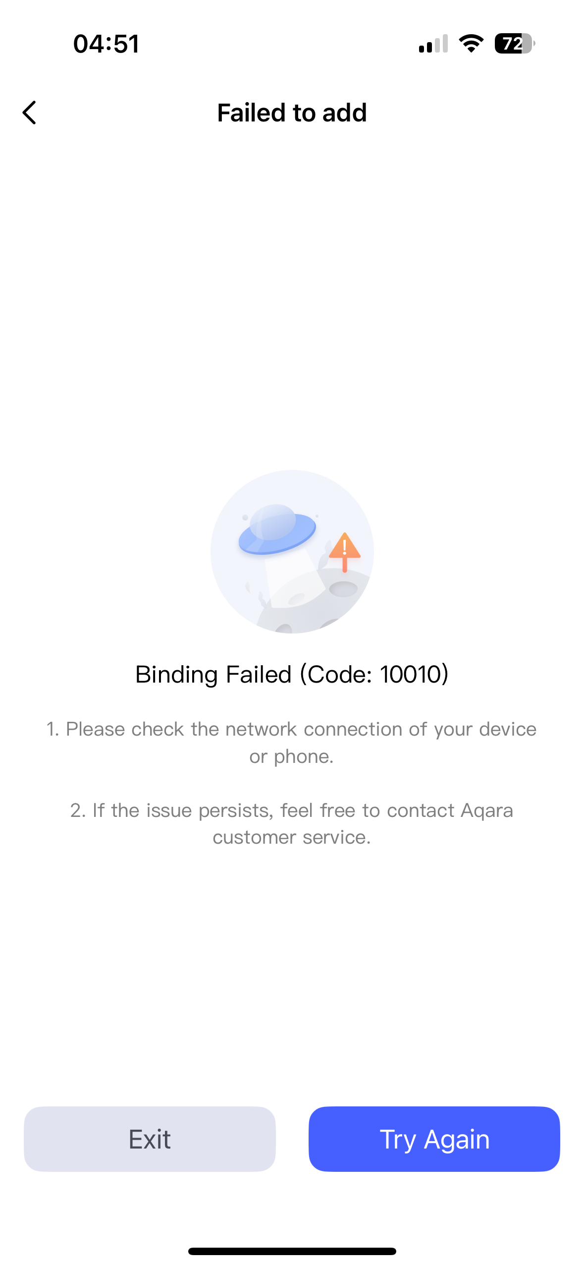

However when I try to add the same camera to Aqara’s Home app, it keeps failing.
Under “Add Accessory” the app automatically detects the camera and lists it at the top, then I proceed by scanning the Aqara QR code on the back. After a couple of seconds of trying to connect it fails with a “Binding Failed (Code: 10010)” error.

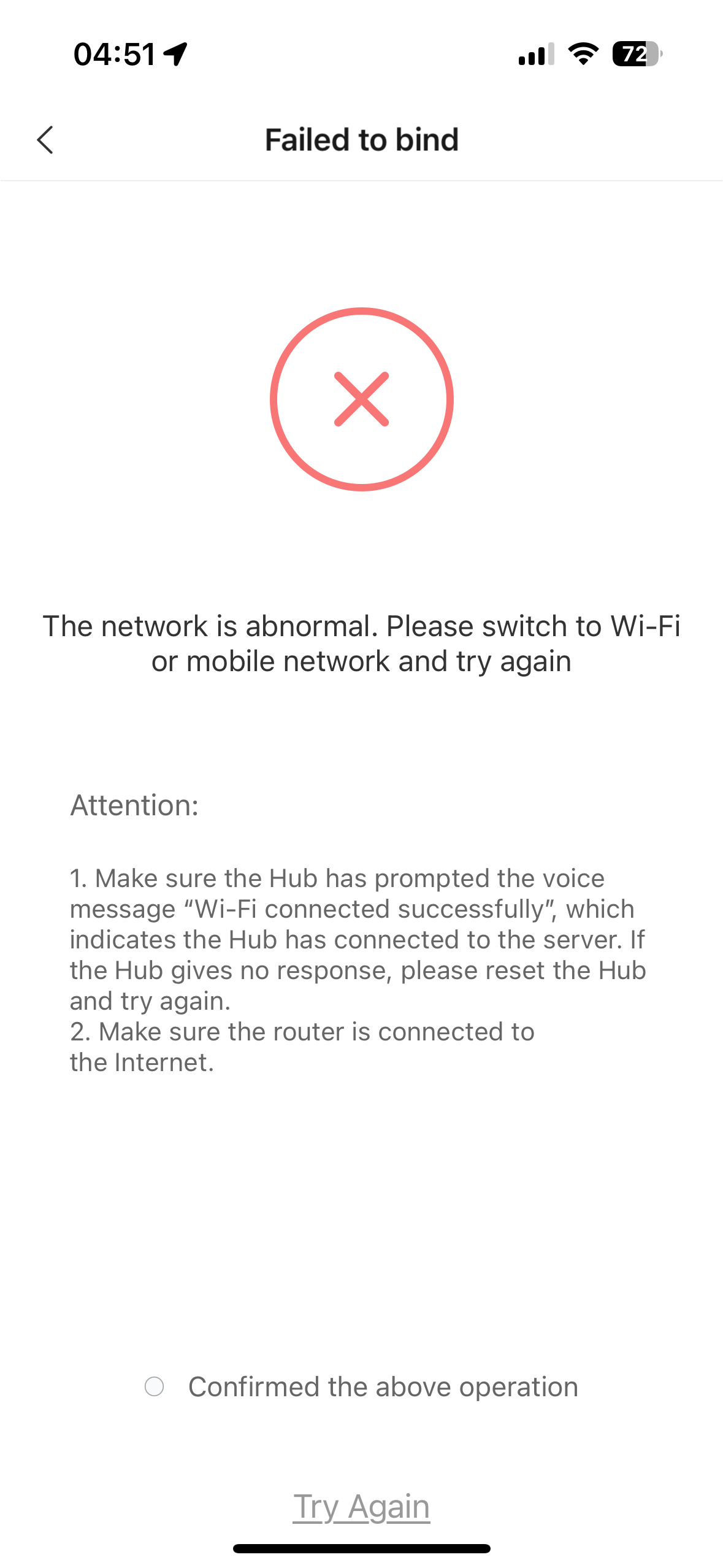

I also tried to add it via Profile → Connect to Ecosystems → Apple Home → HomeKit Devices.
The camera appears listed, but when I tap to “Bind” it, it gives another error:
This time it mentions a Hub. I do not have any hub, neither Aqara’s nor Apple’s. Could this be the problem?
