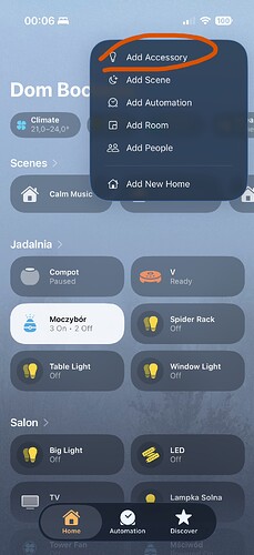

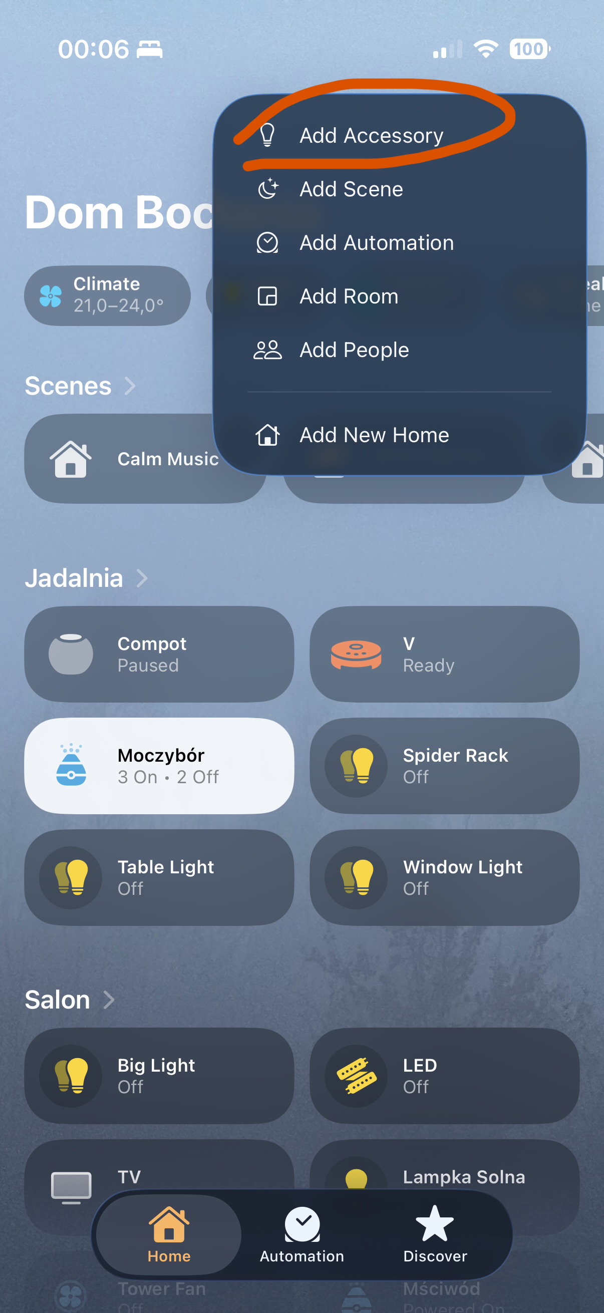

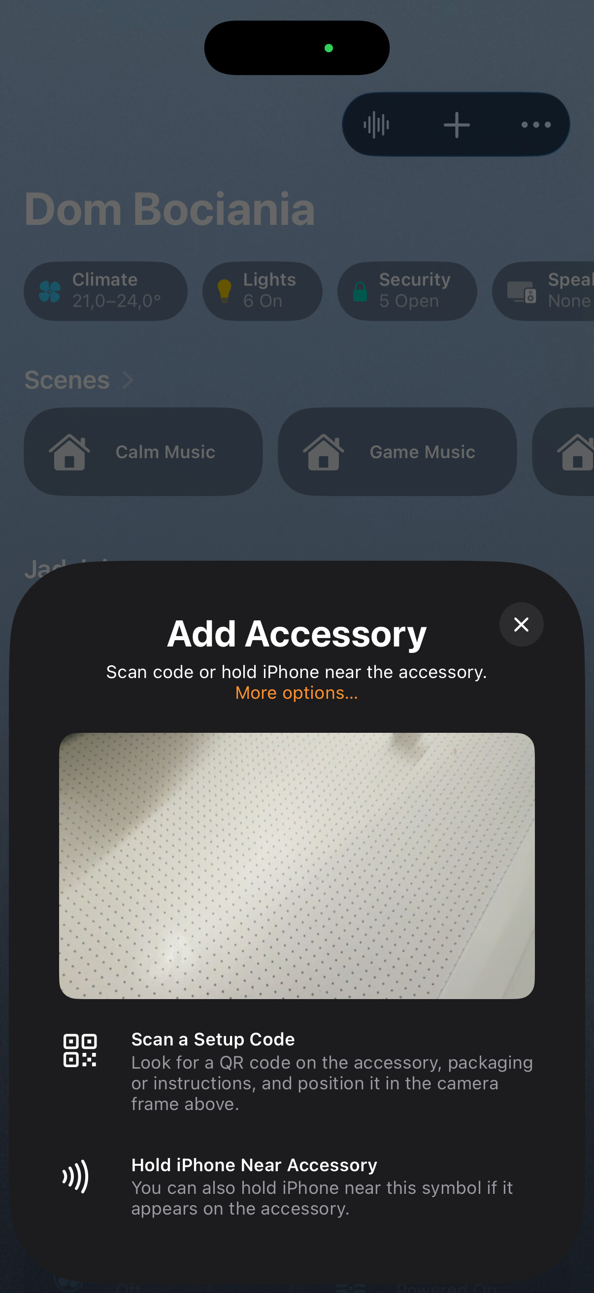

You didn’t tell me if you scanned the code in Apple Home or Aqara Home so I assume - if you don’t see the device in Apple Home, then you didn’t scan it in Apple Home.
Thread devices added to Aqara Home won’t be automatically added to Apple Home, you should add them in either app.

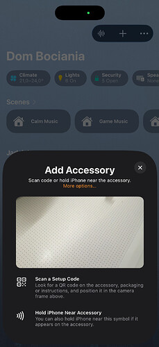

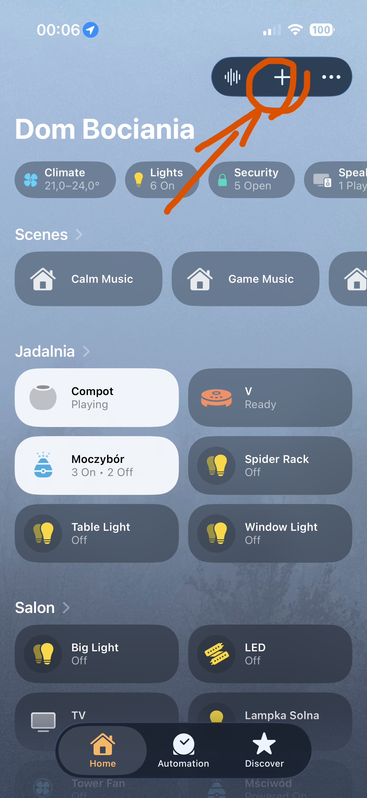

How to add the accessory in Apple Home:
Follow instructions on the screen to complete the setup.

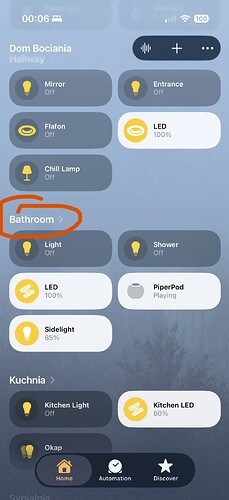

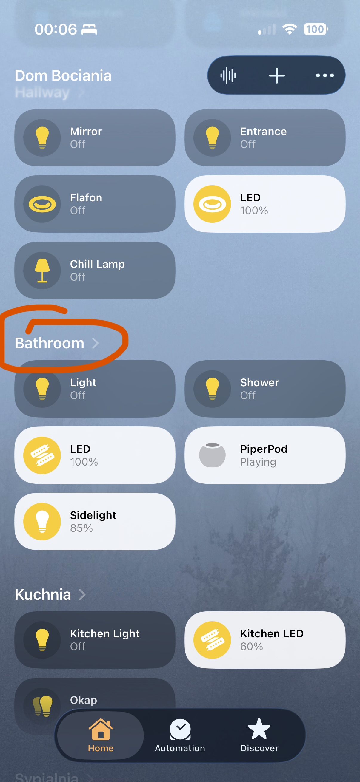

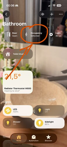

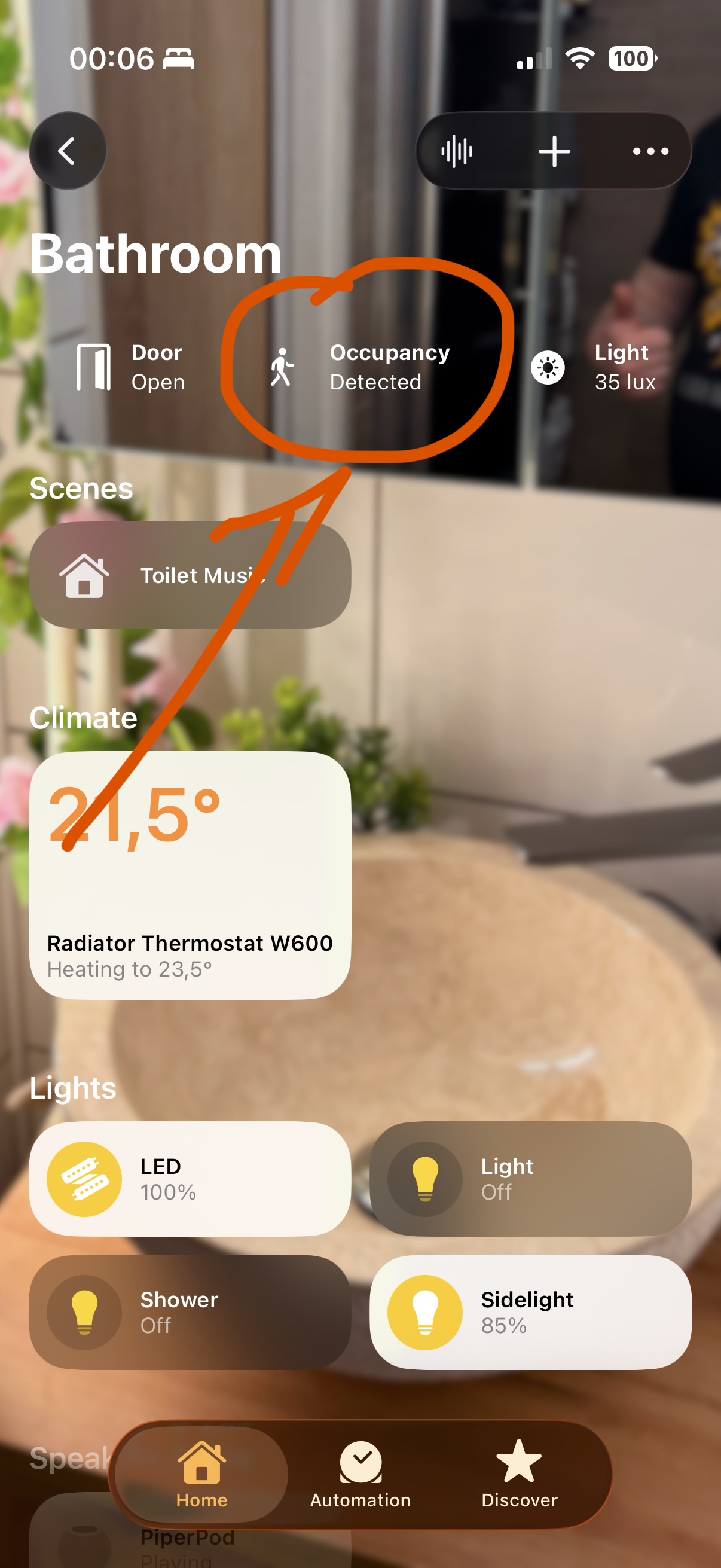

If you have completed the setup, then your device won’t be visible in the main Apple Home dashboard. It will be visible as “occupancy” in a room.
Sensors are not visible as tiles (unlike lights, locks, thermostats, TVs etc). Weird, I know, but it’s the Apple way.
Open Apple Home, tap room name and there it is!
Thank you! I was missing the last step in the last picture. I saw the figure of the guy walking and the Occupancy text, but didn’t know I was supposed to click it to set it up. Thought that was somewhere else I guess. Anyway - than you for your help!
I’m grateful! In the previous image, I was missing the final step. I was unaware that I needed to click the Occupancy text and the walking figure to set it up. I suppose I thought that was somewhere else. In any case, I appreciate your assistance!
Yep all sensors are showing like that on Apple home : temperatura and humidity ,motion sensor and presence sensor shows on the room you added them but there on top no with an card on the main home page like on aqara home app.its a bit odd but I think Apple wanted to simplify the home page on the Apple home app
