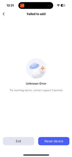

  • Put magicpair QR code → “Unkown error” “try resetting device, contact support if persists”, see pic 1

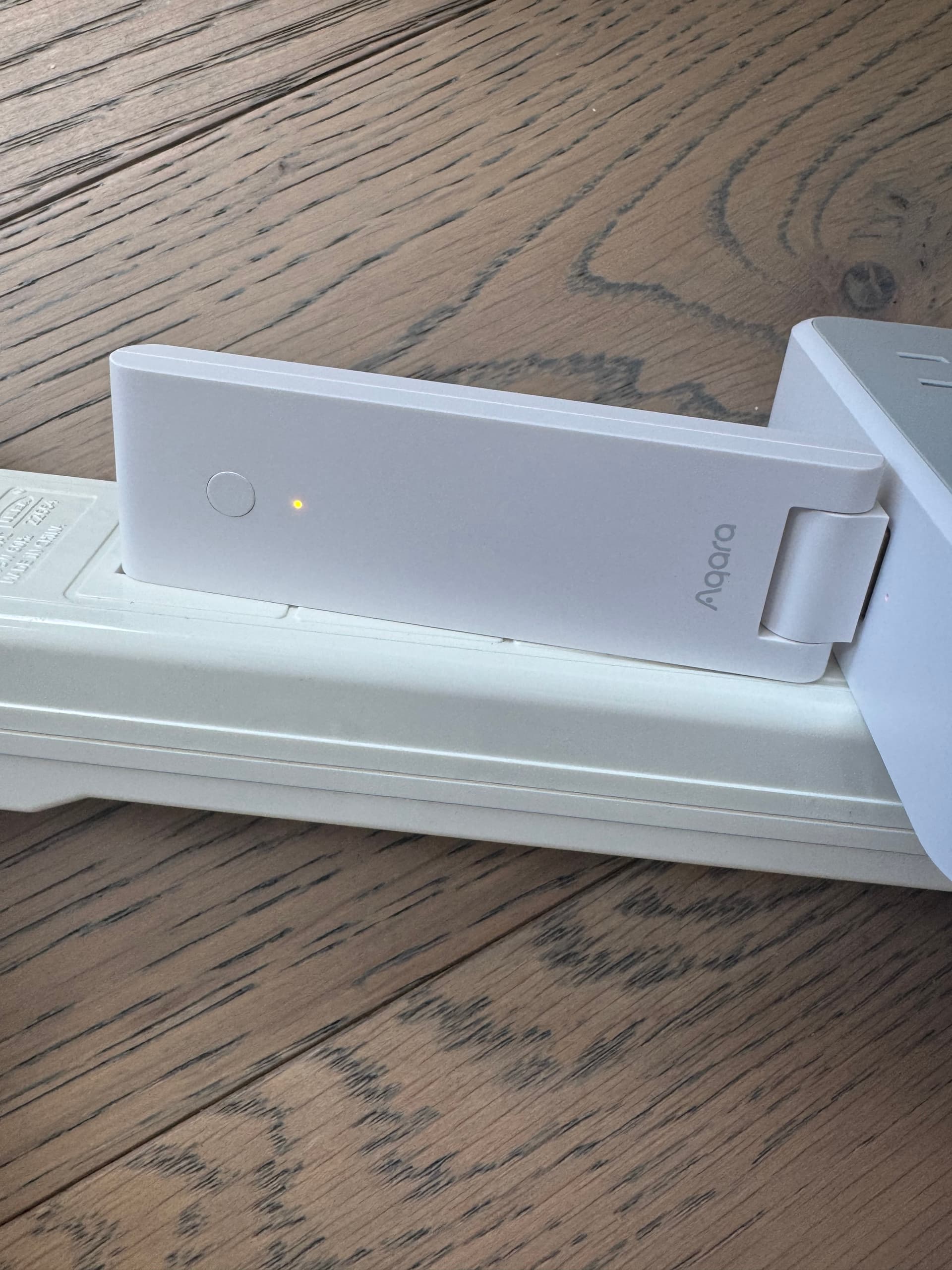

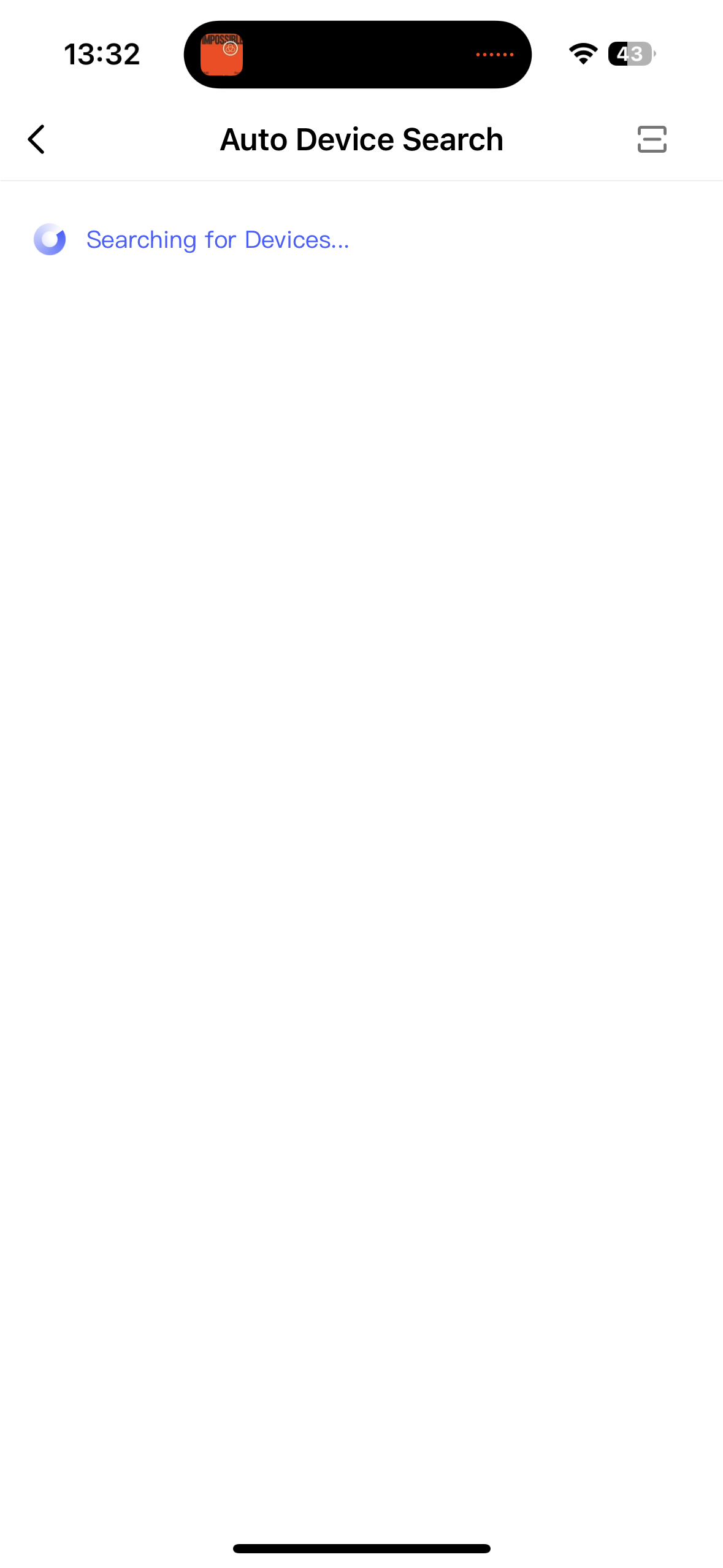

  • Selecting m100 from list of devices → “searching for devices” and nothing is found. The device is flashing yellow. - pic 2 and pic 3

Make sure that you are using a 2.4 GHz wifi, and if possible, turn off the 5 GHz wifi for a while.
Try changing the region to US and making sure that the hub is detected in the magic pair.
If the options I have suggested do not work, please contact customer support support@aqara.com . It is possible that the hub cannot be used in the Mainland China region due to regional restrictions, or that it is stuck on a server in China.
Customer support will provide you with professional assistance.
Thank you I’ll contact support. I did try to limit router to 2.4 G only. And if change region back to US it immediately works…
I think it’s because of regional restrictions on the hub. Please let me know when you get an answer to this question. Very interesting. :handshake:
@aqaranewbie The Mainland China version of the M100 Hub can only connect to Mainland China servers; the overseas version of the M100 Hub can only connect to overseas servers and cannot connect to Mainland China servers.
