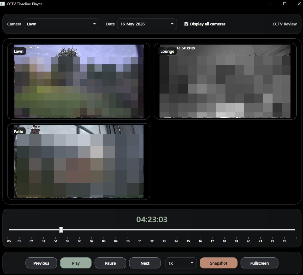

Hi all,
I’ve been looking for a simple way to scrub through the NAS video files produced by these cameras. While full NVR solutions like Shinobi or Frigate are excellent, they feel overly complex for my needs and include far more features than I require.
I’m already very happy with the Aqara ecosystem , the app performs well and the alerts work great. What I really wanted was a lightweight way to browse and review the one-minute MP4 files the cameras save directly to the network.
After searching around and not finding anything suitable, I decided to Chat GPT a PowerShell based solution. It uses the network path, folder names, and file names together with a timeline scrubber to create a simple pseudo-CCTV viewing application.
Features
  • Connects directly to your NAS/network folder locations
  • Assigns custom labels to each camera
  • Date folder dropdown selection
  • Draggable timeline scrubber
  • Ability to display all cameras simultaneously
  • Timeline defaults to the current time minus 5 minutes
Setup
Simply edit your NAS locations and camera labels in the Camera Configuration section of the PowerShell script.
# CAMERA CONFIGURATION
$script:cameras = @(
    [PSCustomObject]@{
        Name = "Label 1"
        Path = "\\NAS\camera\aqara_video\lumifolder1"
    [PSCustomObject]@{
        Name = "Label 2"
        Path = "\\NAS\camera\aqara_video\lumifolder2"
    [PSCustomObject]@{
        Name = "Label 3"
        Path = "\\NAS\camera\aqara_video\lumifolder3"
You can also convert the PowerShell script into an executable using the following commands as examples:
Install-Module ps2exe -Scope CurrentUser
Invoke-ps2exe -inputFile "C:\Security Camera\Camera_CCTV.ps1" -outputFile "C:\Security Camera\Camera_CCTV.exe" -noConsole
Disclaimer: I am not a programmer, only knowing basic Powershell. This has been vibe coded by AI. It is running in a Win 11 environment.
Kind Regards, Doug
Camera_CCTV.txt (54.7 KB)
