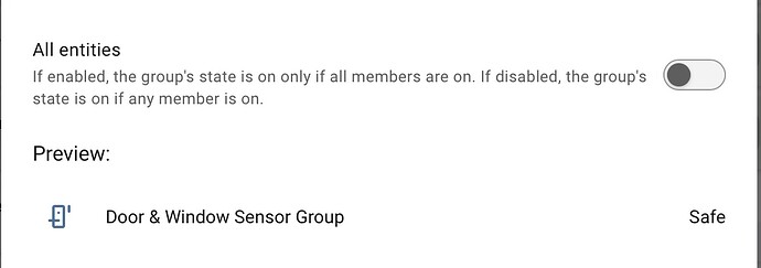

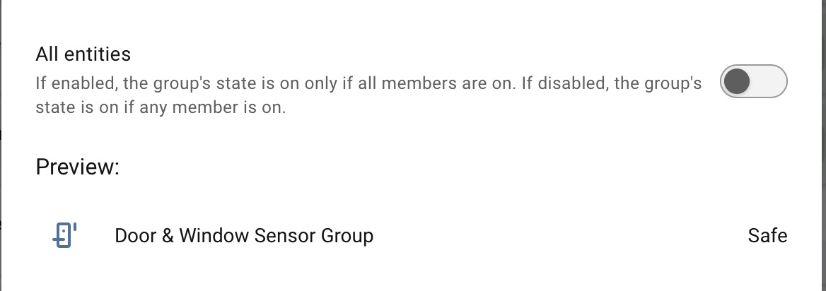

Thanks @srl77411, unfortunately changing the way it’s displayed doesn’t change its behavior, but just how it’s shown. It stays a binary sensor.
Creating a group helper didn’t help either. In fact, creating even a group of 1 binary sensor doesn’t even reflect the on/off state on the helper.
