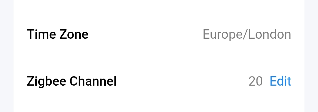

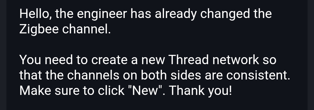

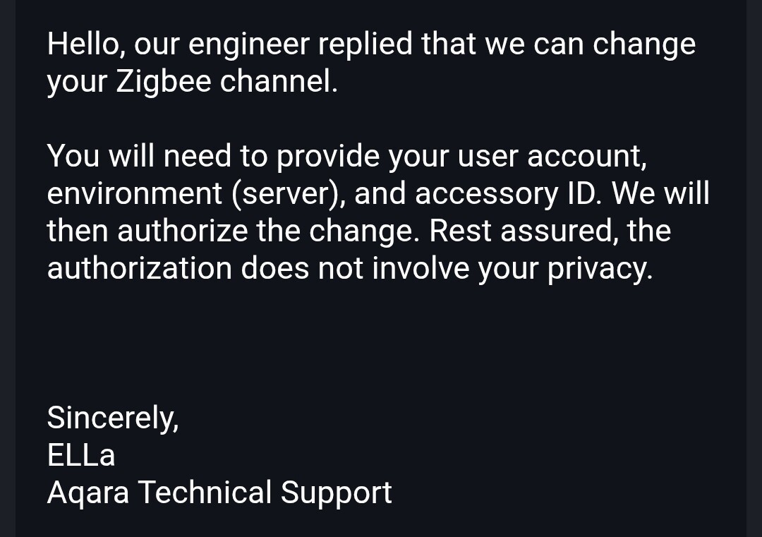

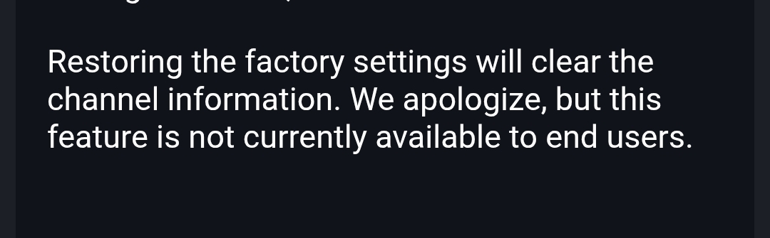

Support can change your ZigBee and thread channels for you, open a ticket.
If you factory reset it in future, you will have to ask them again to change your channel.
Beware that you will have to repair all your thread and ZigBee devices after changing channels.
