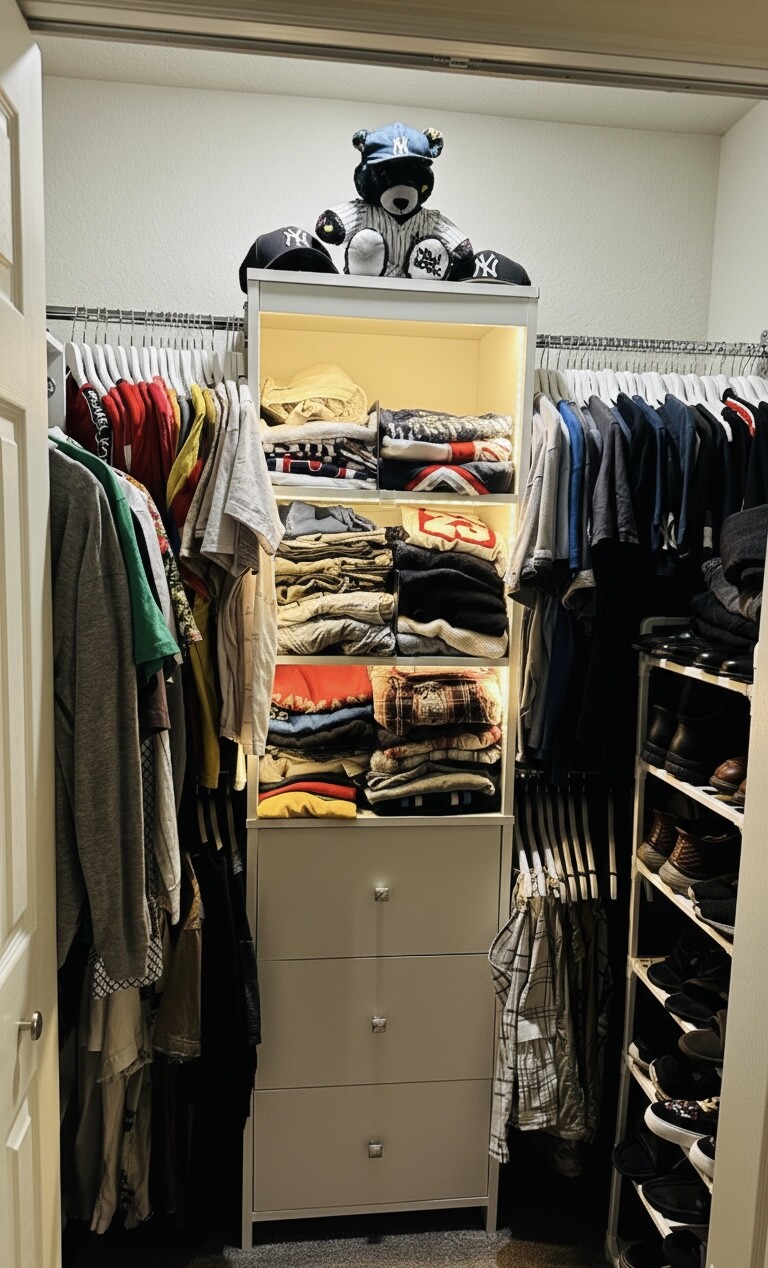

I wanted to share a recent project where I used Aqara gear to automate the lighting in my closet, and honestly, it turned out better than I expected.

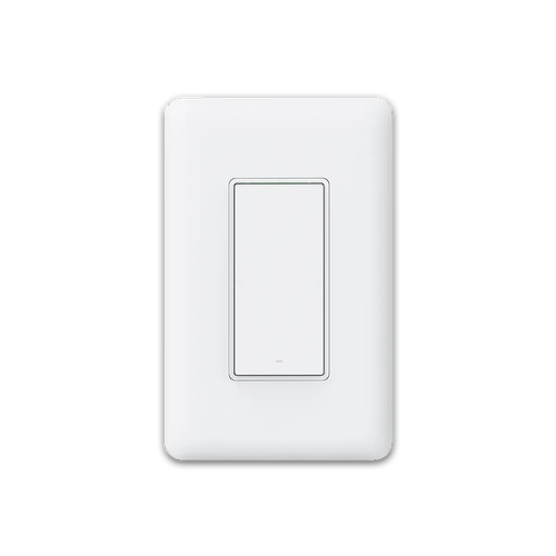

The setup starts with an Aqara Light Switch mounted on the outside of my closet. That switch controls the main overhead closet light.

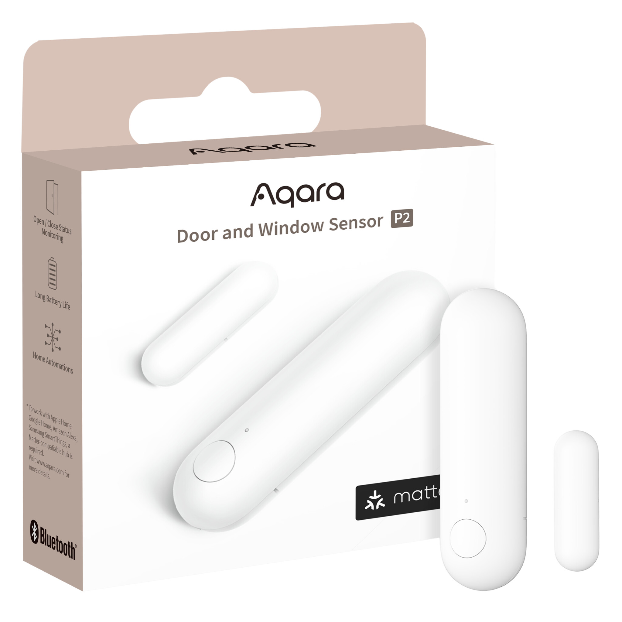

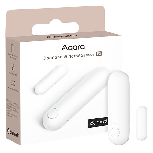

My closet has bi-fold doors, and I placed an Aqara Door & Window Sensor right where the doors split in the middle. That sensor is the key to the automation.

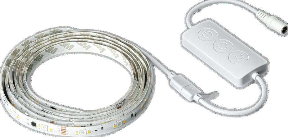

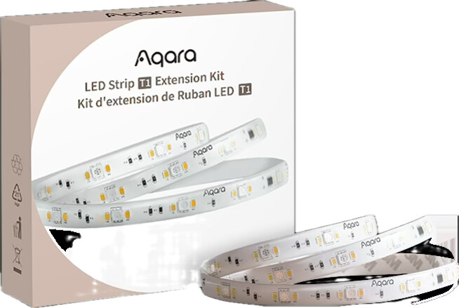

Inside the closet, I added Aqara LED Strip T1s along with LED Strip T1 Extensions. I installed them in two main areas. First, inside the open shelving of my closet system. Second, along the wall that runs parallel to the clothing rods where everything hangs.

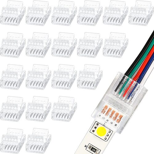

Using a few connectors and some wire I bought online, I was able to break-up the strips into sections. That let me put light exactly where I wanted it and leave areas dark where lighting didn’t make sense.
The automation is simple but very effective. When I open the closet door, the Door & Window Sensor triggers both the main closet light and all of the LED strips to turn on at the same time. No reaching for switches, no fumbling around in the dark.
I haven’t done it yet, but when I’m feeling a bit more motivated, I plan to add additional LED strips inside the drawers so they light up automatically when opened.
The end result is pretty impressive. Opening the closet makes everything light up instantly, and it gives the whole space a very high-end feel. It’s one of those automations that feels both practical and a little bit luxurious, even though it’s built from relatively simple components.
If anyone is thinking about upgrading a closet or similar space, I’d definitely recommend trying something like this with Aqara’s switches, sensors, and LED strips.

Would you mind sharing what connectors you used to create the breaks in lighting?
My closet is hard-wired, but I did put in some night lighting in my bathroom where I don’t have access to a convenient outlet. I used the following:
  1. Aqara LED Strip T1
    *Depending on your needs, you can extend the strip up to 10 meters with the T1 extension kits (sold separately). The 10 meters is based on being able to plug into an outlet. What I am suggesting will be using a battery source, which may limit the maximum length. Depending on your needs, you would have to test and see.

In place of the Aqara power plug, you would connect the adapter to the LED’s barrel plug and connect the USB side to the UPS or a Power Bank.
Since mine is used as a night light in the bathroom that is triggered by an Aqara Motion Sensor under my bed when I get up in the middle of the night to use the restroom, the light is set to a warm white at a very low level. As a result, it will probably be months before you ever have to charge it. But, I guess it depends on how often you get up in the middle of the night. My automation will also only trigger the light if my third party ambient light sensor indicates that the light level is under a certain lux level.

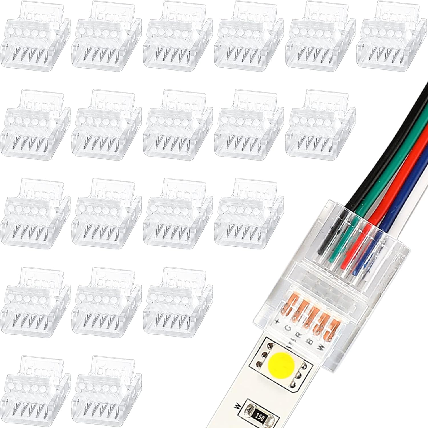

I would recommend the following cables and connectors if you need to extend. If you look online, you can find some cables that already have the connectors built-in. However, they come in fixed lengths. The roll of 5-pin ribbon/cable gives you more flexibility.
-LEDENET 22AWG 5pin 33FT 10M RGBW Electrical Extension Cable
https://a.co/d/0gMxruT
-Flutesan 20 Pcs 5 Pin 12 mm LED Strip Connector
