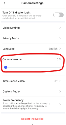

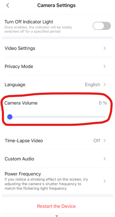

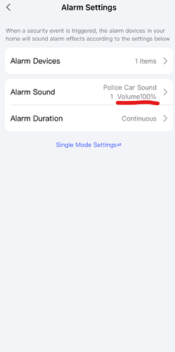

OK, I found a solution myself in the meantime. If you set the camera to 0% volume and set the alarm to 100% in the alarm system settings, no confirmation tone will be emitted when the alarm is activated or deactivated. However, the alarm tone sounds when the alarm is triggered.
It would be strange if you couldn’t deactivate this on an outdoor camera, otherwise your neighbours would always know when you turned the alarm on or off.
