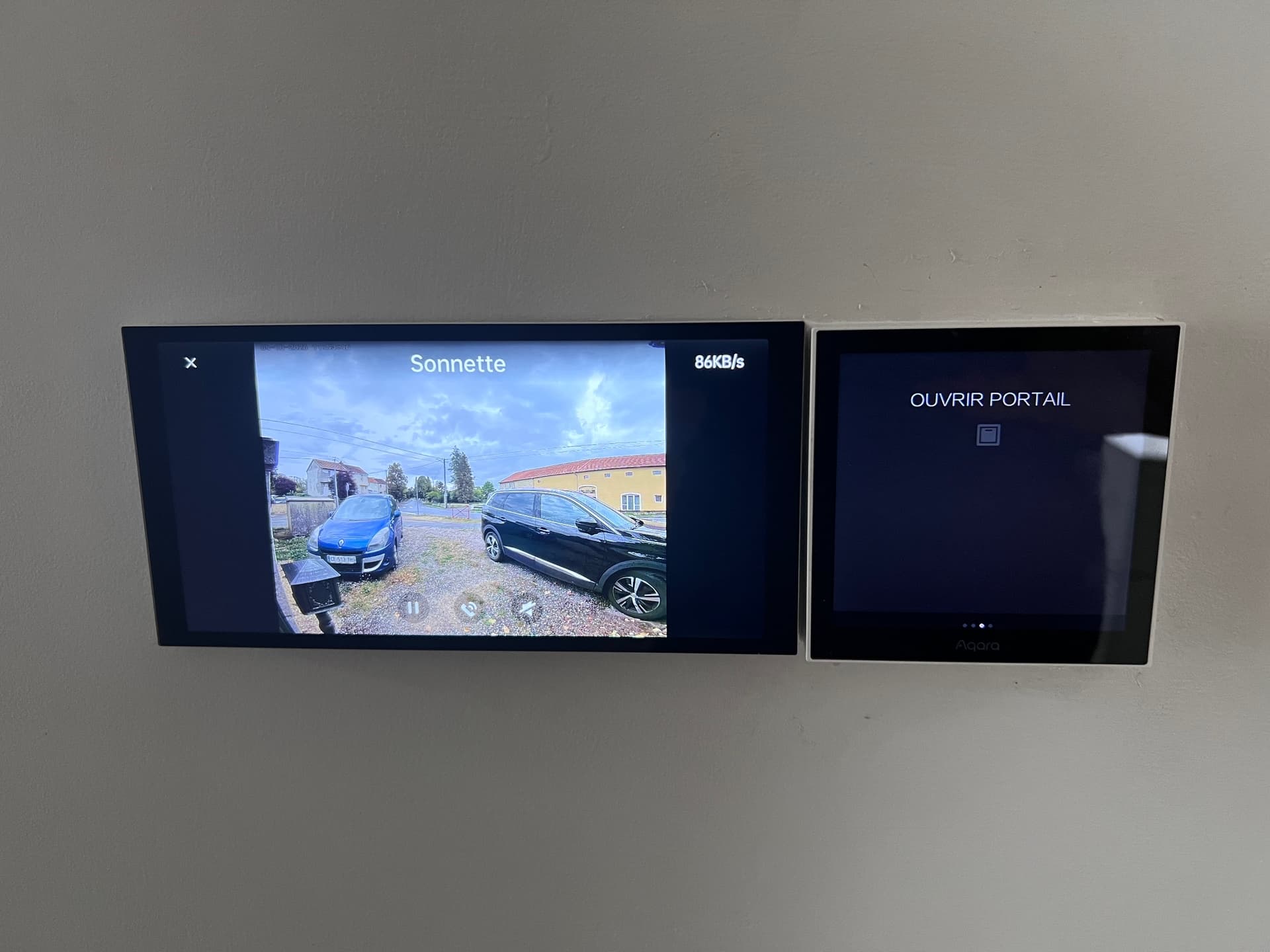

I have the same need here.
G410 connected to a T2. Panel Hub S1 Plus allows me to get feedback from the G410. But in full-screen mode, unfortunately, I can’t open my portal. Currently, as a workaround, I installed an S1 panel right next to the Panel Hub S1 Plus with a scene that controls the opening of the gate.
