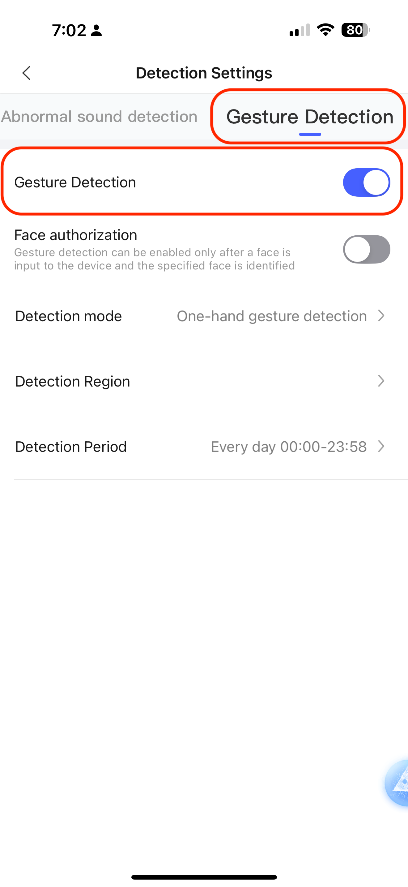

Enable gesture detection
- In Aqara app, in camera settings, click on Device Settings → Camera Settings → Detection Settings.
- Choose Gesture Detection tab and enable Gesture Detection.

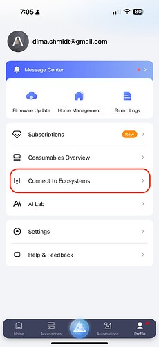

Create signals that will be exposed to Home Assistant via Matter protocol by Aqara Hub.
Go all the way back to the home screen of the app, and switch to Profile tab.
Click AI Lab → Connect to Ecosystems and click on Home Assistant, Scene and Signal Sync, Signal Management.

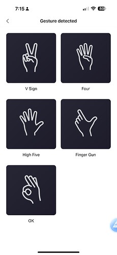

- IF: Choose the camera with enabled gesture detection, then Gesture detected.
- Click gesture from the picture.
- Click Save.
- Repeat process for every gesture you want to see in Home Assistant.
