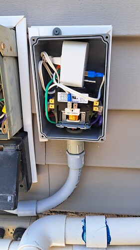

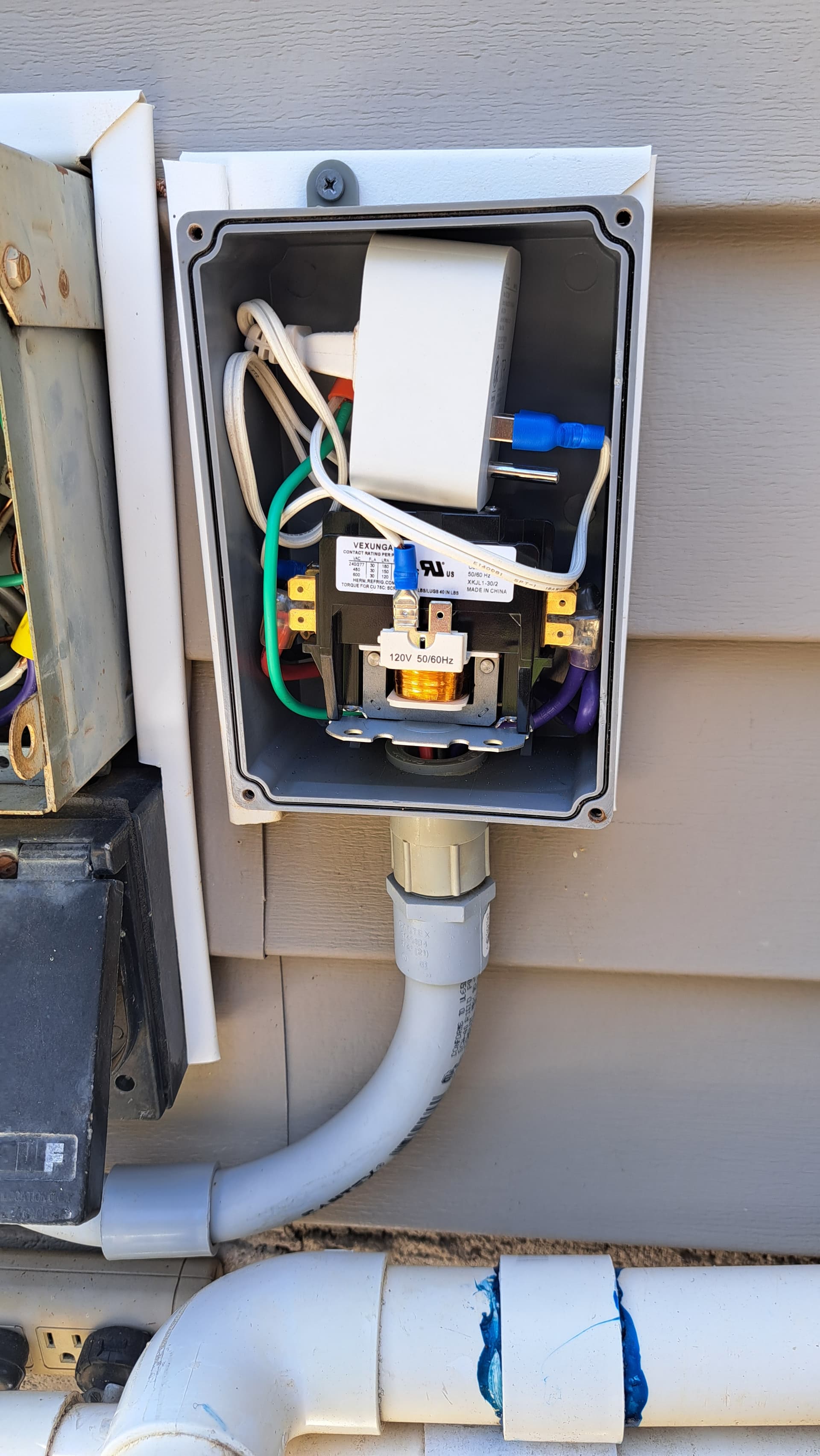

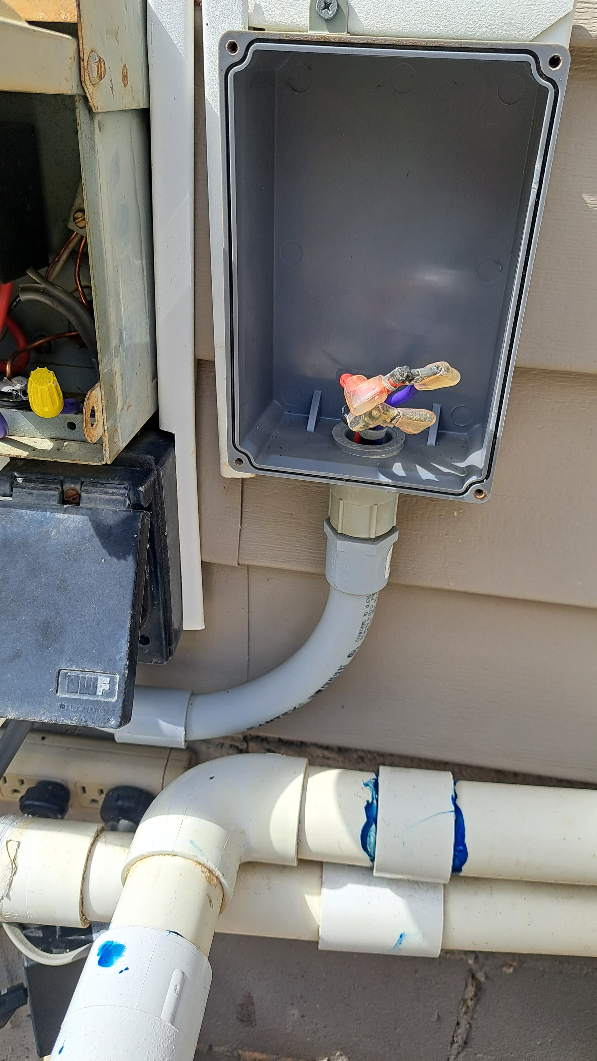

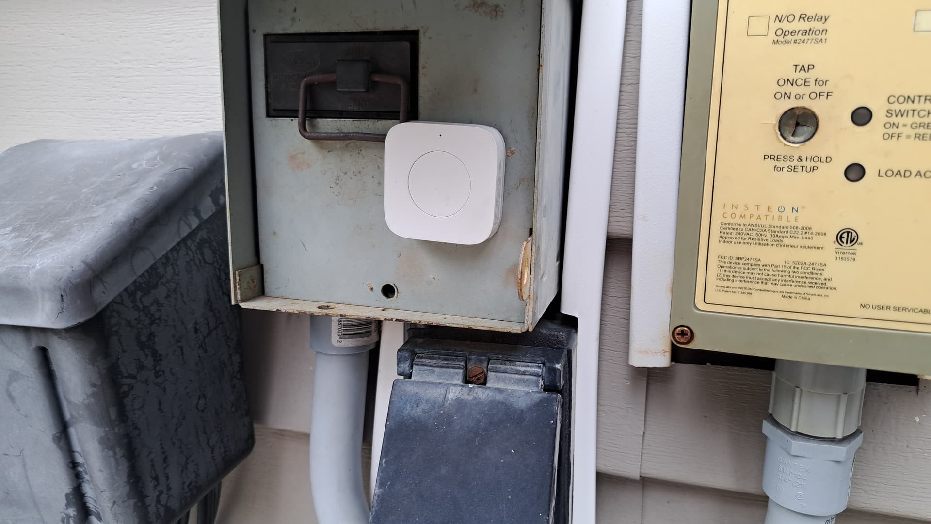

My old Insteon pool pump controller bit the dust. The easiest solution for me was to build a new controller using a 120v Aqara plug a 220v 40 amp double pole relay with a 120v winding. I used the old enclosure from my Insteon setup to make things easy. After installing the new setup I realized it would be easier to turn the pool pump on and off with a local switch rather than using my app, for backwashing and such, this led me to the Aqara button for this task. I have been using this setup since July and it works flawlessly. I have an automation setup in Home Assistant that takes care of daily filtering. This setup will also work for a water heater automation. Pictures are attached.
