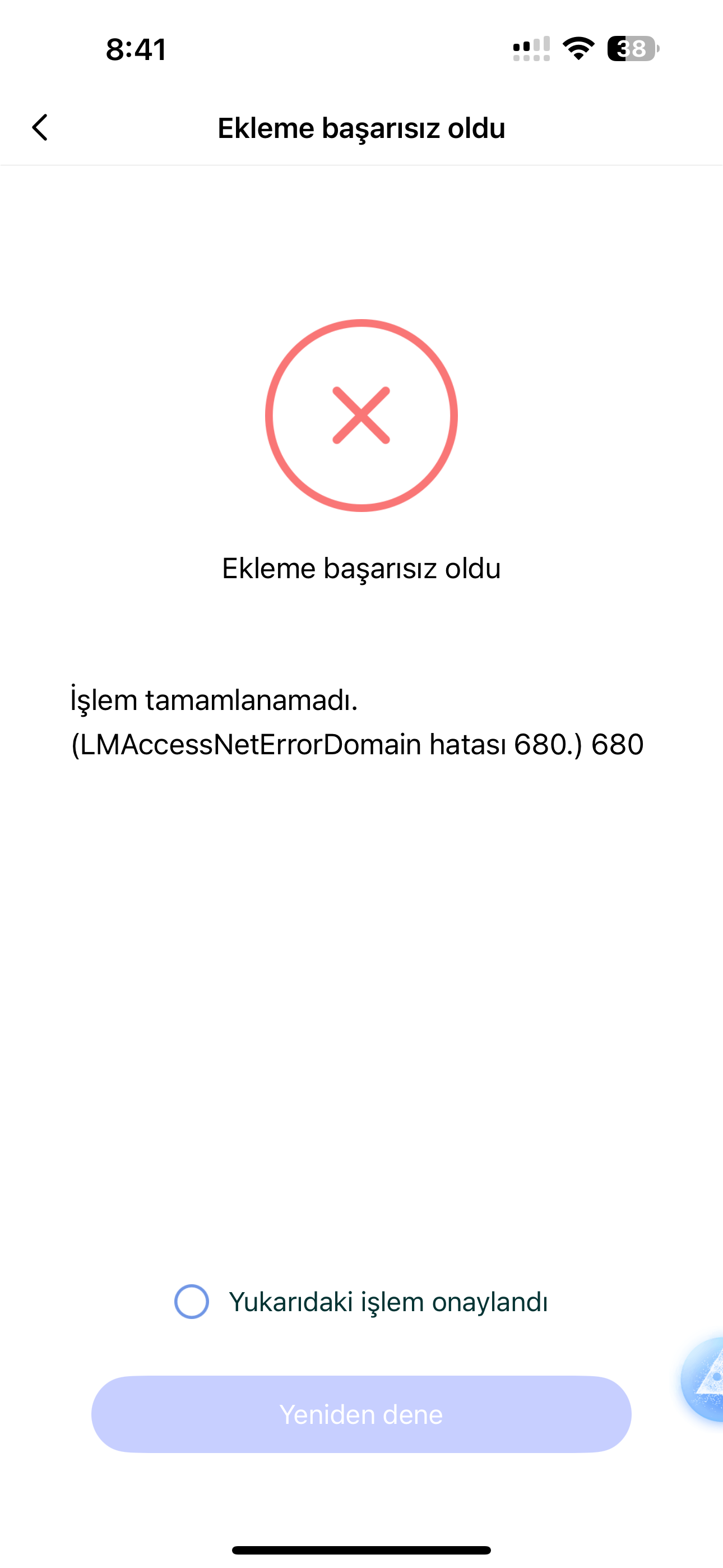

When I press it 10 times, it flashes with a yellow-greenish light and then turns off, but nothing else happens.
When I hold the button down, it resets, but I can’t complete the setup — it gives an error.

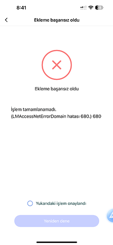

I shared the video with a link — I hope you can watch it. But in my last post, I sent the error code. The device is stuck and needs to be removed from the account, but the device is not visible in my account, even though it belongs to me. I believe Aqara support needs to remove it from their end. If there is a way to do this, please let me know.

I have found important clues from the video you provided. The app prompts “680 error code”, and another user in the forum has encountered the same problem as you (I have provided a link below). Regarding the reason for this problem, I have explained it in my previous post. If the camera is a legitimate device that you have been using, please contact Aqara customer service based on your purchase history or invoice to unlock your cloud account.
