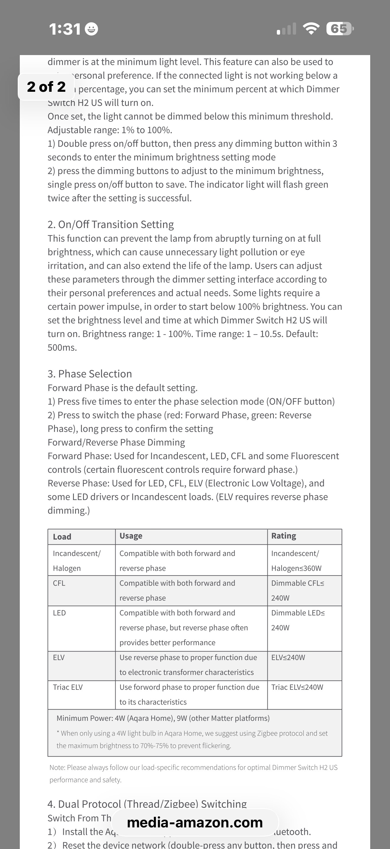

Maybe try to set it up in reverse phase.
