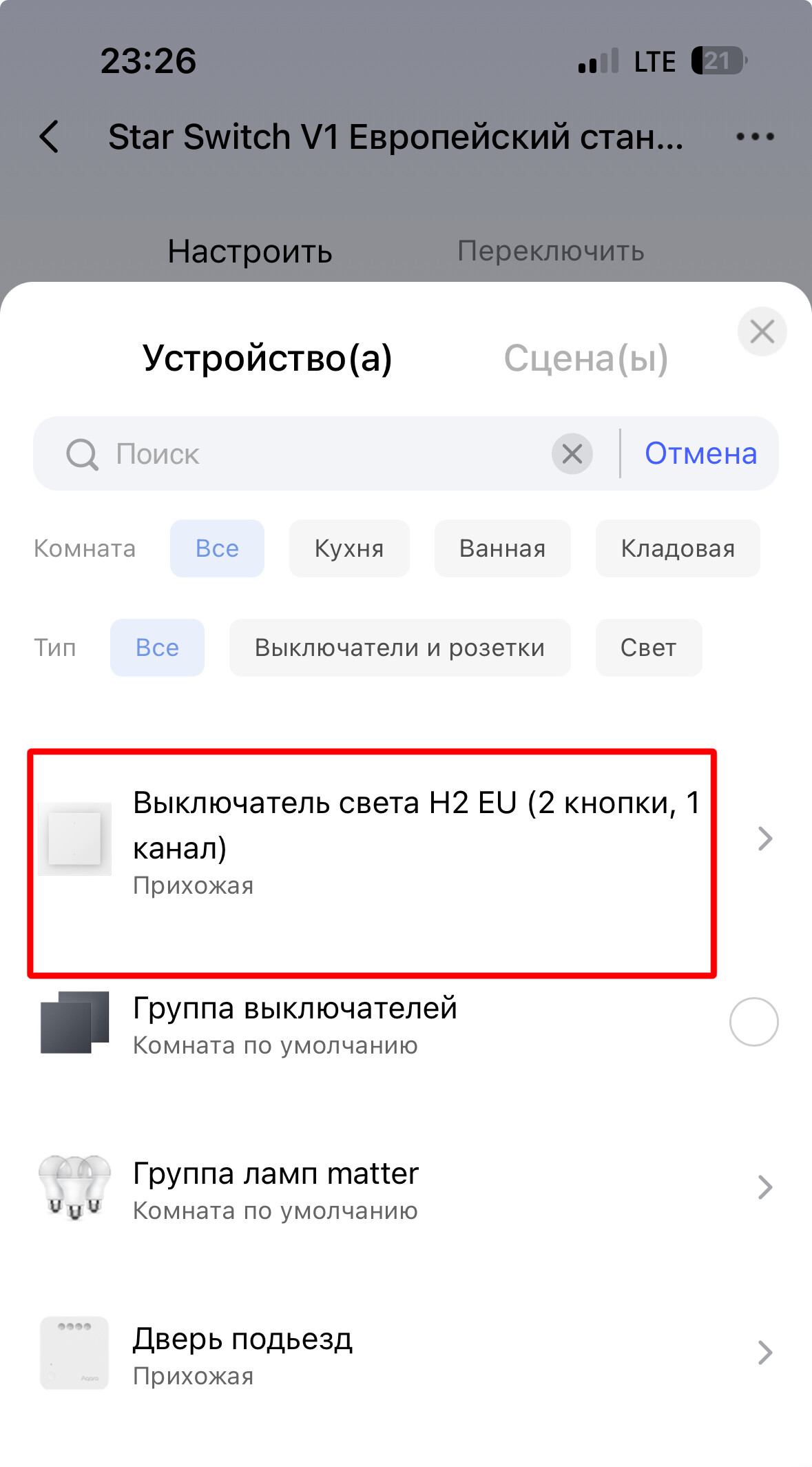

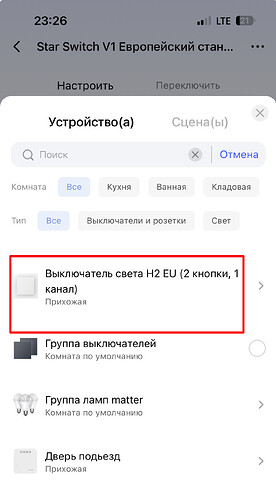

Unfortunately, you won’t be able to directly connect with matter devices, only through automation or switch your devices to zigbee mode and you can add them in the V1 settings.
