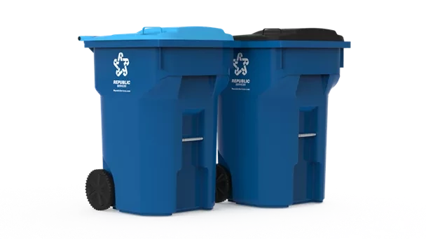

Hello, please give me the type of tank, preferably a photo.
Depending on the design of the tank, there are different answer options.

The bins?
I logged into Republic Services,
Trash 96 Gallon
Recycle 65 Gallon
Photos Linked- Sorry for Quality
Similar
