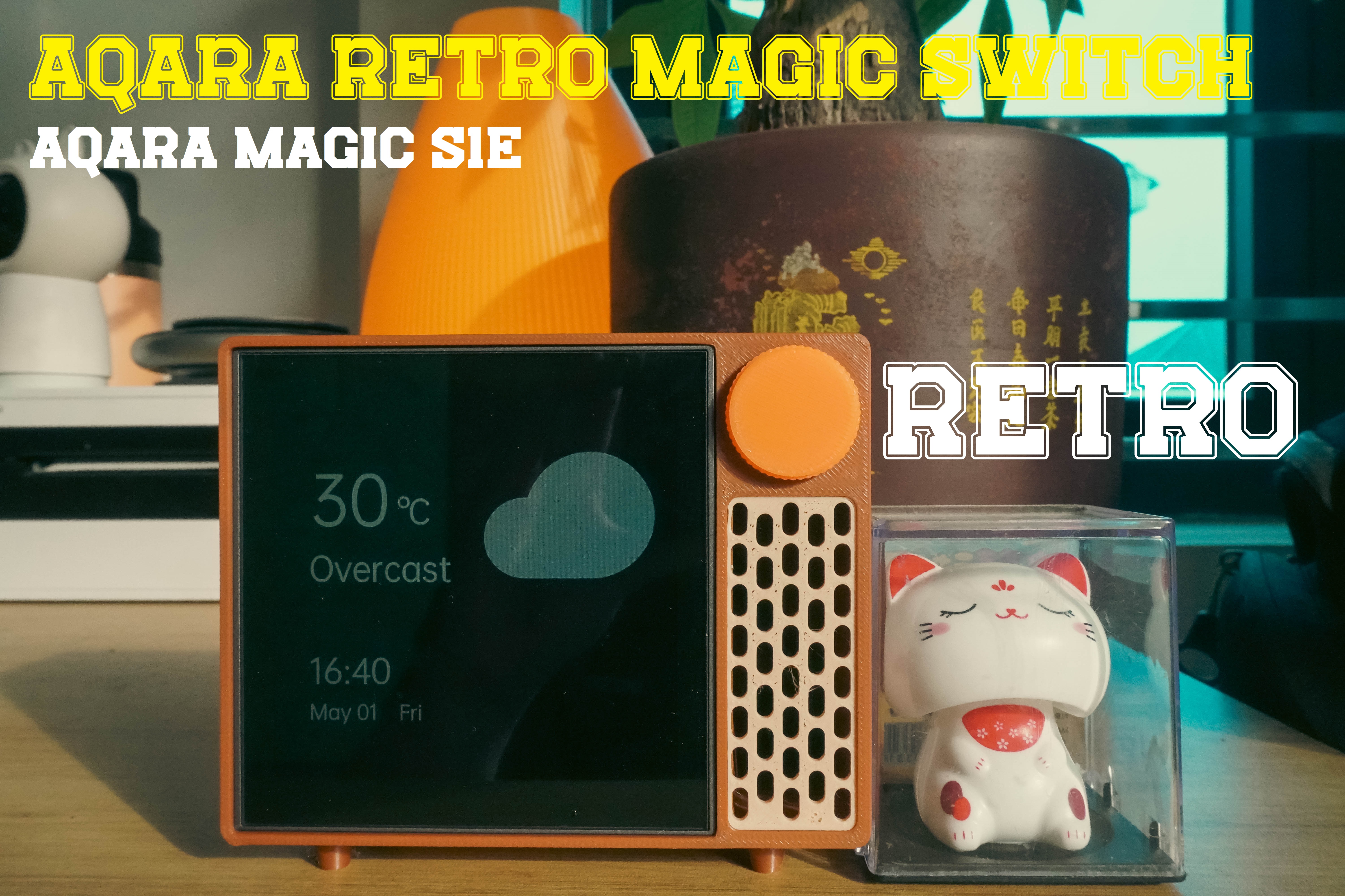

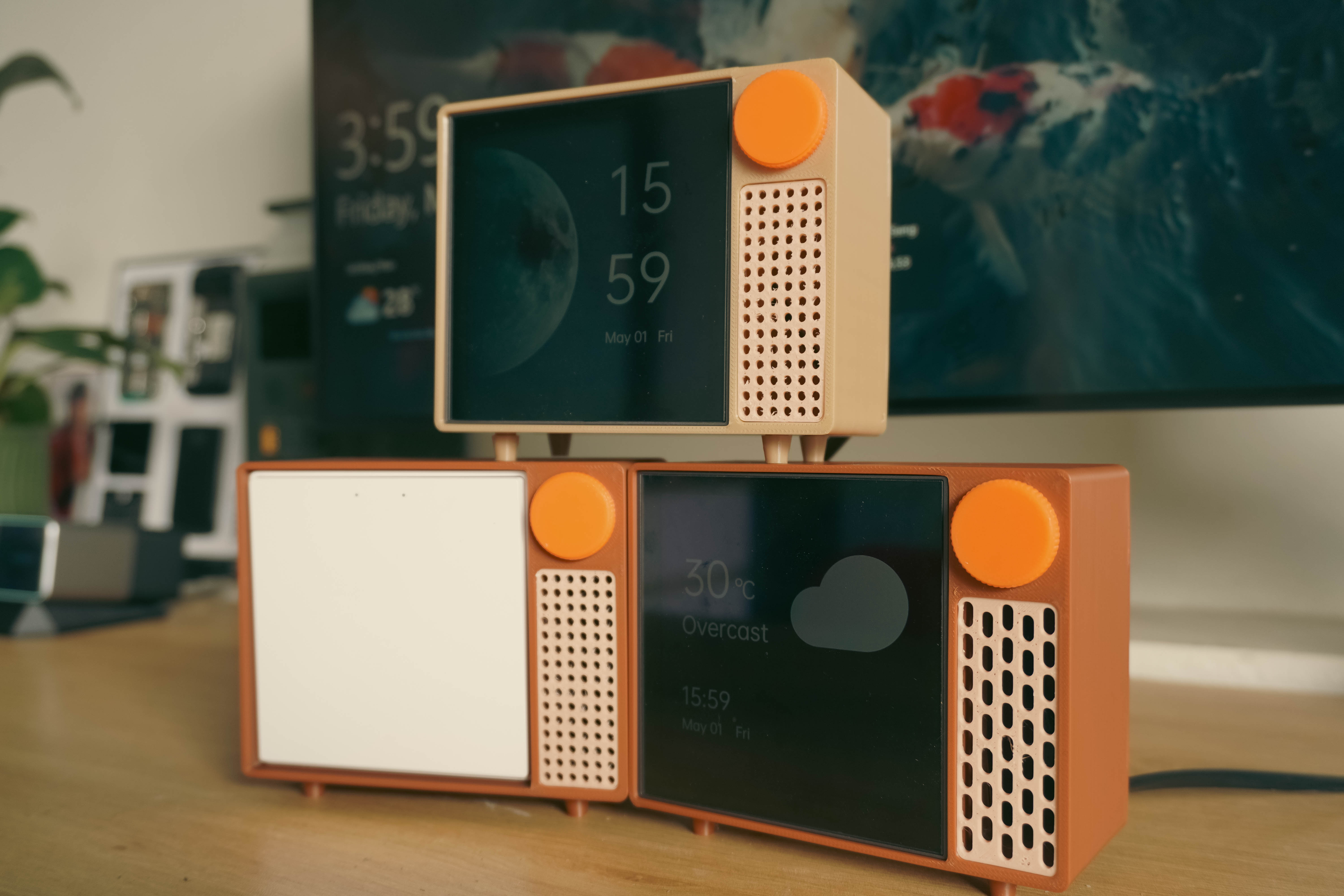

I DIY case, cover for Aqara device with Retro style. Do you like it?

BTW you mind share the link to the designs? Do you use a Bambu printer?
Ah , found it on makerworld - Mocin Studio :cowboy_hat_face::raised_hands:t4:

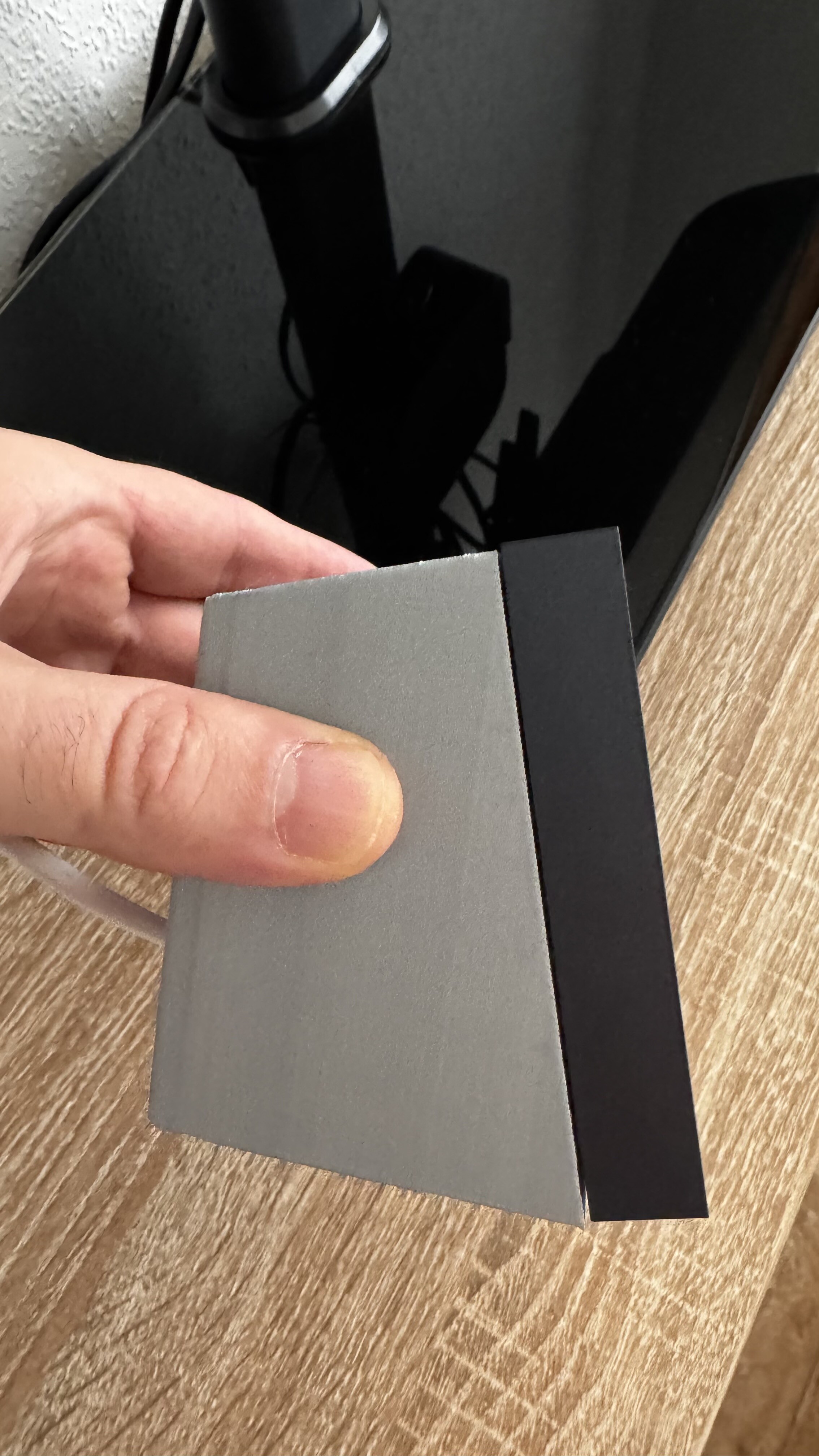

I just got today my desk stand for my Aqara air quality monitor panel S1 and fits well and looks great

Yes bro, there is free download
https://makerworld.com/models/2859338?appSharePlatform=copy

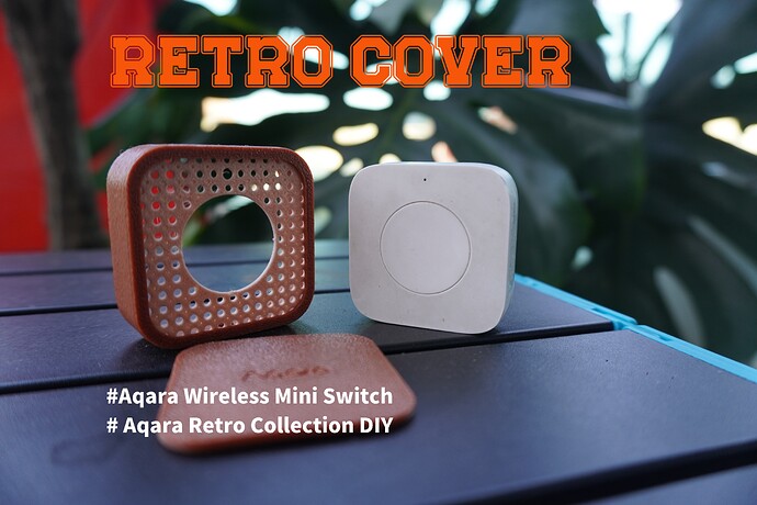

Yes bro, i’m DIY collection case for Aqara

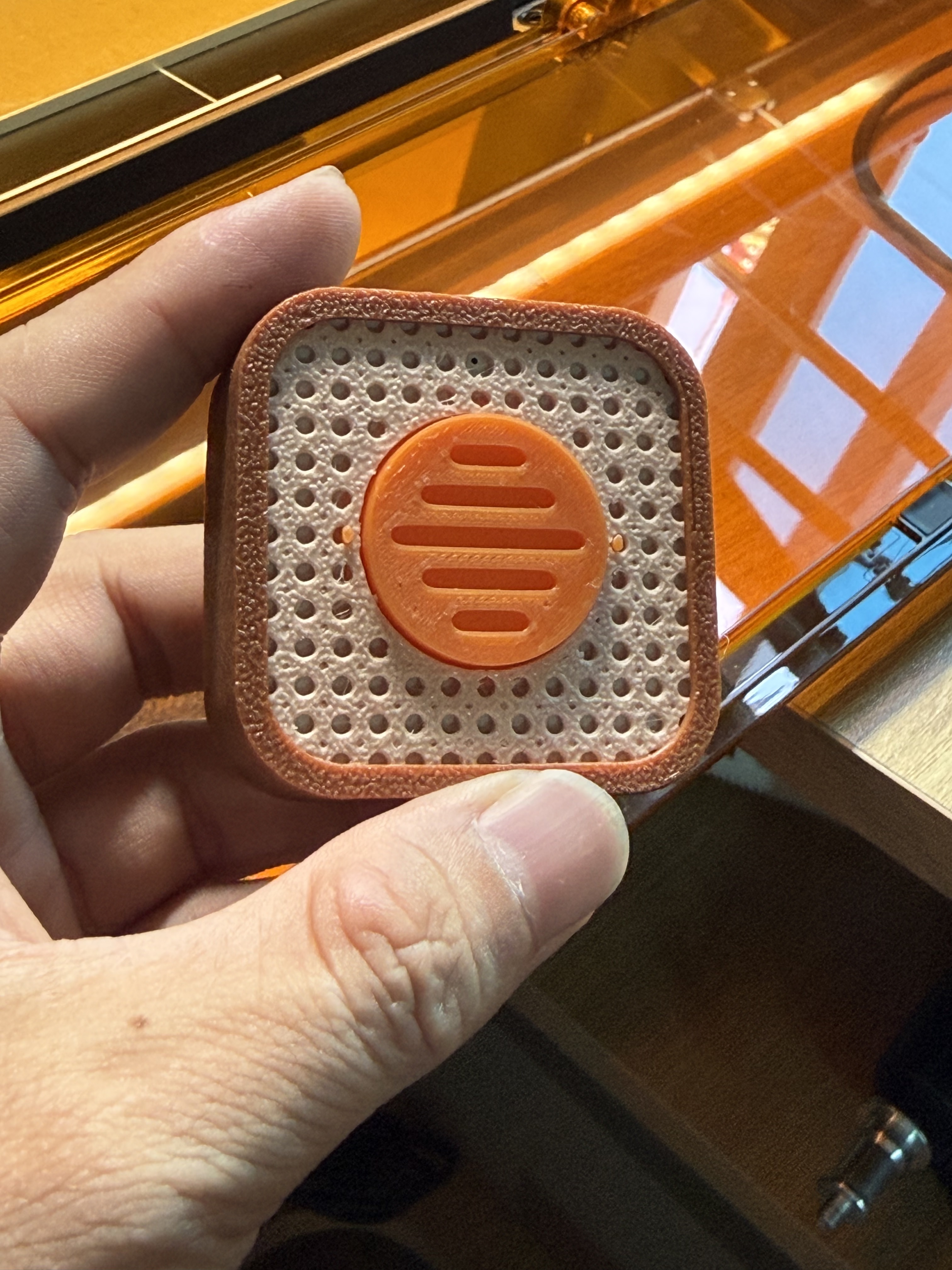

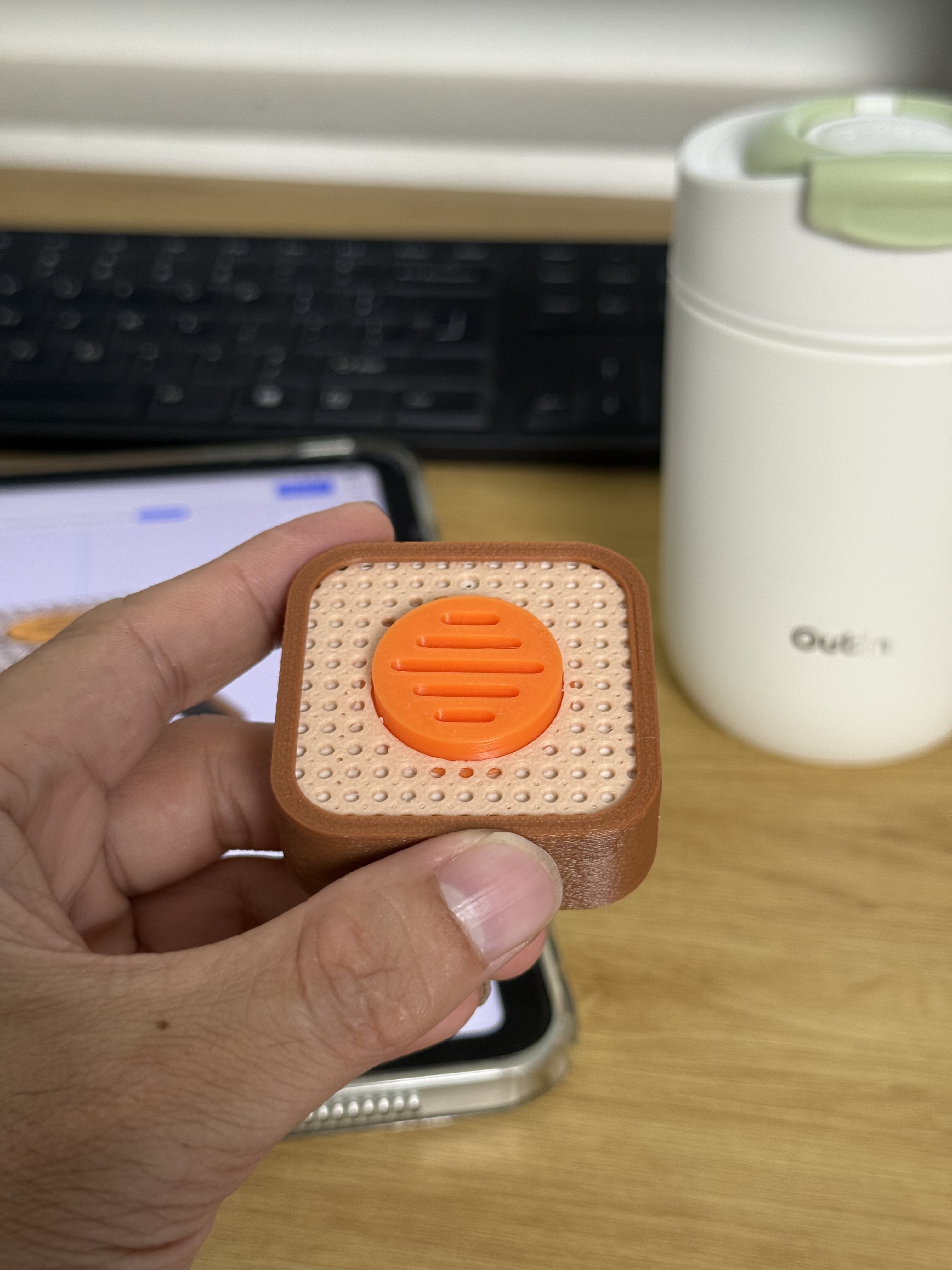

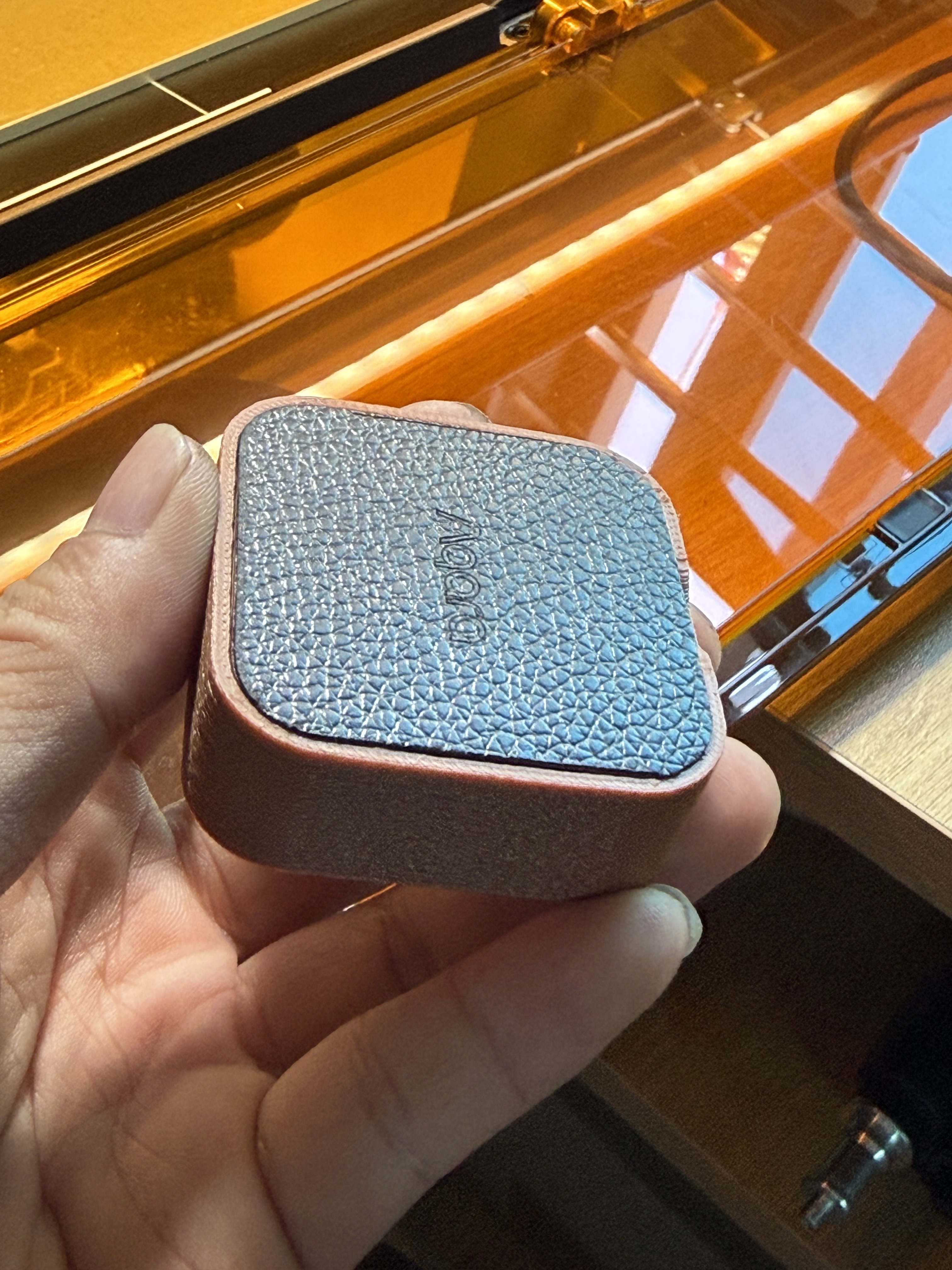

Update for retro button and leather bottom side

I’m not very familiar with this topic, so if you don’t mind, I’d like to ask a question. What hardware/device and software are you using to generate this output?

It’s a Bambu 3d printer
Where did you got the stand ? Is there a STL available @coccolino_26 ?

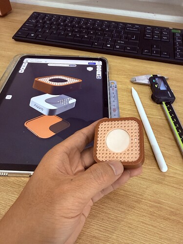

Thank for care it, i’m using software Shapr 3D (avaiable on Ipad, Windown, Mac OS) to design. After that, i’m use 3D printer (Bambu Lab) to build it.
Well I don’t remember were I got it but here I upload it to my Dropbox
https://www.dropbox.com/scl/fi/p5fkwkfuc16dn2hr9qabt/Aqara-20S1E-20Base.stl?rlkey=4myqmi2qlhbraqc16rifh2euf&st=xafb365f&dl=0

Aqara have dimension on catalog, otherwise you can use ruler to check. After that offset to 0.1 - 0.15mm for cover.
Ex: aqara magic s1e have dimension 86mm, so i design cover 86.1mm
And after somtime trial, you adjust dimension to fit
