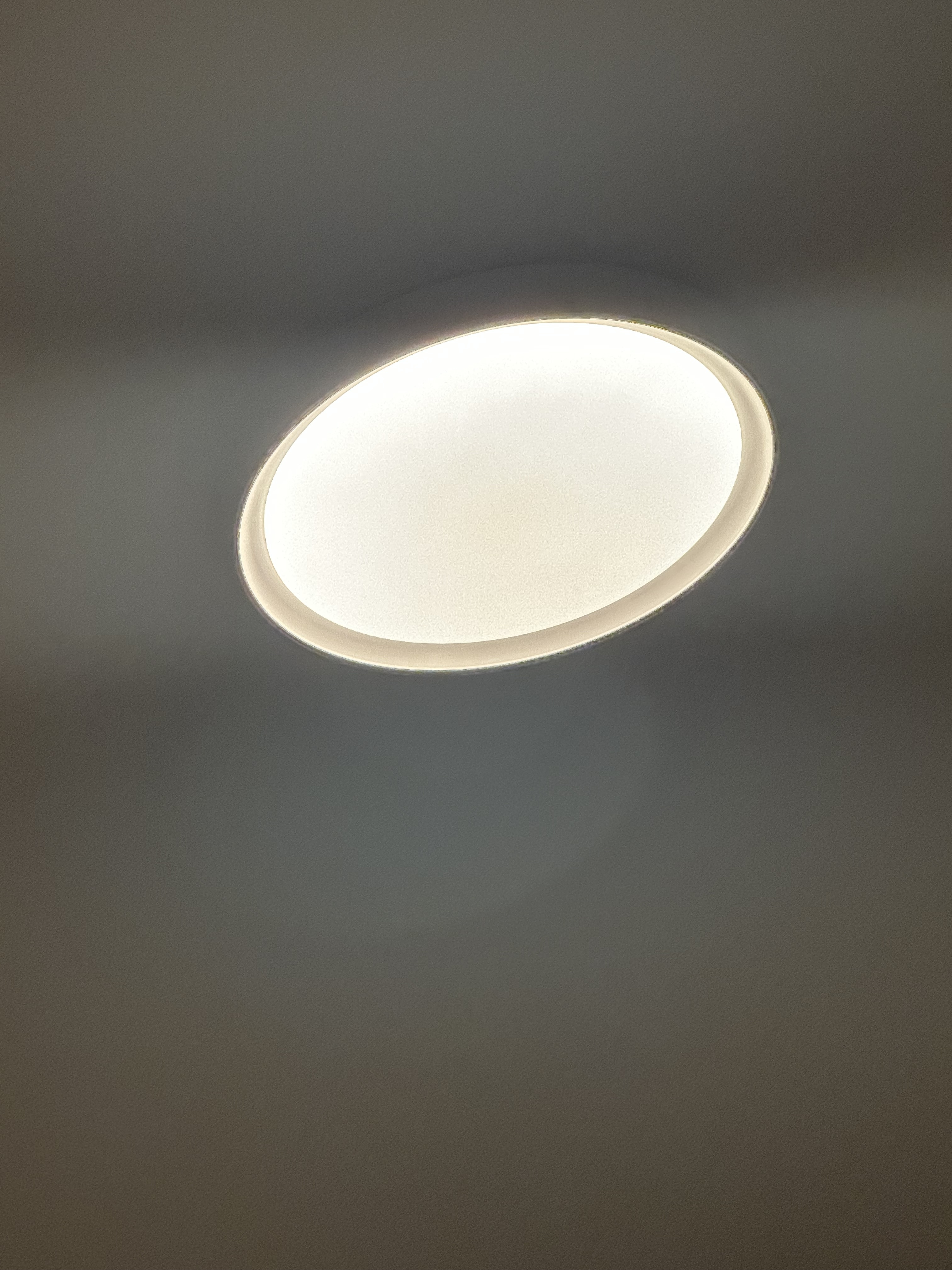

I’ve just installed the Aqara ceiling light T1M, but it seems that it doesn’t support ADAPTIVE LIGHTING.

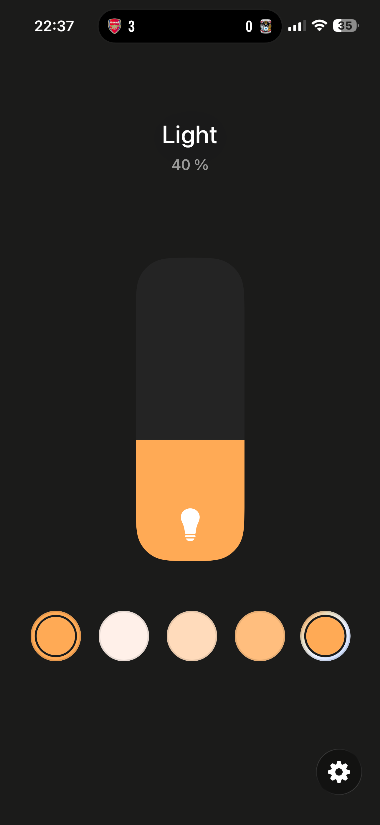

Attached screenshot of Apple home app and the light.
Mine has adaptive lighting for both lights. How do you have it connected in Apple Home - paired via a hub through which integration - HomeKit or Matter? FWIW I’m using Homekit which could be the difference.
I have it paired (Zigbee) with an M3 hub, which is connected to Apple Home via Matter. I can confirm it doesn’t have adaptive lighting when paired that way. My other lights (like T1 LED strip and T2 GU10 bulbs) do have adaptive lighting
Hi, that make sense, I’m using M3 hub via matter
Hello, same here M3 hub via matter
Connected by zigbee it has adaptive lighting
