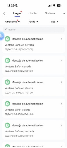

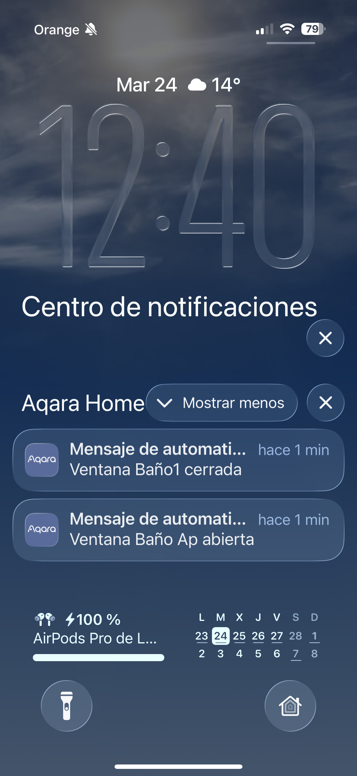

Gracias John…… I will do it!!!
John, I have tried it….but the notification dosent run properly….some times I get a notification open or closed but another time I dont recive any notification…!!!
