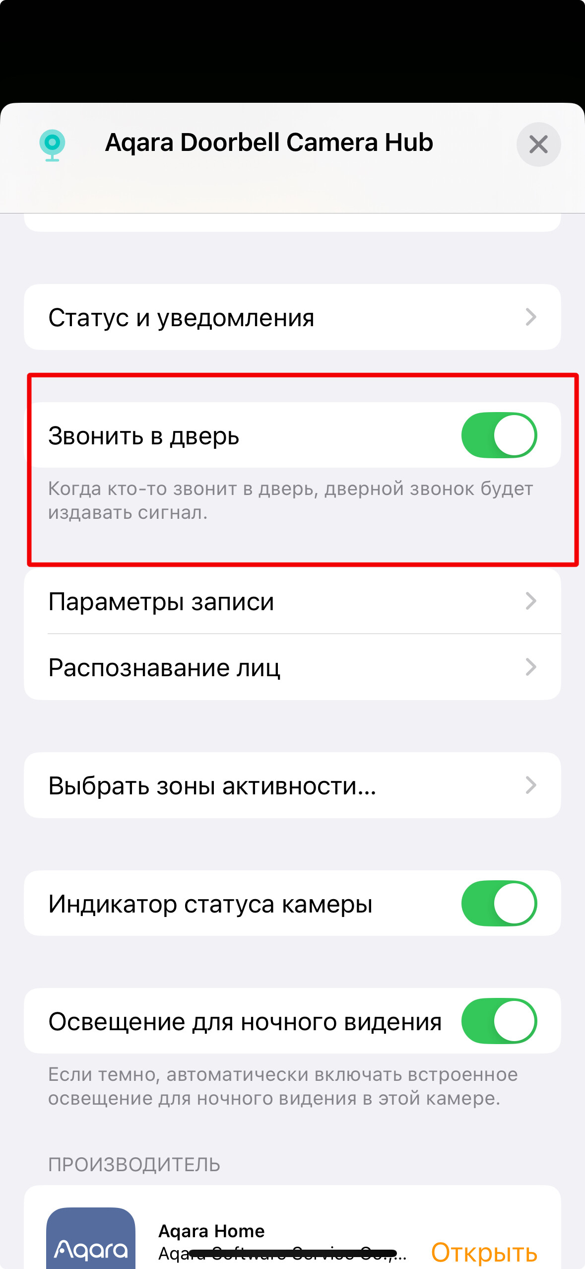

I just bought the Doorbell Camera Hub G410, according to the manual I should be able to connect it to my homepods, for the ringtone. I followed all the instructions, but nevertheless it’s not functioning! Please advise!
In homekit in the G410 settings, check if the doorbell option is enabled, if it is disabled, enable it and it should work.
When the button on the doorbell is pressed, your homepod will duplicate the call on your speaker.
