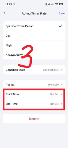

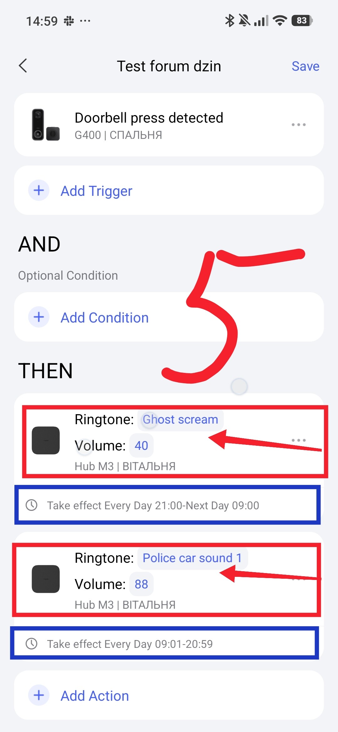

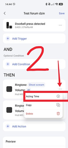

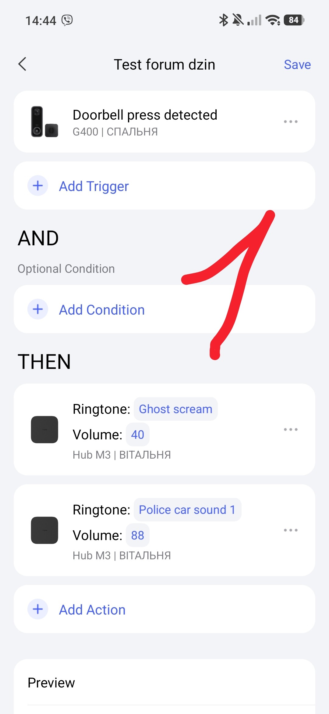

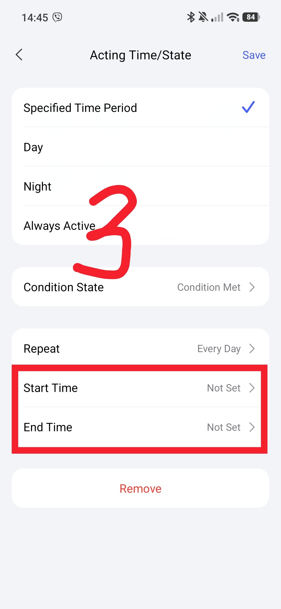

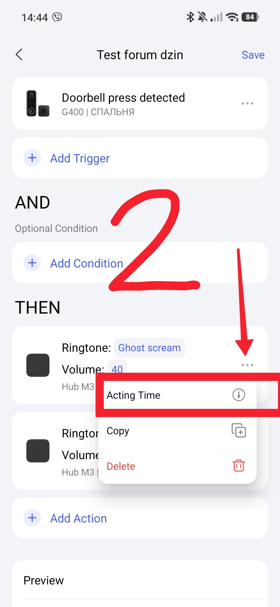

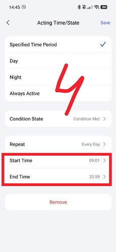

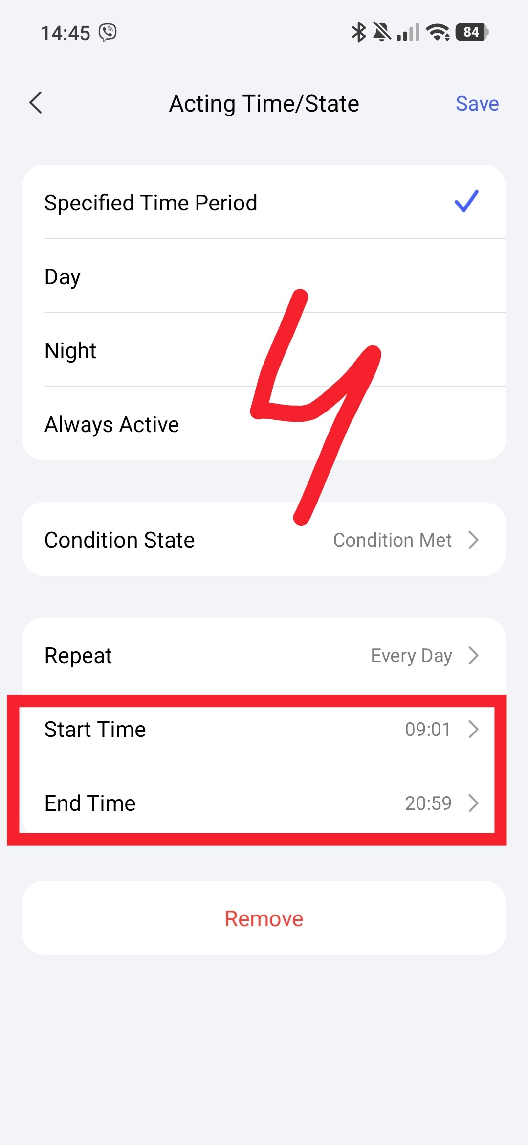

Hello, using automation and the M3 gateway, this is done like this.
Fig.
ATTENTION!
You can create as many playback periods as you want, the main thing when creating is that the times you choose do not overlap each other.

Perfect @gafich10 didn’t knew that you can set volume there ! Always eager to learn from you :sunglasses: :x2fozabcpx9xrbxmdpseb3_61:
